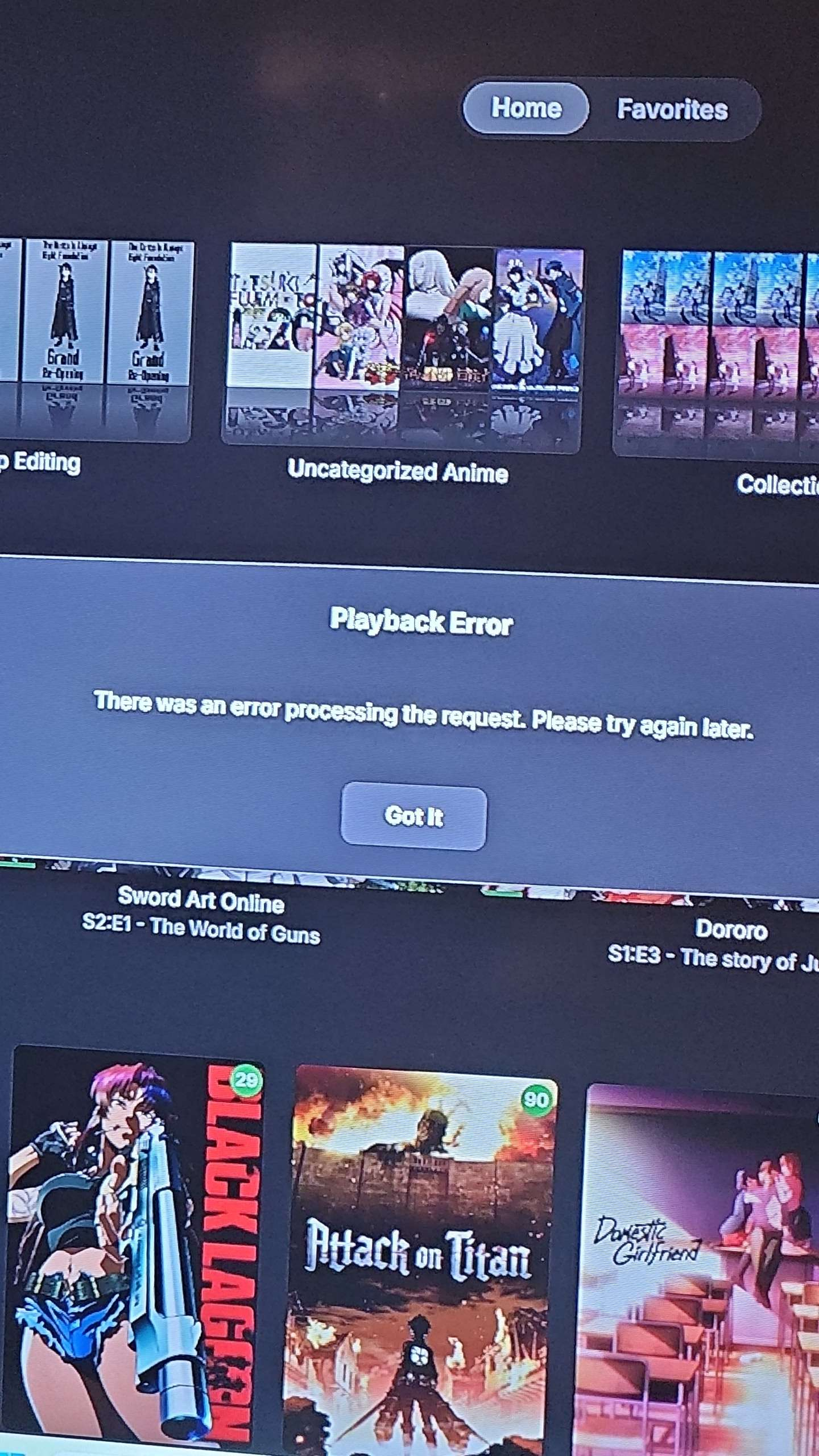

yikesezxd 3 Posted January 28 Posted January 28 I have Emby premiere, using the Emby App. Playback is perfect on smart tvs, computers, and mobile devices. But for some reason it seems if I have a windows device with an iGPU, playback is impossible. It just fails. At first, I thought it was an H.265 issue, but after downloading the extension from microsoft stored and verifying the hardware of the devices supported H.265 (they indeed did), I was still having the same problem. I tried to playback H.264 and no, I found out that NO playback works. So I'm a bit lost for words. I downloaded Emby diagnostics so I could test/temporarily force transcoding, and still no luck. I have no idea what the issue could be. The devices I'm testing them on are not old at all. They're pretty high end even (one of them I built). There's a laptop and a mini desktop, the only correlation I can draw is that they both have iGPU and are Windows devices. My Windows gaming PC with a dedicated GPU can use Emby flawlessly.

yikesezxd 3 Posted January 29 Author Posted January 29 embyserver (6).txtffmpeg-transcode-78d97ec1-2800-4c62-9716-0cb74b476f29_1.txt Here is the ffmpeg transcode log for the instance the client device in question attempted playback and the server log that proceeded it. I have also attached the error popup that the client gets.
yikesezxd 3 Posted January 29 Author Posted January 29 I know this isn't definitive, I always question AI as it tends to hallucinate more often than not, but while I was waiting for a response, I had AI take a look at the logs. It was able to identify a subtitle transcode issue of some kind, and so I came up with the idea of forcing subtitle burning in on the server side (via Emby Dianostics plugin) and that seemed to have fixed the issue for me. Take it with a grain of salt though, the reasoning it gave made me question the true cause of the problem, but regardless this will do for now. I would still like a more straightforward fix though, since Emby diagnostics settings do not persist beyond server Restarts.
Lessaj 486 Posted January 29 Posted January 29 The reason it's transcoding is due to a bitrate limit, is this a local device? It seems to think it's remote, so just checking. The file's bitrate is pretty high at 18.2 Mbit but it's being transcoded all the way down to I think a little over 700 Kbps at 640x362. Does this even need to be transcoded? The windows app should be able to direct play this.
yikesezxd 3 Posted January 29 Author Posted January 29 (edited) When I made the change of forcing subtitle burn in on the server side, things started working but I saw it was low res (720p) at a very low mbps. I then realized this setting specification was from a previous troubleshooting session, that I simply had forgotten to revert. Changing it to 1080p 60mbps, and even testing 4k 200mbps worked fine. I believe this only indicates that the resolution and what you described is unrelated to the playback issue. Simply I had the resolution/quality setting set that way client side and forgot to revert. Transcoding shouldn't be necessary from my understanding. The files I have contain a lot of complex ASS subtitle files, it seems that may be causing an issue in someway---- which is odd since other windows devices can process them fine. To be noted that the only windows devices ive tested with success have a dedicated GPU. Also yes, this is a local device. Edited January 29 by yikesezxd 1
