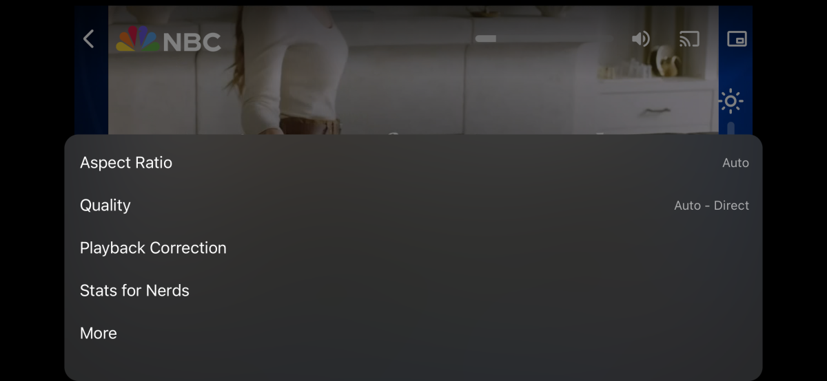

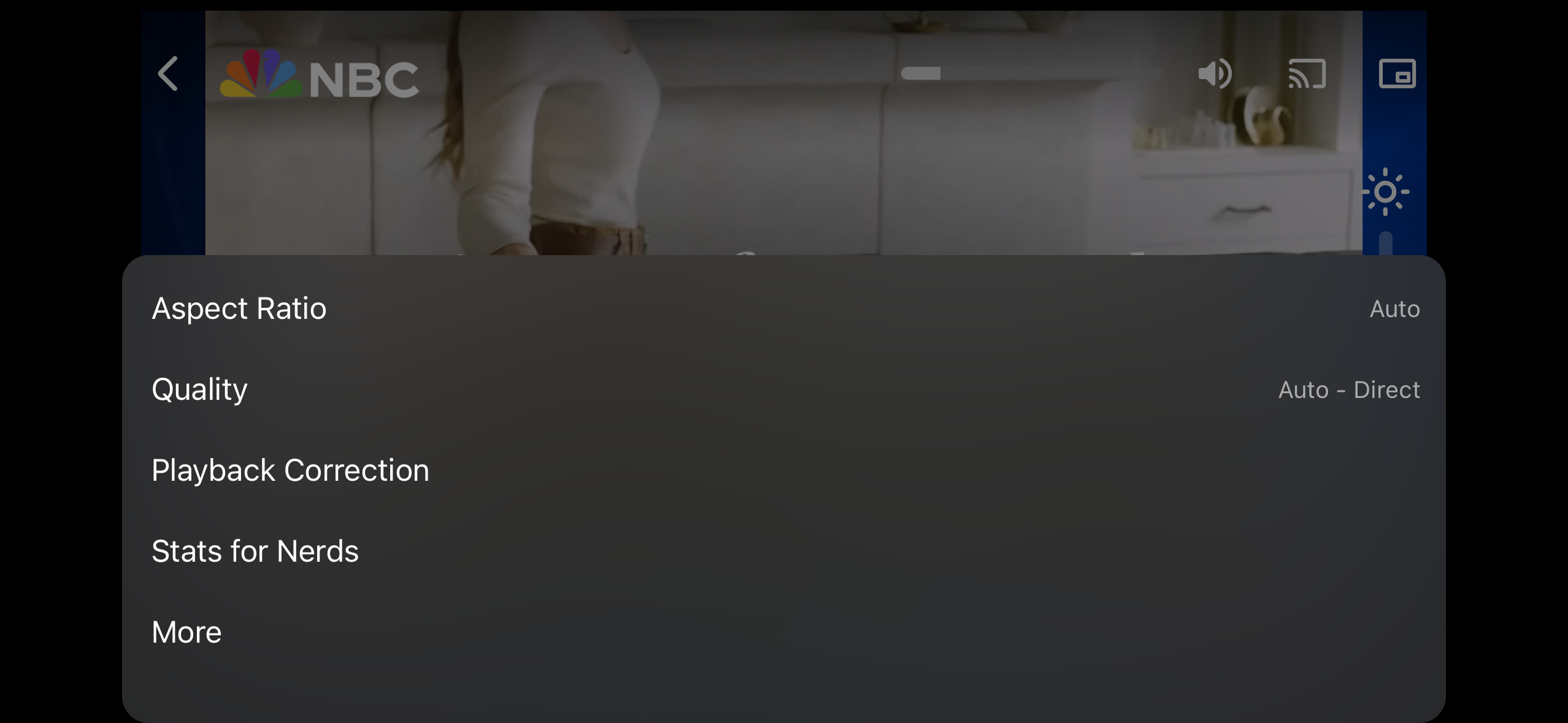

AaronC 2 Posted January 27 Author Posted January 27 OK. Here are two log files that should cover the time frame when I connected directly and through the cell network, and two screen shots showing direct connection (no transcode) and the remote connection (max 480p). embyserver.txt ffmpeg-transcode-c04ac1ee-b782-4ac9-9f4e-8b8991ea9ee1_1.txt

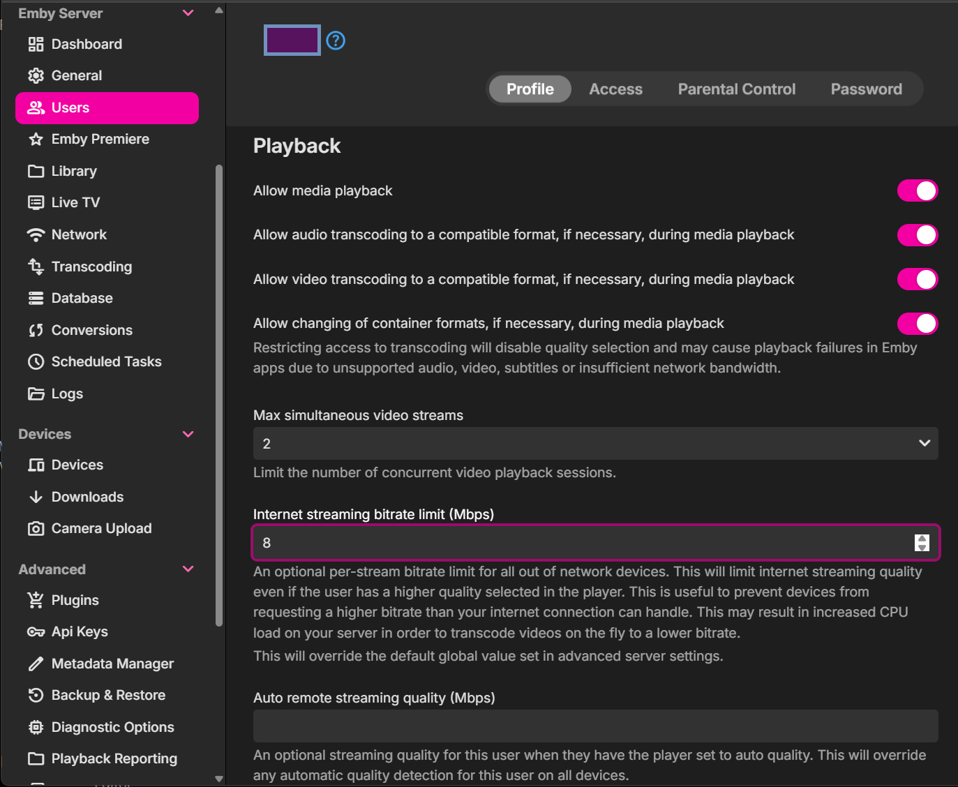

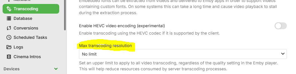

TMCsw 259 Posted January 30 Posted January 30 Can you also look at these settings? I mean all of them not just the one hilited...
AaronC 2 Posted January 30 Author Posted January 30 1 hour ago, Luke said: How have you configured the quality setting in the app that you’re playing from? Auto

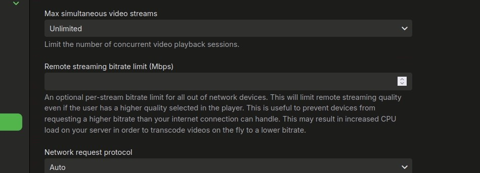

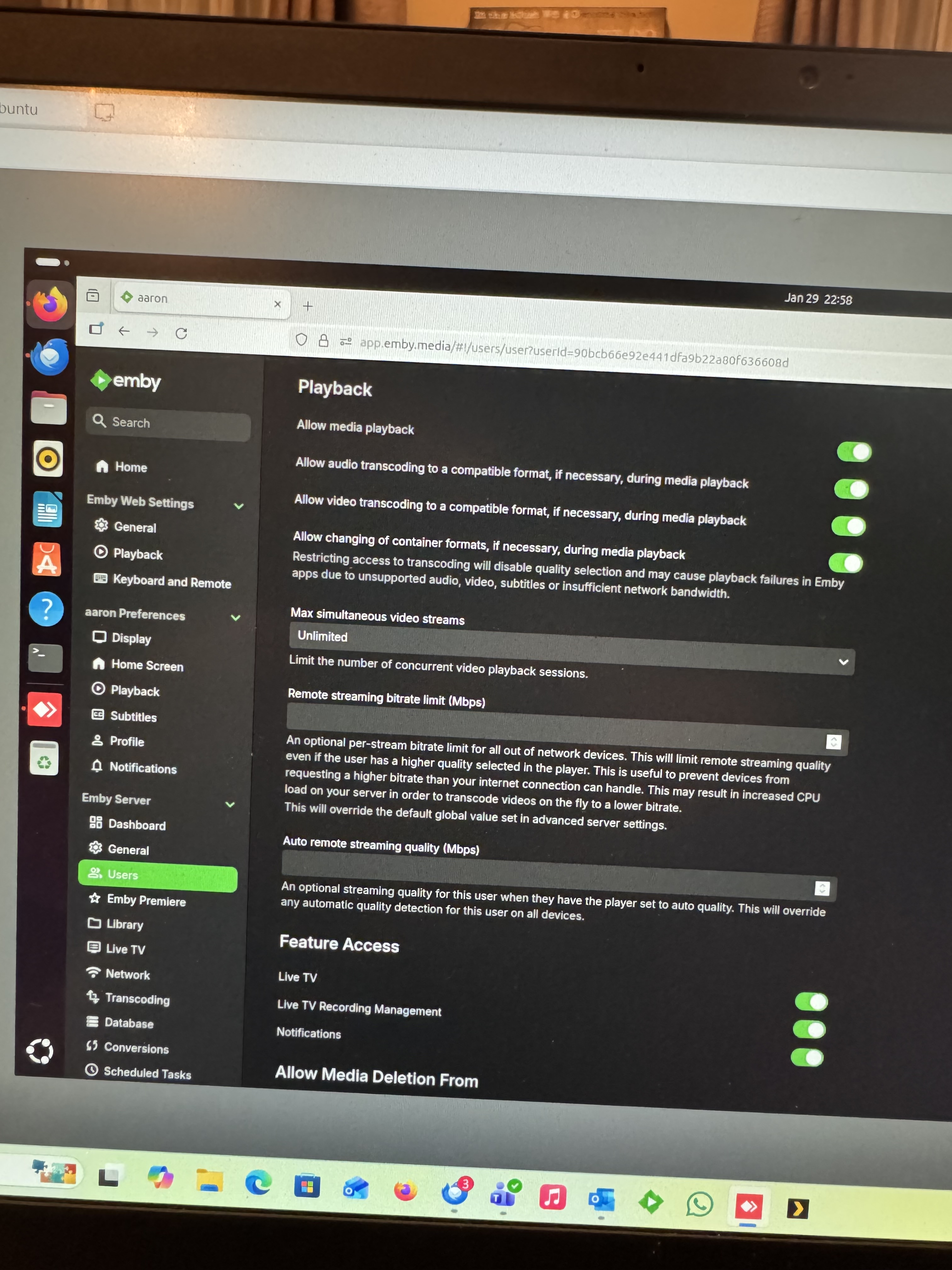

AaronC 2 Posted January 30 Author Posted January 30 57 minutes ago, TMCsw said: Can you also look at these settings? I mean all of them not just the one hilited...

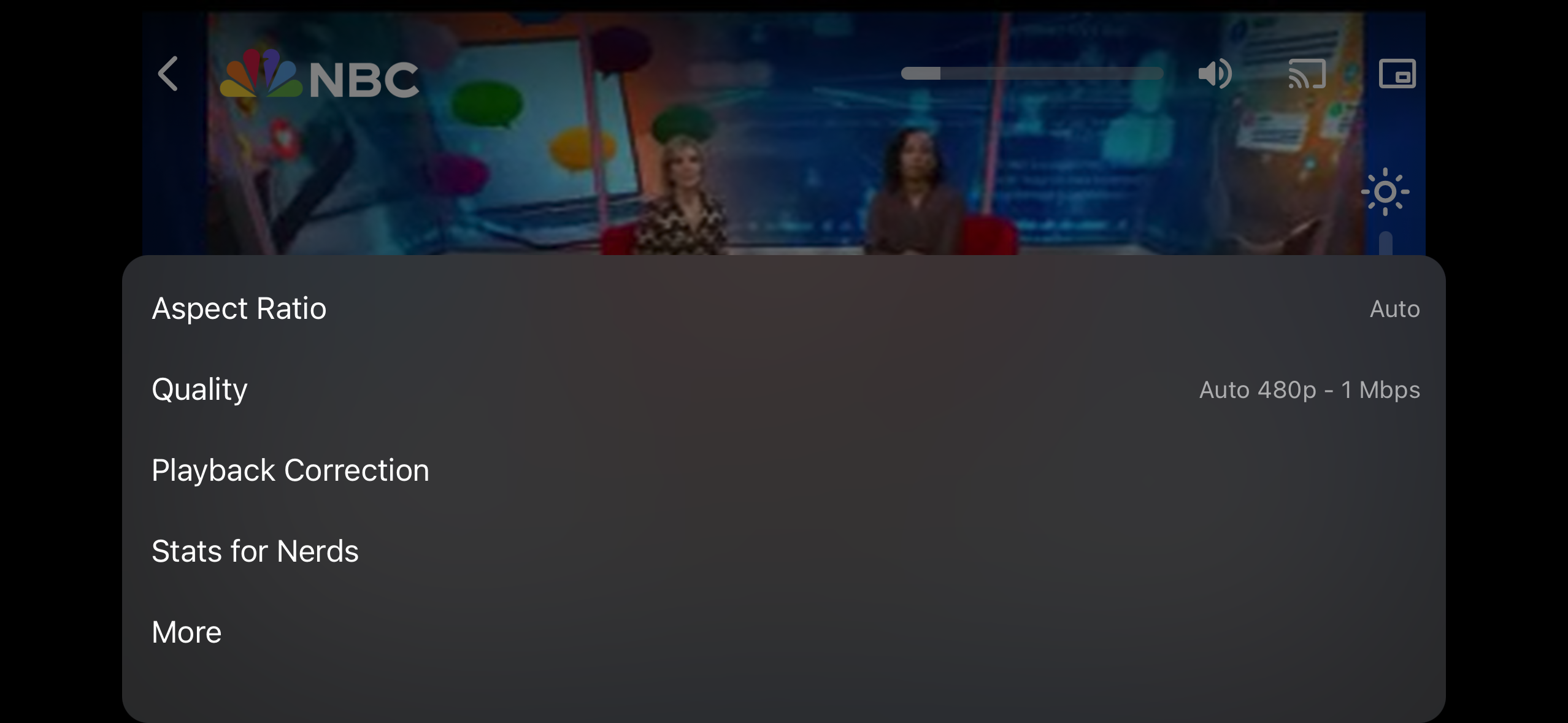

AaronC 2 Posted January 30 Author Posted January 30 37 minutes ago, Q-Droid said: Don't use Auto. On my iPhone the highest resolution available is 480p when connected to cellular data. 1080p shows up while connected to local lan. So the auto setting is at the max resolution available .

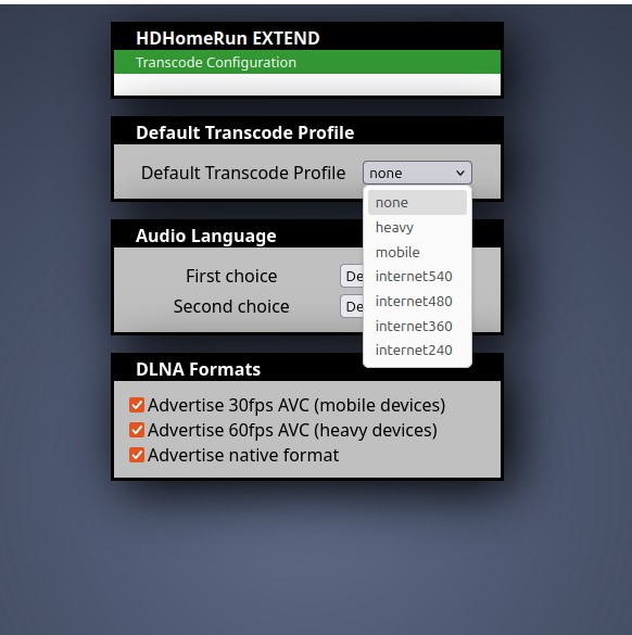

Q-Droid 1011 Posted January 30 Posted January 30 Pointing out a few things though I myself don't have the answers. It looks like the source stream is indeed changing between HD and SD though it may be how Emby interacts with the HDHR or the tuner doing it itself. From the server log: 2026-01-27 11:21:57.857 Info LiveTvManager: Opening channel stream, external channel Id: hdhr_4.1 2026-01-27 11:21:57.858 Info LiveTV: Streaming Channel hdhr_4.1, with streamId: heavy_dcae7ee91da8349d9a3089106668280d_65b32a817eafc731ab9c2a14685d0e7c Opens this stream: "DisplayTitle":"1080i H264" "Height":1080,"Width":1920,"AverageFrameRate":29.97003,"RealFrameRate":29.97003,"Profile":"High","Type":"Video","AspectRatio":"16:9" 2026-01-27 11:48:27.974 Info LiveTvManager: Opening channel stream, external channel Id: hdhr_6.1 2026-01-27 11:48:27.974 Info LiveTV: Streaming Channel hdhr_6.1, with streamId: internet240_e6a5ee655c7e0ae736a968d5b2efee79_65b32a817eafc731ab9c2a14685d0e7c Opens this stream: "DisplayTitle":"SD H264" "Height":240,"Width":352,"AverageFrameRate":29.97003,"RealFrameRate":29.97003,"Profile":"High","Type":"Video","AspectRatio":"16:9" 2026-01-27 11:50:15.125 Info LiveTvManager: Opening channel stream, external channel Id: hdhr_4.1 2026-01-27 11:50:15.125 Info LiveTV: Streaming Channel hdhr_4.1, with streamId: internet240_dcae7ee91da8349d9a3089106668280d_65b32a817eafc731ab9c2a14685d0e7c Opens this stream: "DisplayTitle":"SD H264" "Height":240,"Width":352,"AverageFrameRate":29.97003,"RealFrameRate":29.97003,"Profile":"High","Type":"Video","AspectRatio":"16:9" 2026-01-27 12:30:22.528 Info LiveTvManager: Opening channel stream, external channel Id: hdhr_6.1 2026-01-27 12:30:22.528 Info LiveTV: Streaming Channel hdhr_6.1, with streamId: heavy_e6a5ee655c7e0ae736a968d5b2efee79_65b32a817eafc731ab9c2a14685d0e7c Opens this stream: "DisplayTitle":"720p H264" "Height":720,"Width":1280,"AverageFrameRate":59.94006,"RealFrameRate":59.94006,"Profile":"High","Type":"Video","AspectRatio":"16:9" 2026-01-27 14:13:20.041 Info LiveTvManager: Opening channel stream, external channel Id: hdhr_4.1 2026-01-27 14:13:20.041 Info LiveTV: Streaming Channel hdhr_4.1, with streamId: heavy_dcae7ee91da8349d9a3089106668280d_65b32a817eafc731ab9c2a14685d0e7c Opens this stream: "DisplayTitle":"1080i H264" "Height":1080,"Width":1920,"AverageFrameRate":29.97003,"RealFrameRate":29.97003,"Profile":"High","Type":"Video","AspectRatio":"16:9" 2026-01-27 14:14:12.270 Info LiveTvManager: Opening channel stream, external channel Id: hdhr_4.1 2026-01-27 14:14:12.270 Info LiveTV: Streaming Channel hdhr_4.1, with streamId: internet240_dcae7ee91da8349d9a3089106668280d_65b32a817eafc731ab9c2a14685d0e7c Opens this stream: "DisplayTitle":"SD H264" "Height":240,"Width":352,"AverageFrameRate":29.97003,"RealFrameRate":29.97003,"Profile":"High","Type":"Video","AspectRatio":"16:9"
Solution AaronC 2 Posted January 30 Author Solution Posted January 30 I appreciate everyone trying to help out with this! It appears that the only way to fix this is to disable the transcode function in the HDHomerun. See attached. I had it set to "heavy" by default which seemed to work with Plex but didn't with Emby. (I just didn't see a need for a full bandwidth MPEG-2 ATSC stream, so I thought it was better to have the Extend transcode. But by setting the HDHomerun to "none" then Emby will stream TV channels in 720p/1080i. Thanks for your help everyone! 1 1
