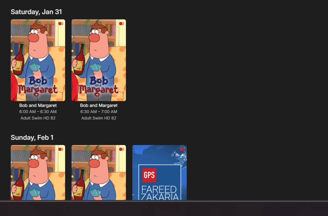

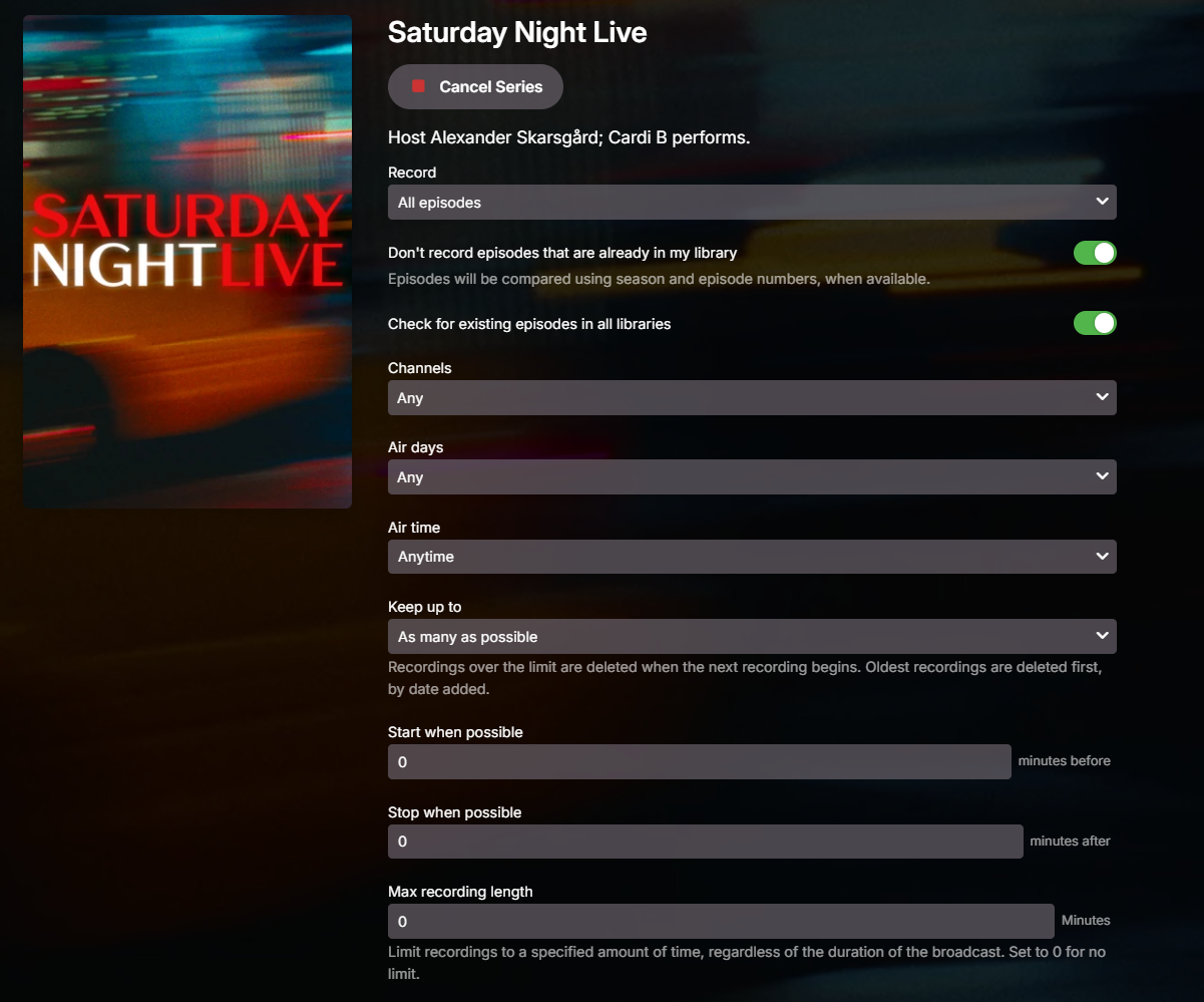

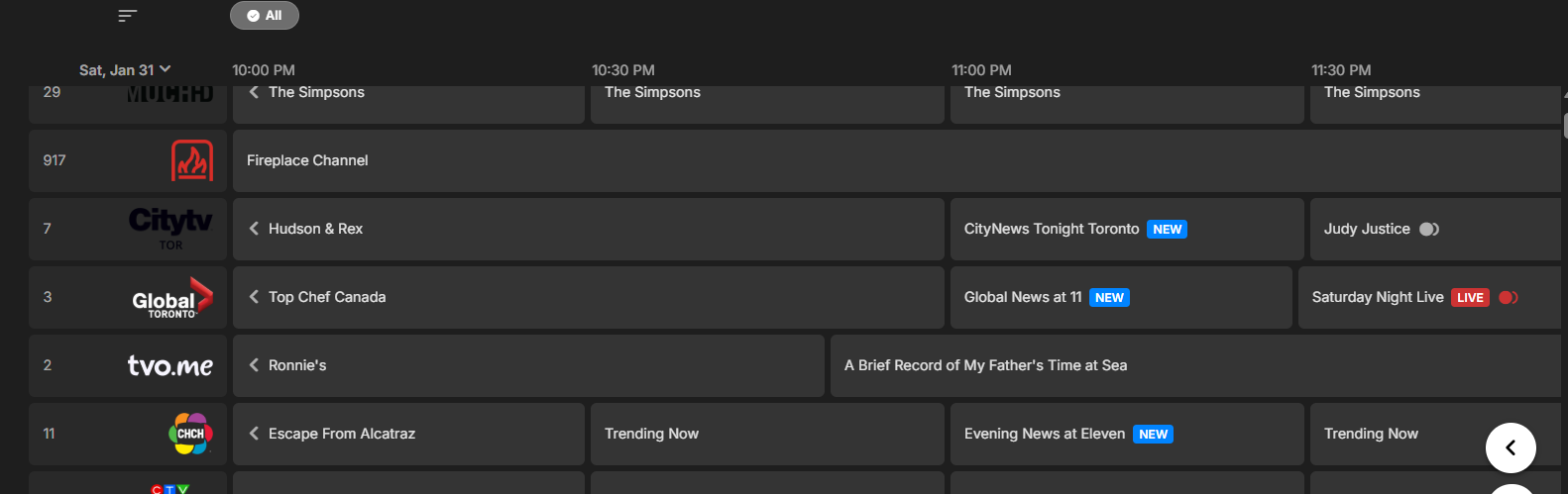

jasonwilliams 37 Posted January 27 Posted January 27 Hello, For the past few months, my series recording of SNL hasn't been working. The series is set up to record at any time on any channel, and I see SNL in the guide, but it doesn't show in "Scheduled". It does show the recording symbol in the guide, but it never records. All of my other recordings are working fine. I've tried refreshing the guide, deleting and recreating the series recording, but to no avail. Here is the scheduled: And here it is in the guide: Any help is appreciated!
sa2000 696 Posted January 27 Posted January 27 (edited) Lets have a look at some logs - see How to Report a Problem I would suggest enabling debug logging on the server, See Log Files and then restart the emby server to get fresh logs, run a guide refresh, and after completing the refresh, wait for a few minutes and then download the embyserver log and attach here Could you also get a screenshot of what is already in the emby libraries for Saturday Night Live - folder/subfolders/recordings - or directory listing And for me to check the guide data, what guide data identifier is in use (can be seen in Settings / Live TV / Setup) and what channel number/channel name has the broadcats Update: The log as outlined above will show if it is scheduled For not having a recording take place, see post by Luke below Edited January 27 by sa2000
Luke 42239 Posted January 27 Posted January 27 Hi there, please attach the Emby server log from when the problem occurred: How to Report a Problem Thanks!
RanmaCanada 502 Posted January 27 Posted January 27 Does it have a broadcast flag that disables recording?
