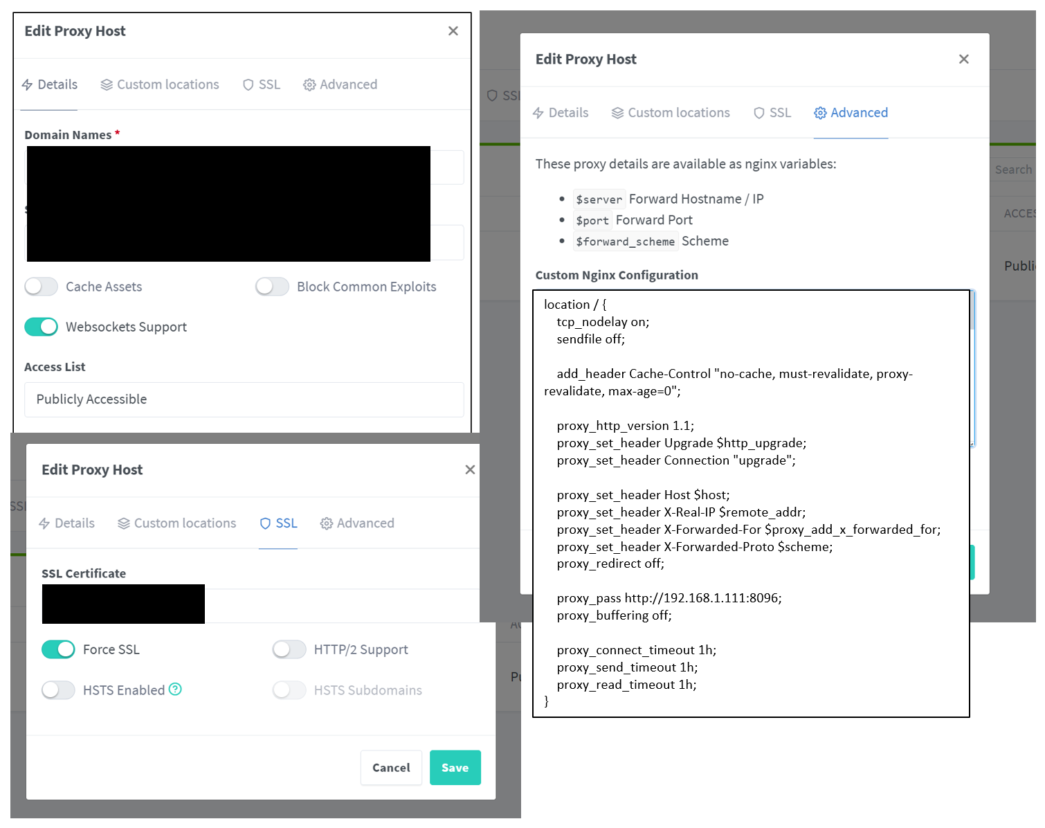

privaty 4 Posted February 3 Author Posted February 3 (edited) @LukeI've tried everything in NPM (on/off/advanced) , but I can only see locally when I log in or via the web browser. However, when users log in via LG TV Emby (Android 3.5.28, Emby for LG 1.0.50), I can't see it. With this settings, I can at least see when the user has started and finished a video, but nothing more. Before the update, I could see how users authenticated themselves. With these settings, I can at least see that they have started and finished a video. Do you have a better idea, or should we wait for the new update? Setting Status Websockets Support ON Block Common Exploits OFF HTTP/2 Support OFF Setting Status Force SSL ON HSTS Enabled OFF HTTP/2 Support OFF HSTS Subdomains OFF Edited February 3 by privaty translate
privaty 4 Posted February 4 Author Posted February 4 @LukeYes, I tried it too. Much of it is unnecessary. For example, Gzip is enabled by default, but it does not affect login activities. I added a few, but it doesn't matter. I can only see the user's activities when they start and finish a movie, but I can't see the login authentication where you can also see the IP address of the login. Before the update, I had few settings and it worked. It's only since the update that the real-time activities no longer work when a user logs into the server. I have now fine-tuned the most important ones, but nothing is the way it was before: location / { tcp_nodelay on; sendfile off; proxy_buffering off; proxy_connect_timeout 1h; proxy_send_timeout 1h; proxy_read_timeout 1h; proxy_set_header Range $http_range; proxy_set_header If-Range $http_if_range; proxy_hide_header X-Powered-By; proxy_http_version 1.1; proxy_set_header Upgrade $http_upgrade; proxy_set_header Connection "upgrade"; proxy_set_header Host $host; proxy_set_header X-Real-IP $remote_addr; proxy_set_header X-Forwarded-For $proxy_add_x_forwarded_for; proxy_set_header X-Forwarded-Proto $scheme; proxy_redirect off; add_header 'Referrer-Policy' 'origin-when-cross-origin'; add_header X-Frame-Options "SAMEORIGIN" always; add_header X-Content-Type-Options "nosniff" always; add_header X-XSS-Protection "1; mode=block" always; proxy_pass http://192.168.1.111:8096; }
Solution Luke 42171 Posted February 4 Solution Posted February 4 Maybe your proxy is configured correctly. Did they actually login and authenticate? That's when you would see that activity. If they authenticated in the past and they're just returning to that previous session, then you won't see it. 1
privaty 4 Posted February 4 Author Posted February 4 @LukeAh, if they have authenticated in the past, it will no longer be displayed . Thank you guys, but even so, these additional settings certainly provide greater stability and security.
Luke 42171 Posted February 4 Posted February 4 1 hour ago, privaty said: @LukeAh, if they have authenticated in the past, it will no longer be displayed . Thank you guys, but even so, these additional settings certainly provide greater stability and security. If they logout then they will have to reauthenticate and you will see it again. So yes this was changed although it didn't happen recently. I'm pretty sure it's been a couple years since we did that. The problem before is that it was just filling the activity log needlessly every time restart an app, load a new browser tab, etc. 1
privaty 4 Posted February 4 Author Posted February 4 @LukeIt makes sense not to overload the activity log unnecessarily 1
