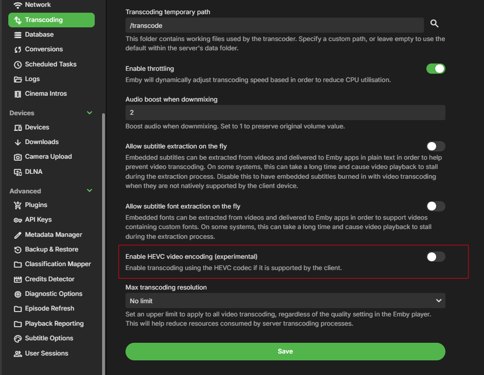

Flofian 3 Posted January 26 Posted January 26 I had the option "Enable HEVC video encoding (experimental)" on, which did work, it used HEVC when transcoding for my android phone, and I have the option "Enable hardware acceleration when available" set to yes with no custom settings for any of the encoders. However, it seemed to only use CPU when transcoding to hevc, and i saw the ffmpeg task with "-c:v libx265" in the arguments. But looking at the logs, it seems to try it with hardware acceleration first, and sometimes works? I attached 3 logs, all are for transcoding the same file. embylog01.txt embylog02.txt embylog03.txt

Flofian 3 Posted January 27 Author Posted January 27 Thank you so much. I guess there is nothing i can do about that? I understand that it makes sense for it to behave like it currently does, but since the server runs on my personal machine, it would be better (for me) if it tried to use h264 on my gpu before it switches to cpu, especially since i dont think i ever had problems wihth h264 on my gpu. I would love it if there was an option for deciding the order.
Neminem 1591 Posted January 27 Posted January 27 43 minutes ago, Flofian said: if it tried to use h264 on my gpu before it switches to cpu Yes try without HEVC encoding, to get the old h264 encoding
