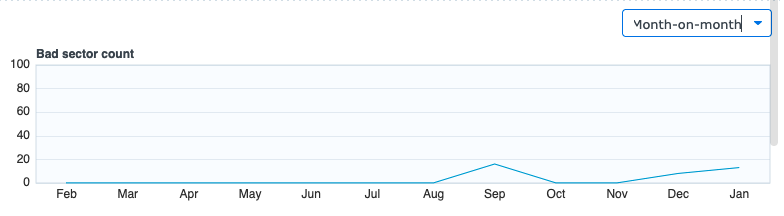

Solution corey 317 Posted January 28 Author Solution Posted January 28 So I have an update. Ultimately I don't think this is an Emby issue but I figured I'd share the result of my research for others and maybe folks can provide some guidance here. I ran an experiment: Turned on Detect Intros Added a bunch of new media The result: Detection worked without a hitch. When looking at disk utilization from the NAS I observed the following: All drives except Drive 1 report 30-40% utilization. Drive 1 was at 85-95% utilization. When I ran the scan scheduled task again, it is hanging on the same episode as before. When looking at disk IOPS, Throughput, and Utilization from the NAS I observed the following: All drives except Drive 1 report zero utilization. Drive 1 is maxed at 100% utilization. All drives report zero throughput and zero IOPS. So there definitely seems to be something off with how this file is stored and accessed on the NAS. When attempting to move the file off my NAS I saw max utilization for that drive again. I deleted the file and put a fresh version on. Ran a scan and it worked without an issue. I did run SMART tests on all drives and they reported healthy. I do think I need to look at replacing this drive specifically. This all but confirms it: 1
