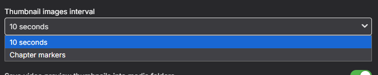

toooo 8 Posted January 25 Posted January 25 I have had several movie and episode files that contain very few and/or long chapters. For example, a file with 2 chapters, one of which is nearly the full length of the media. I suggest an improvement to chapter thumbnail generation - where we can set a minimum and maximum chapter length. Example use cases: File has few (long) chapters File has many (short) chapters Fix Option 1: Definition of LONG or SHORT comes from a custom configuration. If the average chapter length in a media file falls outside of this duration range, consider the file to NOT contain useful chapters, thus apply the already available "Thumbnail images interval" that is already set for the relevant library. Fix Option 2 (simpler): Configure a maximum chapter length. If a chapter is longer than the maximum (or the average chapter length in a file), have the media file use the "Thumbnail images interval" that is already set for the relevant library. Thanks
Luke 42243 Posted January 26 Posted January 26 Hi, are you saying you want to ignore the chapters in your own files?
brothom 211 Posted January 26 Posted January 26 I'd look to hook into this as well by requesting "5 seconds" as an option in the thumbnail generation dropdown: 10 seconds is can sometimes be too much (rounding during scrolling as describe under OP's "Fix Option 1:") and can show an image that's at the start of the current seek time chunk, causing an overshoot when seeking. It's not a breaking issue but would definitely be an addition to QoL.
toooo 8 Posted January 26 Author Posted January 26 7 hours ago, Luke said: Hi, are you saying you want to ignore the chapters in your own files? Yes. Some media has completely useless chapter markers (thus thumbnails). I would like to have more interval options, as well. For example, I don't need to clog my server with tons of thumbnails, and would prefer just having every few (5) minutes (every couple of scenes). I only use the thumbnails to do quick validation of file quality/correctness without having to play and skip through the video. 1
