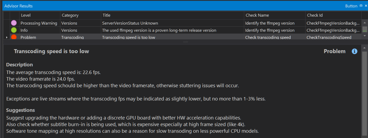

moviesandtv56 8 Posted January 24 Posted January 24 Movies play and then the spinning % circle, starffmpeg-transcode-911b90f5-25fe-4287-9b90-a589802c49d4_1.txtts at 33% or so, then goes back to 100%, movie plays for a bit, then goes back to spinning circle. Roku app is version 4.1, build 54, tried to up date that, said it was up to date. Server version is 4.8.11.0, says that's up to date. Let me know if anything else is needed. Thanks for the help.
Luke 42234 Posted January 24 Posted January 24 Hi, are you sure that model can handle this transcoding? You probably want to format your files appropriately to maximize direct playing as much as you can.
moviesandtv56 8 Posted January 24 Author Posted January 24 I've been playing these same files with Emby on the same server for years. Never had an issue and then the last few months this started to happen. Same thing use to happen all the time with Plex when they started to support streaming more than playing movies from your server.
TMCsw 259 Posted January 25 Posted January 25 (edited) 2 hours ago, moviesandtv56 said: I've been playing these same files with Emby on the same server for years. Ya, but updates to the OS and apps evolve and generally slow down things because they do more. Bui, maybe there are ways to improve this, so try this: Remove plugins that you really don't need from Emby Update the NAS firmware/software Reboot the NAS Wait ~5 min, then try to play a video you have had problems with After a problem occurs, post here all the logs Emby creates during this time Or try: https://github.com/MediaBrowser/Emby.Releases/releases/tag/4.9.3.0 Edited January 25 by TMCsw
