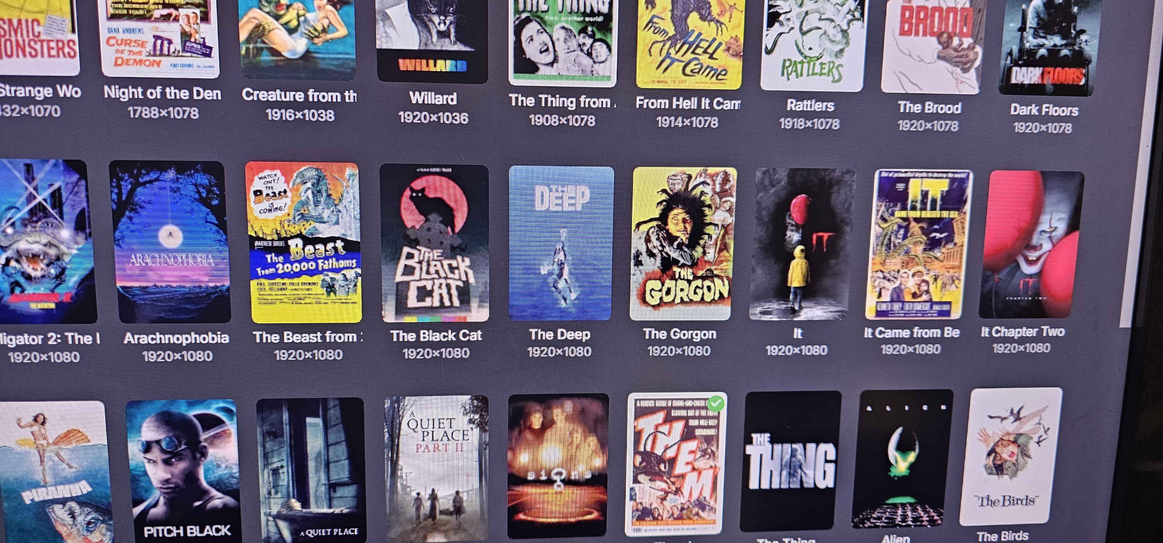

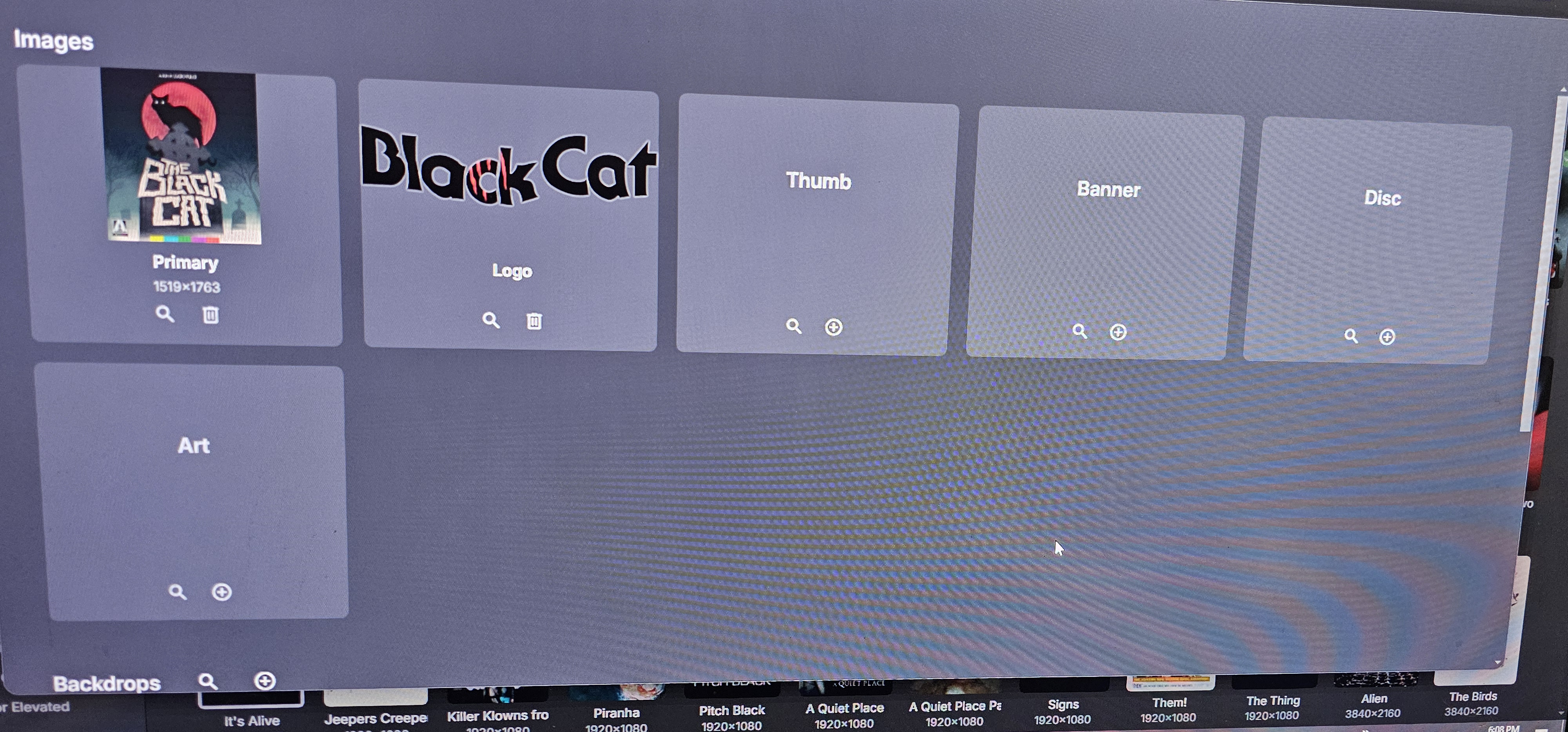

gogginguy 4 Posted January 23 Posted January 23 Emby Linux 4.9.3.0. Here are two screenshots. Before scanning for new media and after. There should be a way of disabling metadata (poster) changes at the library level for already identified movies. (and "Lock this item..." doesn't stop it either.) This undoes a LOT of time manually changing these posters. Thanks in advance.

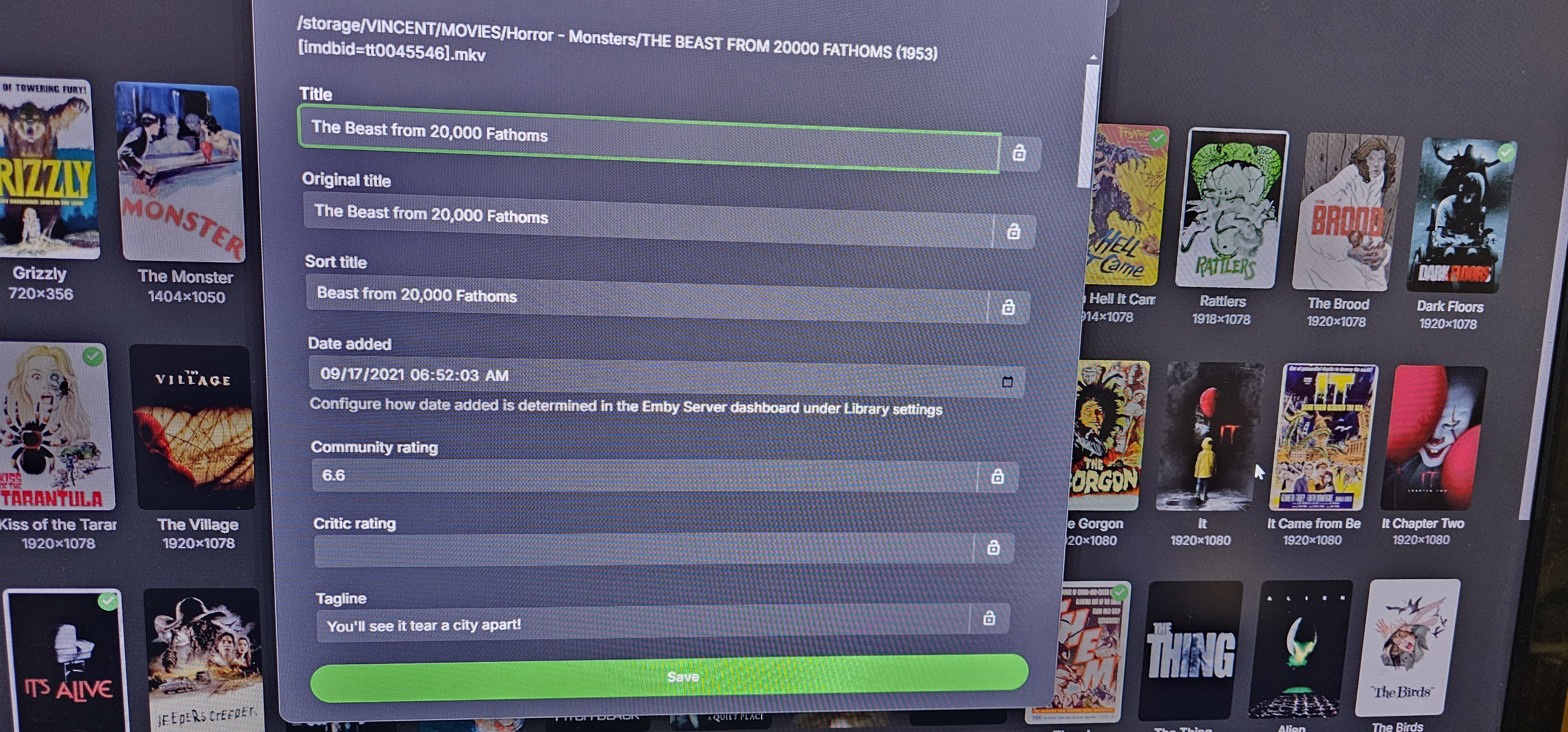

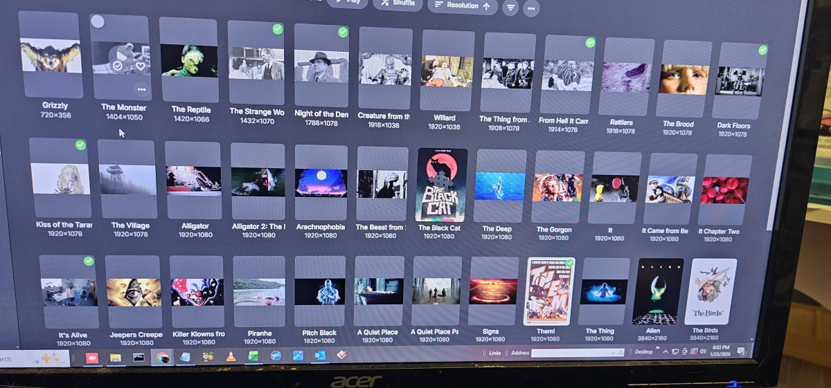

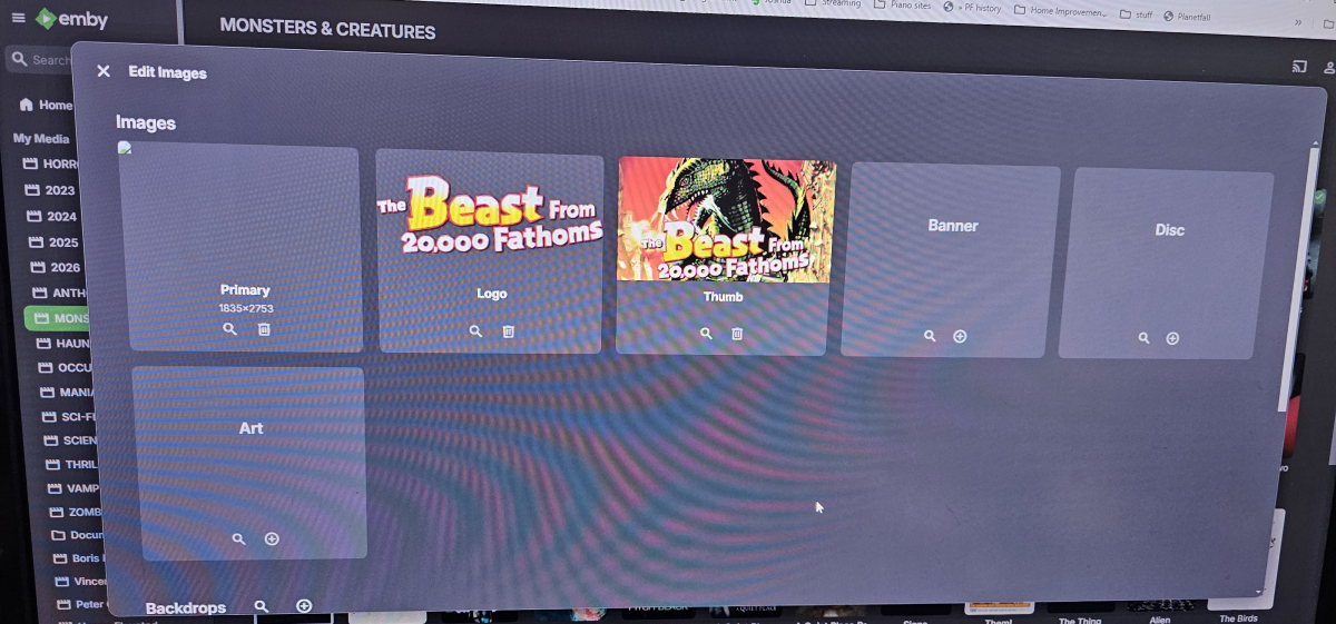

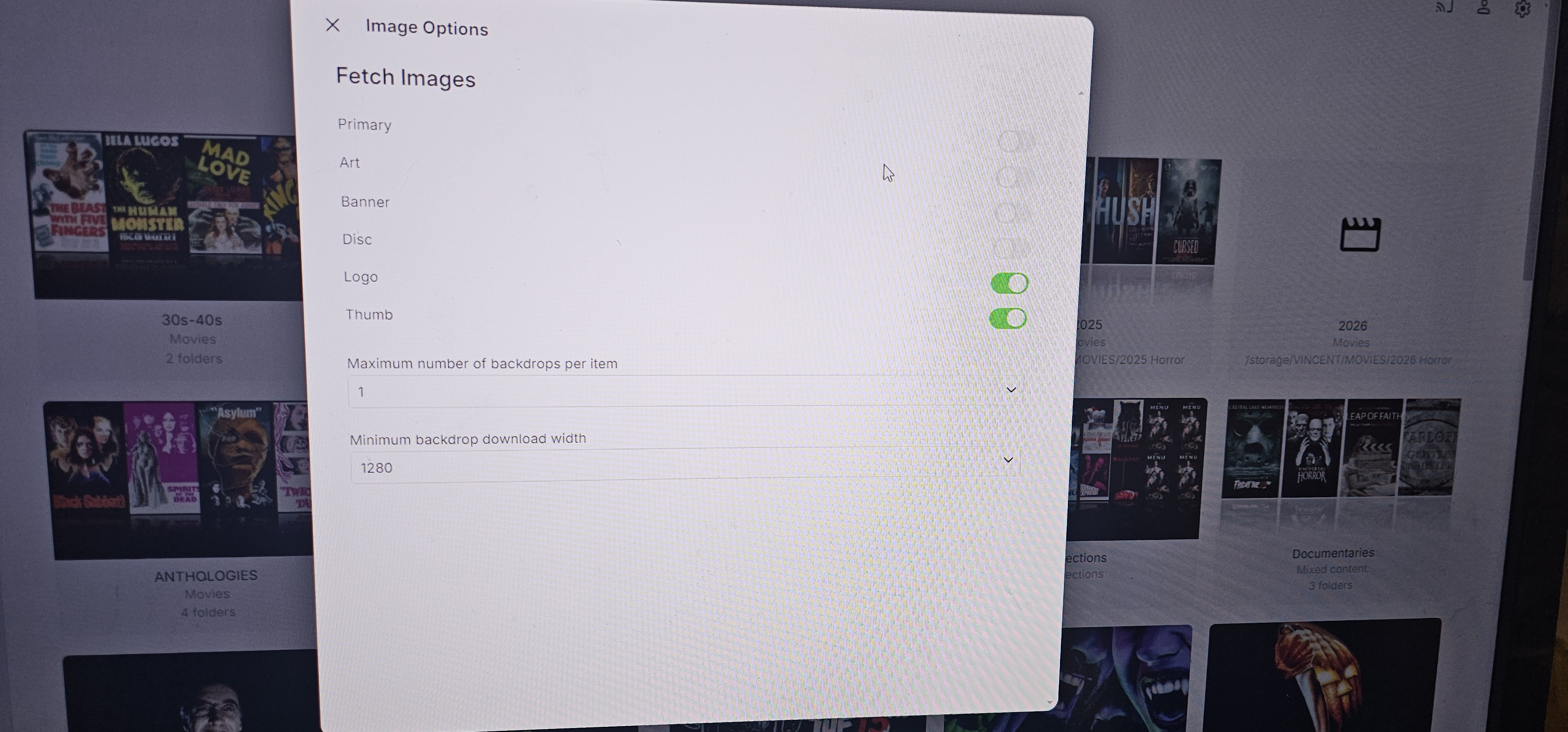

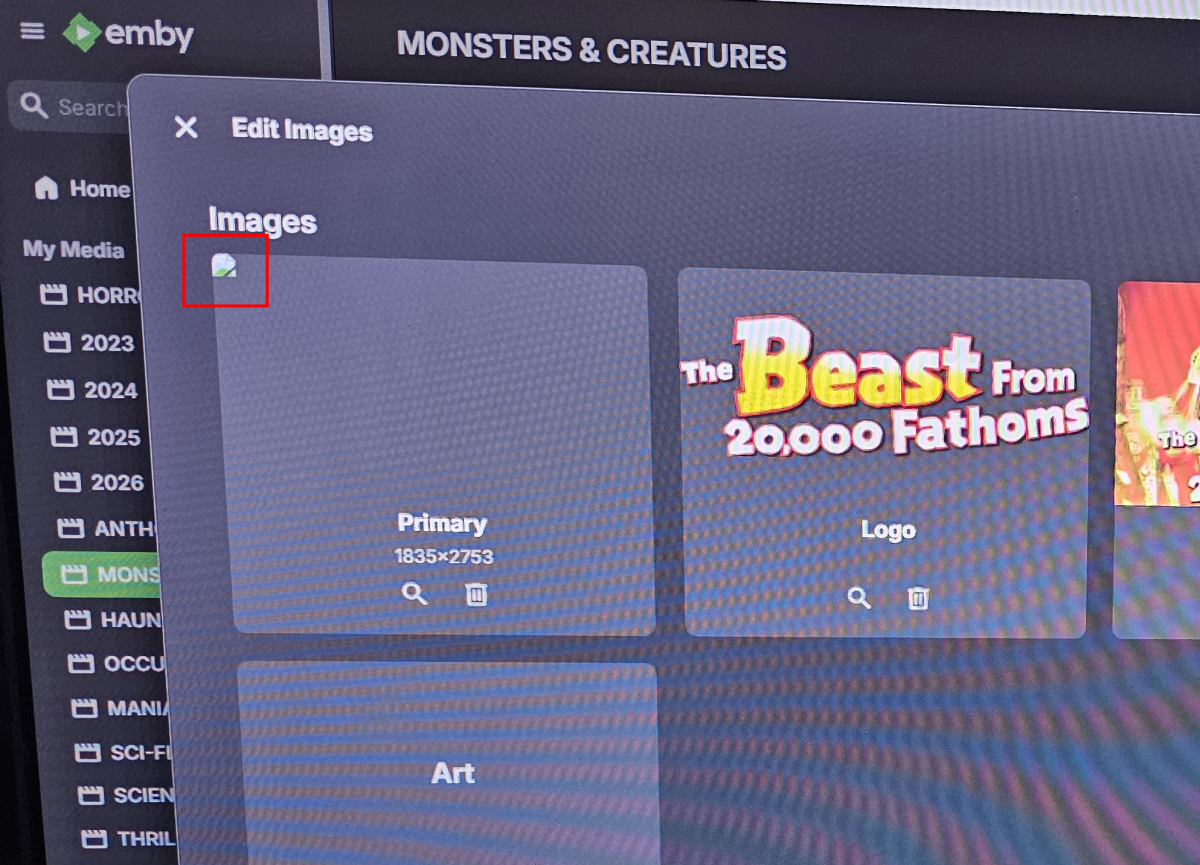

gogginguy 4 Posted January 23 Author Posted January 23 So, I created a backup to "reset" this issue and troubleshoot it. Another library having the same issue. It has Primary posters, but "The Beast From 20000 Fathoms" (as with MANY others as you see) doesn't show an image when "Edit images" is shown. Next to it, "The Black Cat" does have an image. Thus, when Scanning, it removes the Primary, with nothing to replace it. I disabled "Primary" on the Fetch Metadata (screenshot), but it insists on removing the Primary that is there, anyway.
ebr 16354 Posted January 24 Posted January 24 Hi. It appears it has an image but it is not loading for some reason: Can you please post the server log from the refresh?
Luke 42287 Posted January 24 Posted January 24 Hi there, please attach the Emby server log from when the problem occurred: How to Report a Problem Thanks!

Luke 42287 Posted January 27 Posted January 27 HI, did you tamper with the contents of the server metadata folder? It looks a file that used to be there is gone; 2026-01-23 23:02:26.955 Info HttpClient: GET https://image.tmdb.org/t/p/original/tsCiJ9tI1EpQF9oh3AlgOqnXmaS.png 2026-01-23 23:02:26.955 Error ImageService-0HNIQQDIG7TP8:0000001B: Error processing request *** Error Report *** Version: 4.9.3.0 Command line: /system/EmbyServer.dll -programdata /config -ffdetect /bin/ffdetect -ffmpeg /bin/ffmpeg -ffprobe /bin/ffprobe -restartexitcode 3 Operating system: Linux version 6.12.0-124.21.1.el10_1.x86_64 (mockbuild@iad1-prod-build001.bld.equ.rockylinux.org) (gcc (GCC) 14.3.1 20250617 (Red Hat 14.3.1-2), GNU l OS/Process: x64/x64 Framework: .NET 8.0.22 Runtime: system/System.Private.CoreLib.dll Processor count: 20 Data path: /config Application path: /system System.IO.FileNotFoundException: System.IO.FileNotFoundException: Could not find file '/config/metadata/library/28/285aba1687899960526c977248cbd54a/poster.jpg'.

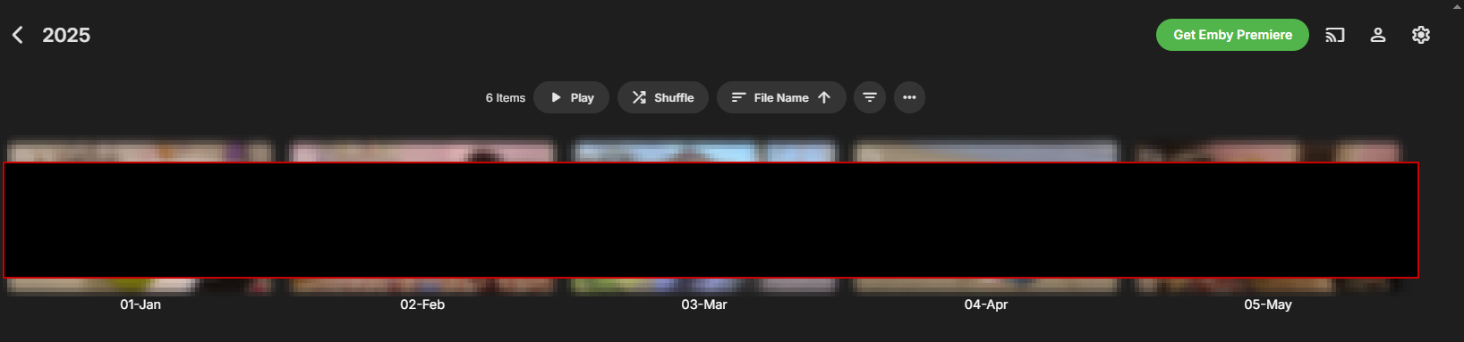

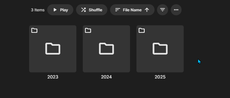

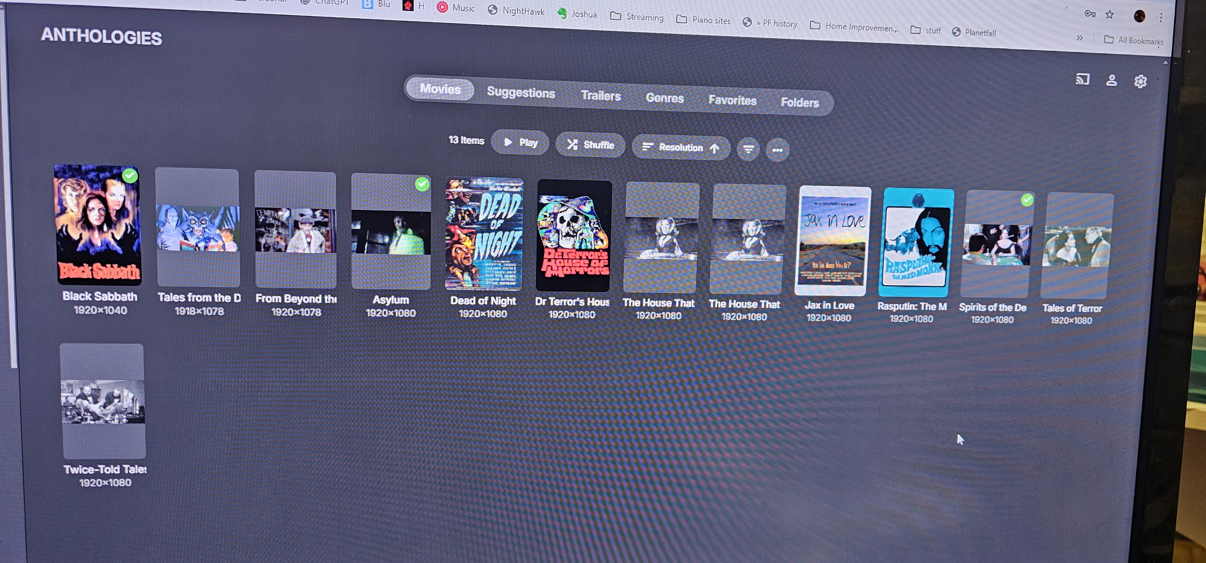

JeffJ0 1 Posted January 30 Posted January 30 Hello @Luke, Running Emby 4.9.3.0 (also tried, 4.10.0.1 beta) on Linux, I noticed that the metadata behavior and folder view settings have changed in a negative directions compared to previous releases. 1. In my Home Photo/Videos library I have multi-level folders e.g. Videos>2025>01-Jan..12-Dec. I can see the folder thumbnails for 01-Jan to 12-Dec based on the first video inside those folders. However, the top level folder 2025 does not show any thumbnails. This was not the case in the past. It makes video navigation harder and overall an 'incomplete' look to my library. Attached images show this behaviour. 2. In the previous versions I could set the default content view to folder so that when clients opened the Videos tab for example, the folder view was greeted. Now I don't see an option to set this, always see individual videos first. I read in the 4.9.3.0 release notes a comment about 'Add library option to use legacy folder scanning method' but could not find it anywhere. Can you please allow an option or a workaround (with out having to manually add a posted/image to each top level folder) to have the previous functionality? Regards, JJ

JeffJ0 1 Posted January 31 Posted January 31 7 hours ago, Luke said: Hi, can you please explain more of what you mean by this? The videos tab is not folder based, right? I have two libraries called Photo, Videos.. Inside these libraries everything is stored in folders>sub folders. Already the video subfolders won't show thumbnails. But Also when I open the Video library, the default view is individual items not Folders. I have to manually select View as folders each time. The most pressing issue for me is the redaction of previous functionality i.e. folder thumbnails. Regards, JJ

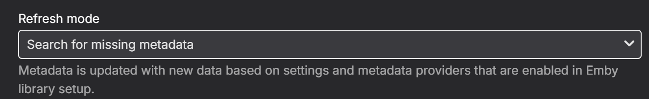

curation 0 Posted February 3 Posted February 3 Are there universal control options for metadata? For example, something similar to the Refresh Metadata window menu when selecting the three dots of a "Media Title". The menu reads "Refresh mode": Replace all metadata or Search for missing metadata? Looking for an option to confirm keep existing metadata "as is" and add missing metadata.
Luke 42287 Posted February 4 Posted February 4 5 hours ago, curation said: Are there universal control options for metadata? For example, something similar to the Refresh Metadata window menu when selecting the three dots of a "Media Title". The menu reads "Refresh mode": Replace all metadata or Search for missing metadata? Looking for an option to confirm keep existing metadata "as is" and add missing metadata. Hi, that’s what search for missing metadata does.
