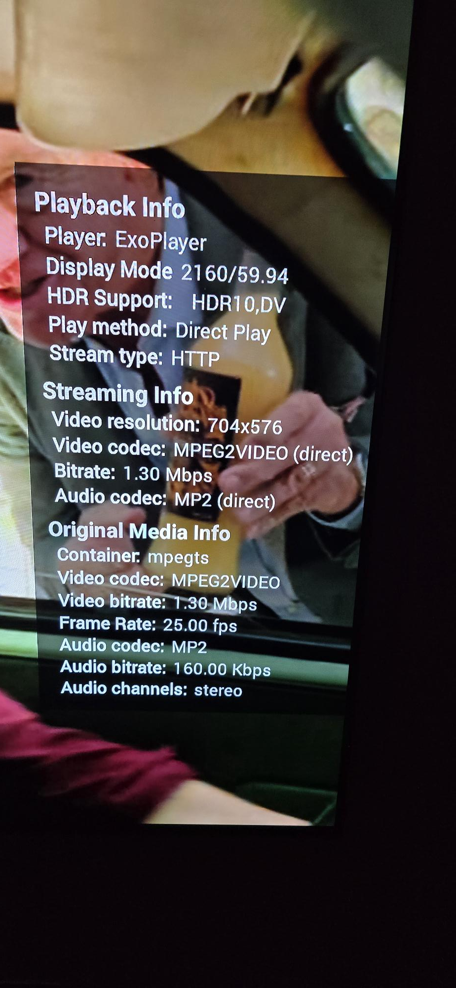

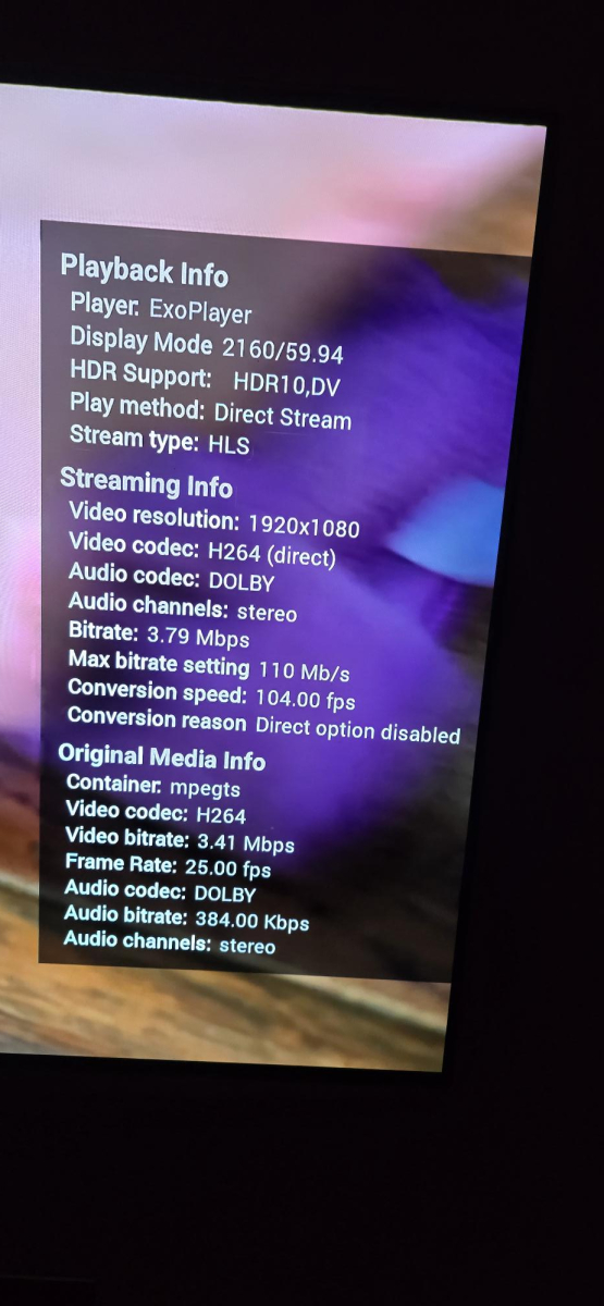

picturepete 2 Posted January 30 Author Posted January 30 Another issue, when playing say BBC1 you set the volume to listen, the audio codec according to stats for nerds is DOLBY, change channel to say 5+1 then the volume decreases by about 75% and the stats for nerds says mp2. Do the same in KODI and volume remains the same for either of these channels. These issues seem only to occur in the android version. What is going on?
ebr 16335 Posted January 30 Posted January 30 Hi. That's not the same app as you were using. Do you have this issue with the standard Android app?
picturepete 2 Posted January 30 Author Posted January 30 Yes it does it on both, I've being trying the different apps to see if they have the same issues and they replicate the problems on both.

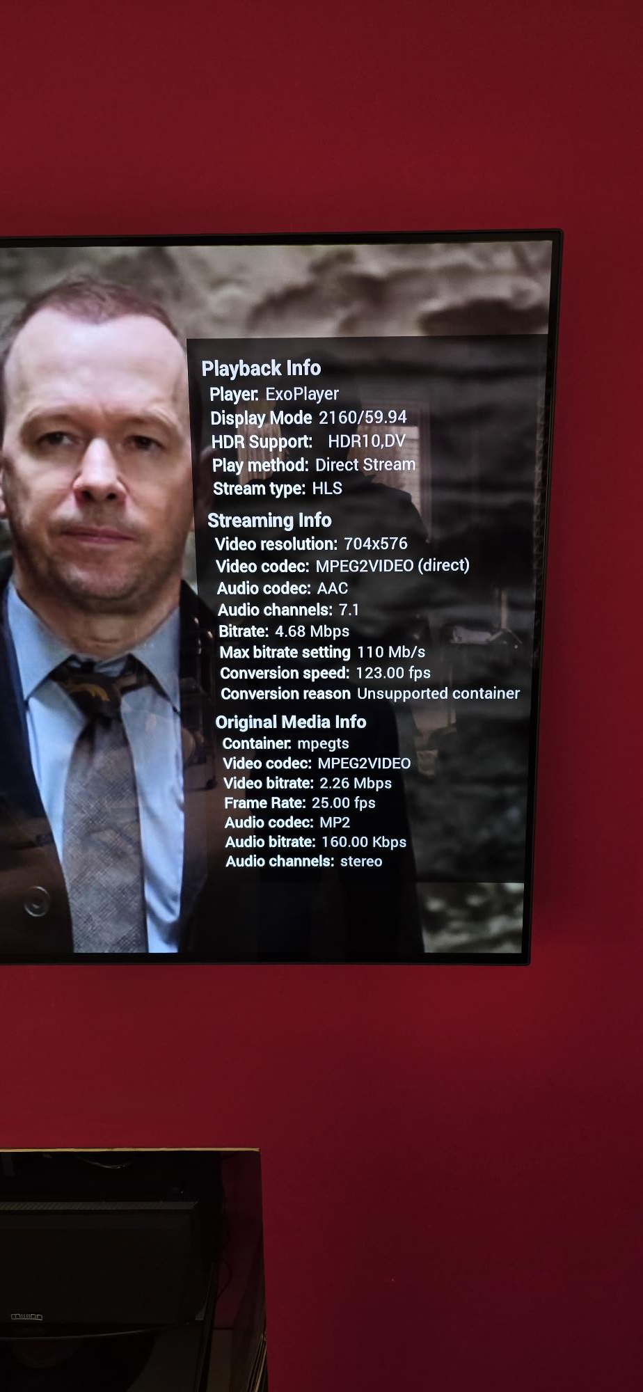

picturepete 2 Posted February 2 Author Posted February 2 So I have deleted both apps, I am running on a Nvidia Shield, what app should I be using? Before deleting anything I cleared down all the cache and data then deleted the apps, going through the store it gives me the app for android tv so installed this and now the volumes seem ok, Playback on Channel 5 according to stats for nerds is like this, see attachment, unsupported container but the volume is OK. However if you stream direct you still get the nar sound on the non nar track.
Luke 42243 Posted February 3 Posted February 3 16 hours ago, picturepete said: So I have deleted both apps, I am running on a Nvidia Shield, what app should I be using? Before deleting anything I cleared down all the cache and data then deleted the apps, going through the store it gives me the app for android tv so installed this and now the volumes seem ok, Playback on Channel 5 according to stats for nerds is like this, see attachment, unsupported container but the volume is OK. However if you stream direct you still get the nar sound on the non nar track. Hi, we recommend using Emby for Android going forward: https://emby.media/emby-for-android.html
