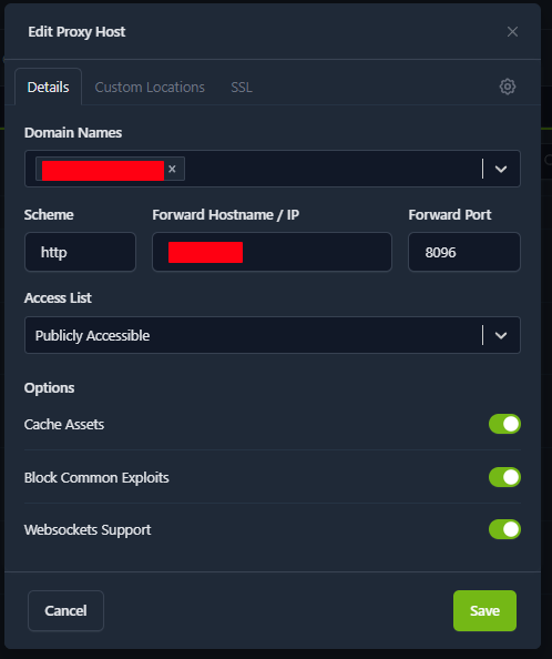

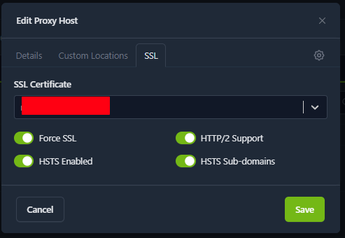

suttyd0lt 2 Posted January 24 Author Posted January 24 (edited) Hey, thanks for the above. I dont quite have the technical prowess to figure this out. With the proxy specifically, I've tried without my headers, moved to zerossl, changed my certs from ECDSA to RSA and forced specific cyphers, I did wonder whether http/2 was playing a part, but npm+ forces you onto it with no variable to downgrade and the above suggests its not a problem. In the end I've installed official NPM onto my free oracle VPS -> WG -> Server with emby. It is now working for that user (in a fashion) Will make a post on the NPM+ fork github discussion. Thanks for your help. Edited January 24 by suttyd0lt 1
