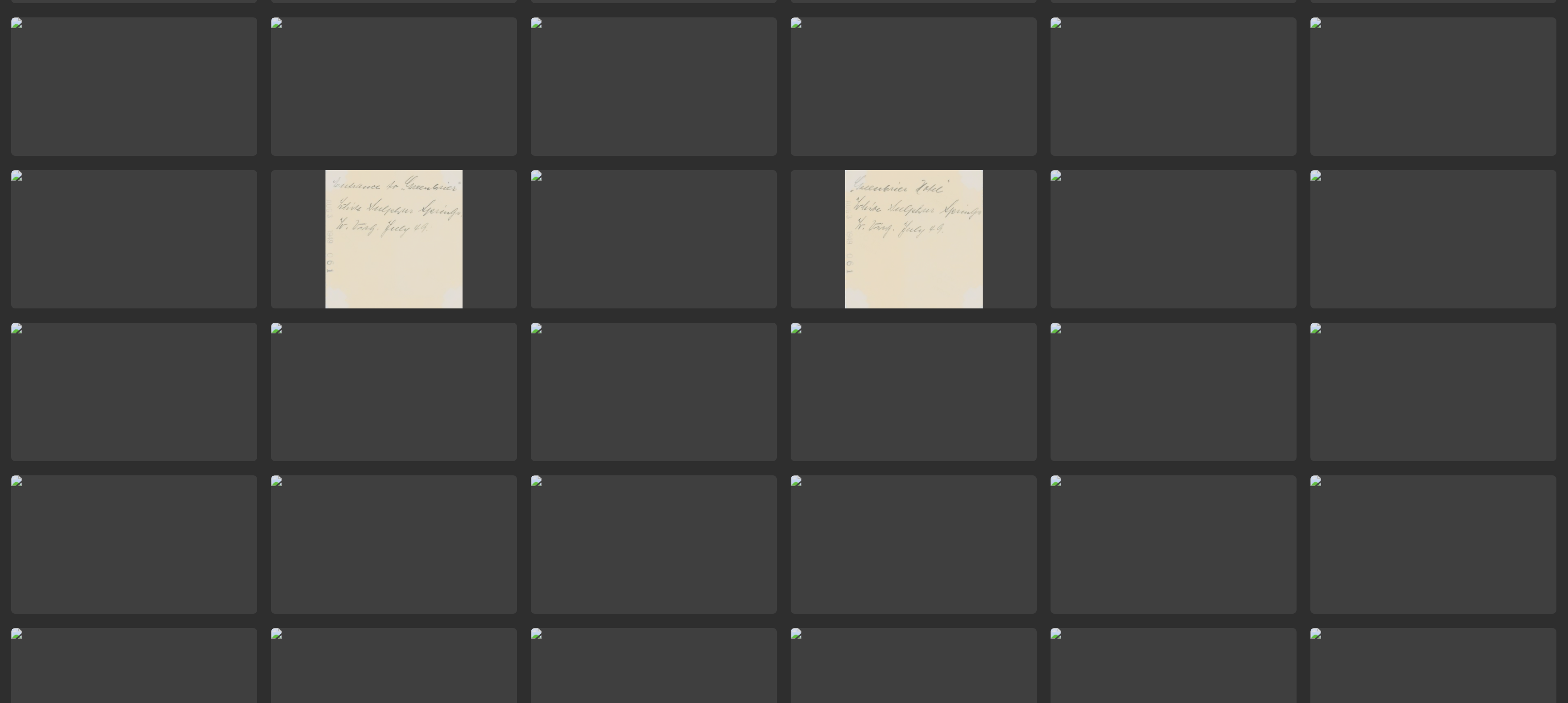

dark_aegis 3 Posted January 21 Posted January 21 (edited) I've got a bunch of scanned images in compressed TIF format and it looks like Emby is having trouble seeing them - only showing a broken image where they should be in the browser.} The files were scanned uncompressed then bulk lossless compressed via a script in photoshop. I believe I used ZIP compression. Uncompressed TIF seem to show up fine. Here's a sample of what I'm seeing in my log when I try to get them running - this is on the newest stable version of Emby, but it's been an issue since I started using it - the most telling bit seems to be the repeated "AdobeDeflate compression support is not configured": Quote 2026-01-20 20:39:29.653 Error ImageProcessor: Error encoding image *** Error Report *** Version: 4.9.3.0 Command line: C:\Users\Bedroom\AppData\Roaming\Emby-Server\system\EmbyServer.dll Operating system: Microsoft Windows 10.0.22631 OS/Process: x64/x64 Framework: .NET 8.0.22 Runtime: C:/Users/Bedroom/AppData/Roaming/Emby-Server/system/System.Private.CoreLib.dll Processor count: 16 Data path: C:\Users\Bedroom\AppData\Roaming\Emby-Server\programdata Application path: C:\Users\Bedroom\AppData\Roaming\Emby-Server\system NetVips.VipsException: NetVips.VipsException: unable to call jpegsave source input: AdobeDeflate compression support is not configured tiff2vips: read error at NetVips.Operation.Call(String operationName, VOption kwargs, Image matchImage, Object[] args) at NetVips.Image.Jpegsave(String filename, Nullable`1 q, Nullable`1 optimizeCoding, Nullable`1 interlace, Nullable`1 trellisQuant, Nullable`1 overshootDeringing, Nullable`1 optimizeScans, Nullable`1 quantTable, Nullable`1 subsampleMode, Nullable`1 restartInterval, Nullable`1 keep, Double[] background, Nullable`1 pageHeight, String profile) at Emby.Drawing.LibVips.LibVipsImageProcessor.EncodeImage(String inputPath, String outputPath, Boolean autoOrient, Nullable`1 orientation, Int32 quality, ImageProcessingOptions options, ImageFormat outputFormat) at Emby.Drawing.ImageProcessor.ProcessImage(ImageProcessingOptions options, CancellationToken cancellationToken) Source: NetVips TargetSite: System.Object Call(System.String, NetVips.VOption, NetVips.Image, System.Object[]) ... 2026-01-20 20:40:27.548 Error ImageProcessor: Error encoding image *** Error Report *** Version: 4.9.3.0 Command line: C:\Users\Bedroom\AppData\Roaming\Emby-Server\system\EmbyServer.dll Operating system: Microsoft Windows 10.0.22631 OS/Process: x64/x64 Framework: .NET 8.0.22 Runtime: C:/Users/Bedroom/AppData/Roaming/Emby-Server/system/System.Private.CoreLib.dll Edited January 21 by dark_aegis 1

dark_aegis 3 Posted January 21 Author Posted January 21 I doubt it'll help, but this is what I see in the interface.

dark_aegis 3 Posted January 27 Author Posted January 27 (edited) 11 hours ago, Luke said: Hi there, please attach the Emby server log from when the problem occurred: How to Report a Problem Thanks! Gotcha. My bad on extracting the part I thought was pertinent - actually against the guidelines, whoops. Usually I'm better at reading directions than that. Here's the full entry. I saw that there were other logs, but they were created before I went through and tried to generate thumbnails/view the problem files. The issues seem to start around line 379. My album is a mix of jpeg, compressed tif, and uncompressed TIF, so a lot of the images were able to successfully generate - you should see a few points in the log, though, where dozens of photos failed (I was able to get the pages of broken images a few times). Let me know if you need anything else. TifImageIssue012726.txt Edited January 27 by dark_aegis
Luke 42287 Posted January 28 Posted January 28 OK so the bundled libtiff needs to be compiled with support for certain features. Hopefully it is easy enough to add libraries but it usually doesn't end up being that simple. We'll look into it. Thanks. 1
