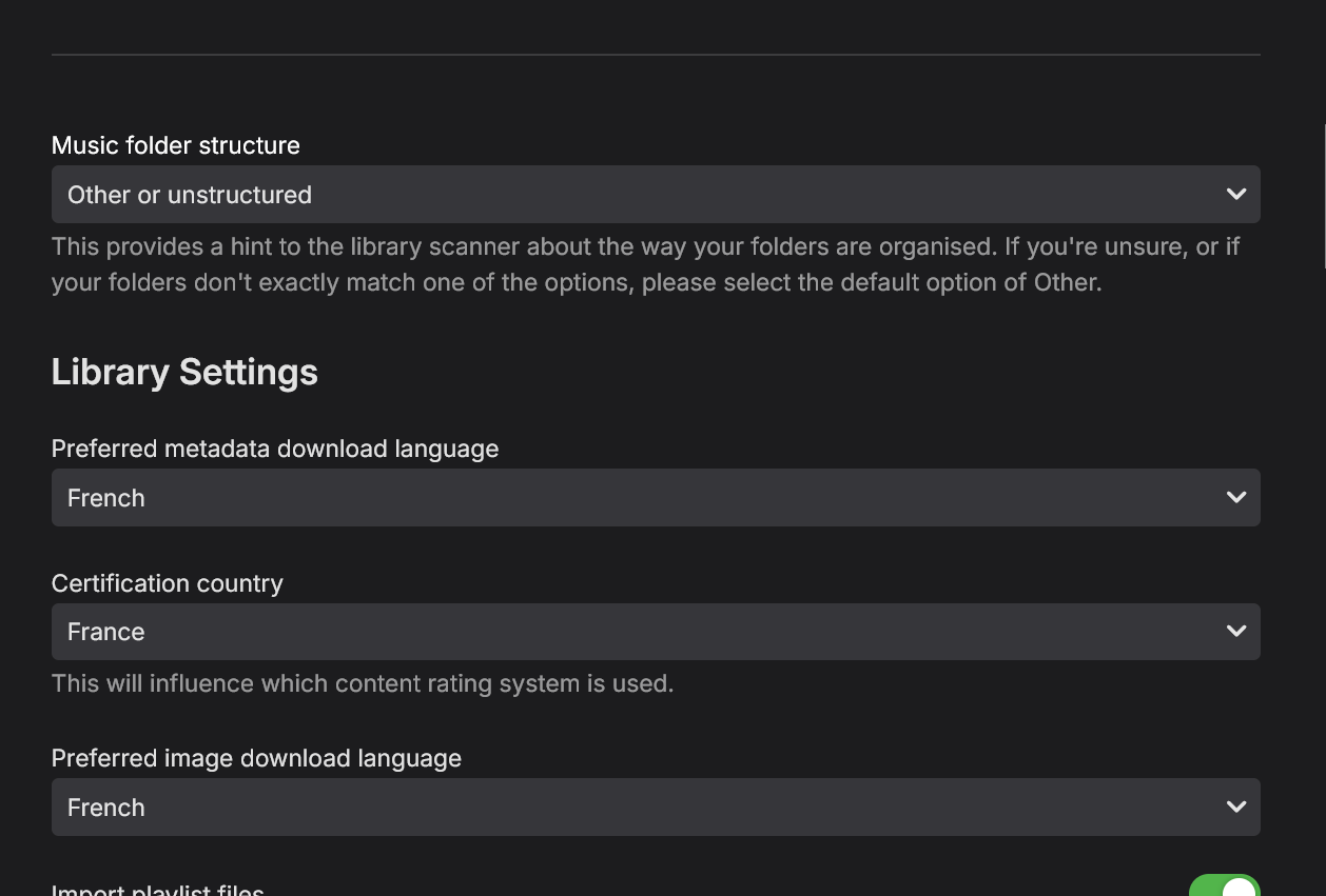

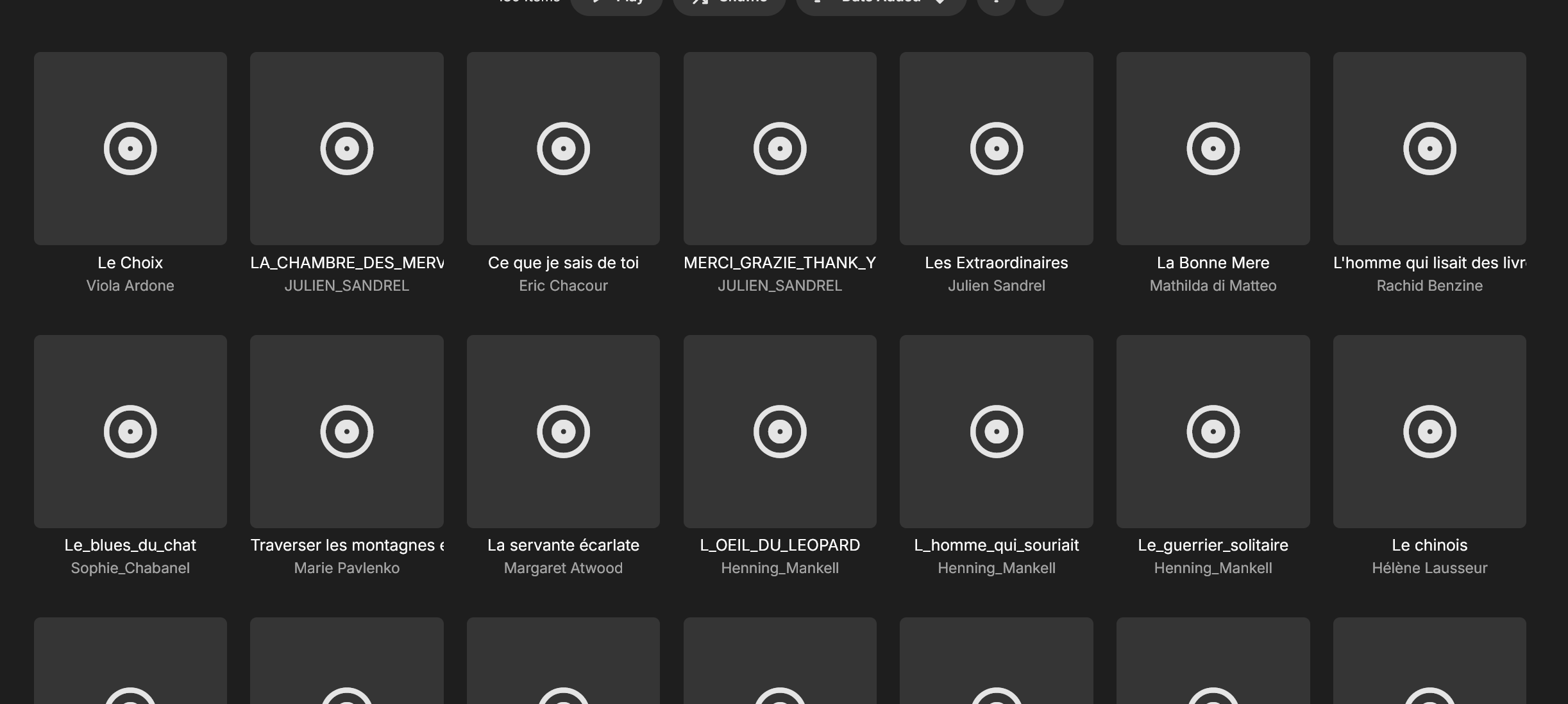

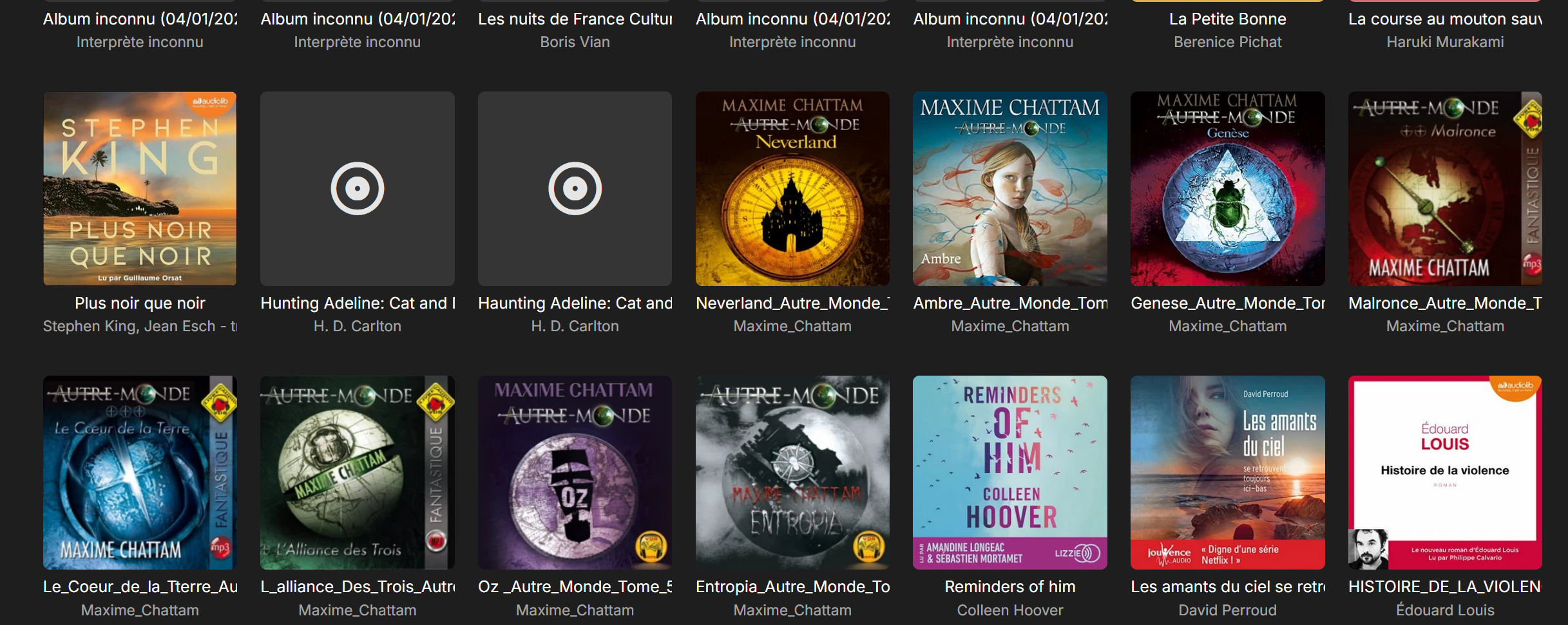

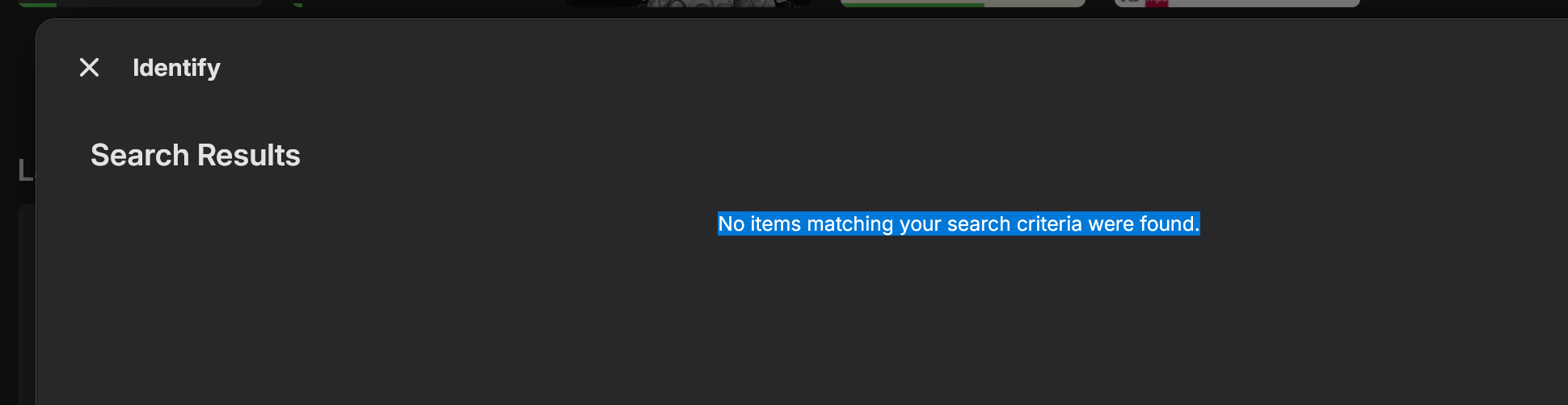

mrjay42 5 Posted January 19 Posted January 19 Hi all, My problem My Audio Books' metadata are not fetched from the internet/detected/retrieved from the metadata "service". So lately, ALL my newly added audio books look like this: (You can probably notice that the audio books are in French, maybe the problem is related to this? My server's display language is English, some of the content available on it is in French. That doesn't cause any problem for the other types of content: films, TV series, etc.) Older ones ("older" as in added on my Emby before a certain date (undefined right now, is it before a particular update of Emby? a plugin?) look like that: You can see that most of them are/were correctly detected. What I have tried Restarting Emby "Forced" refresh metadata "Forced" scan library files" Fidgeting in the options -> didn't find anything significant, that's actually the first reason I'm posting here Tried to identify manually, and this the most interesting -> when I type the correct title of an audio book -> emby immediately displays "No items matching your search criteria were found." -> it doesn't really search, it feels like there's no http request to any API or anything happening. (see screenshot below) ----> this is actually the second main reason for me posting this here. Pulling Emby's image (I'm using docker compose, with Portainer) Software Setup I self host my Emby server on a PC in my home, but I access it through the internet via reverse proxy (see the docker compose below if you're interested) OS: Linux Debian Stable - Debian GNU/Linux 13 (trixie) Emby: Version 4.9.3.0 Docker Compose stack version: "2.3" services: emby: image: emby/embyserver container_name: embyserver #runtime: cpu # Expose NVIDIA GPUs networks: - private_secured_network #network_mode: bridge # Enable DLNA and Wake-on-Lan environment: - UID=1000 # The UID to run emby as (default: 2) - GID=1000 # The GID to run emby as (default 2) - GIDLIST=1000 # A comma-separated list of additional GIDs to run emby as (default: 2) - NVIDIA_VISIBLE_DEVICES=all - NVIDIA_DRIVER_CAPABILITIES=compute,utility,video volumes: - /home/bla/Desktop/apps/emby:/config # Configuration directory - /home/bla/Desktop/data/Downloads/transmission/completed:/mnt/share1 ports: - 8096:8096 # HTTP port # - 8920:8920 # HTTPS port deploy: resources: reservations: devices: - driver: nvidia count: all capabilities: [gpu] restart: always labels: - "traefik.enable=true" - "traefik.http.routers.emby.rule=Host(`jayflix.bla.stream`)" - "traefik.http.routers.emby.entrypoints=websecure" - "traefik.http.routers.emby.tls.certresolver=myresolver" - "traefik.http.services.emby.loadbalancer.server.port=8096" networks: private_secured_network: external: true But that shouldn't matter for the problem at hand. Plugins I don't know if this is of any importance, but this is a screenshot of the installed plugins Logs I have attached the latest logs from my Emby server embyserver.txt

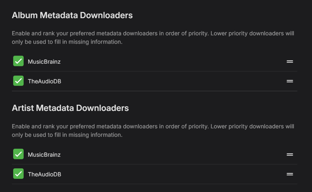

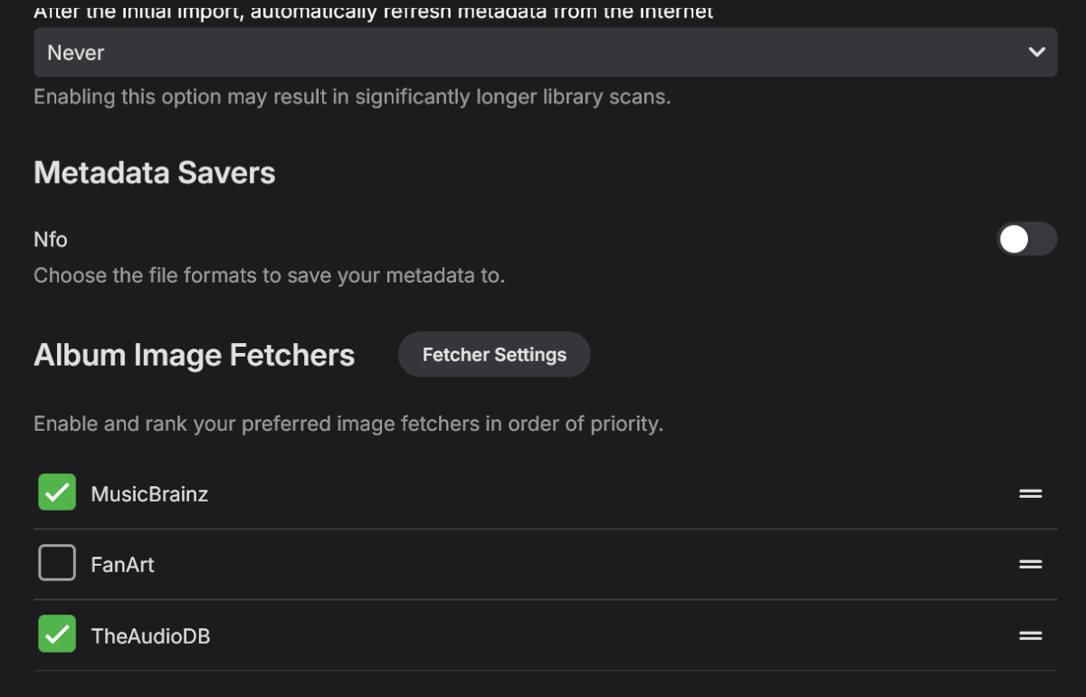

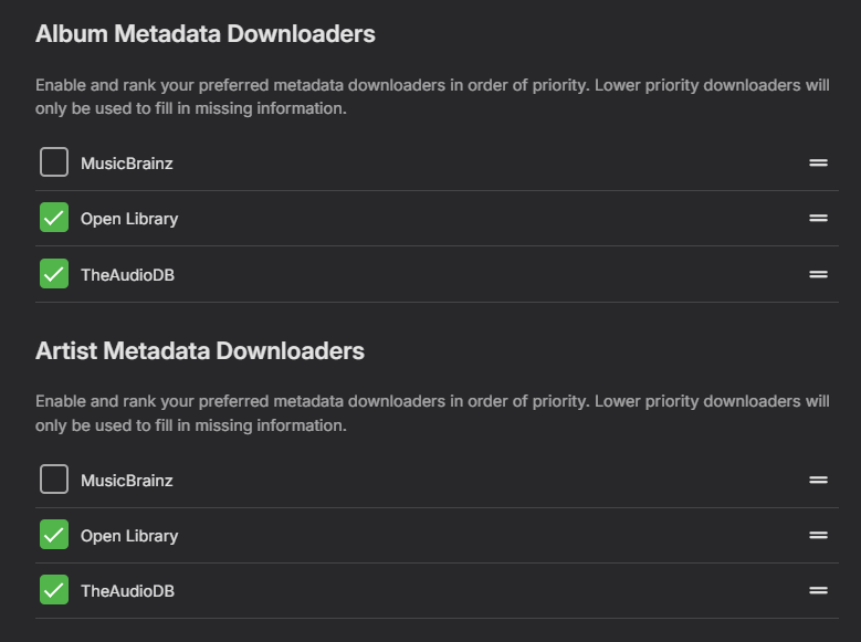

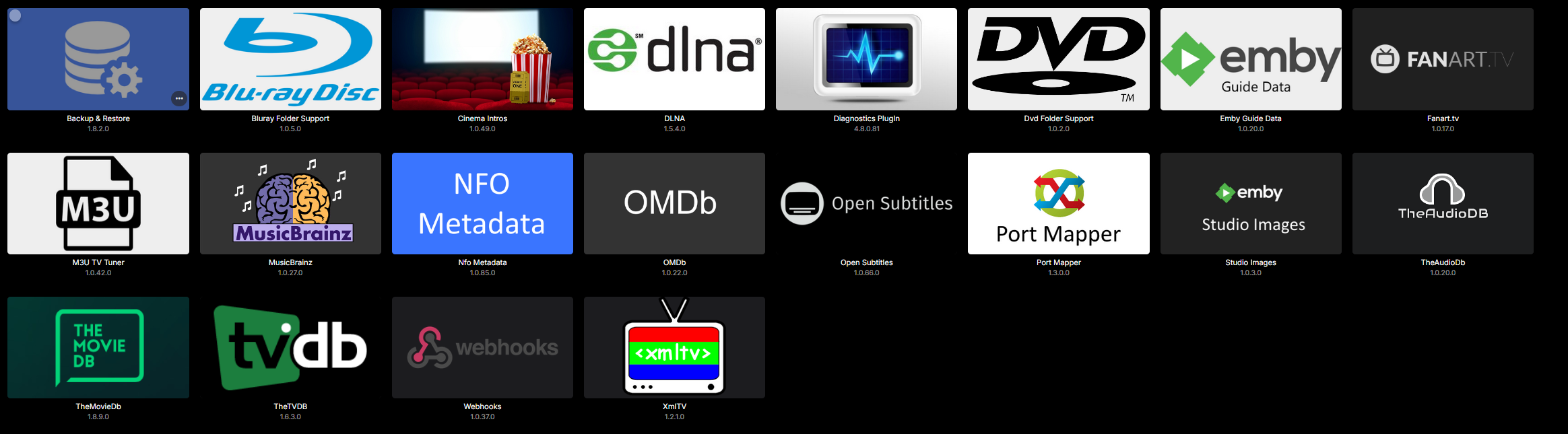

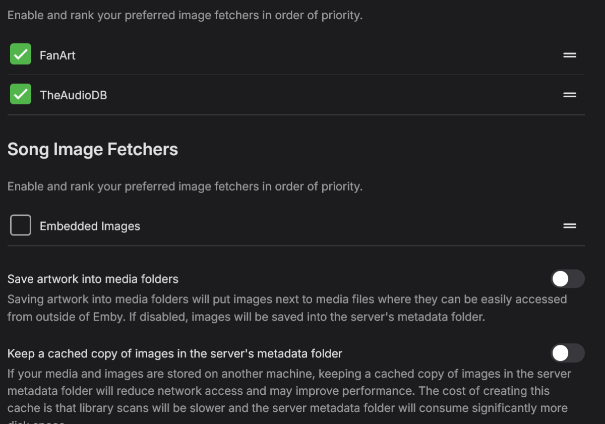

mrjay42 5 Posted January 21 Author Posted January 21 Ok so it's kinda working now, but far from being perfect. What do I mean: Some of the audiobooks are being identified correctly. But weirdly, some EXTREMELY well known audiobooks are not identified. For instance, "La servante Ecarlate" (The Handmaid's Tale) is NOT identified, and even manually, if I type "servante" in the search tool, I get less well-known audiobooks, but not the "La servante ecarlate". So, now I want to check with you whether my Audiobooks metadata fetchers are 'correct' and/or they could be changed/improved. This is what I have: If you see anything wrong here, please tell me. Also if there are other "metadata fetchers" that I should install -> do not hesitate to tell me, I'll install them Thanks again for your help @Luke
Luke 42242 Posted January 23 Posted January 23 On 1/21/2026 at 8:50 AM, mrjay42 said: Ok so it's kinda working now, but far from being perfect. What do I mean: Some of the audiobooks are being identified correctly. But weirdly, some EXTREMELY well known audiobooks are not identified. For instance, "La servante Ecarlate" (The Handmaid's Tale) is NOT identified, and even manually, if I type "servante" in the search tool, I get less well-known audiobooks, but not the "La servante ecarlate". So, now I want to check with you whether my Audiobooks metadata fetchers are 'correct' and/or they could be changed/improved. This is what I have: If you see anything wrong here, please tell me. Also if there are other "metadata fetchers" that I should install -> do not hesitate to tell me, I'll install them Thanks again for your help @Luke HI, you could also try OpenLibrary from the plugin catalog. It sounds like you might want to disable musicbrainz and audiodb.

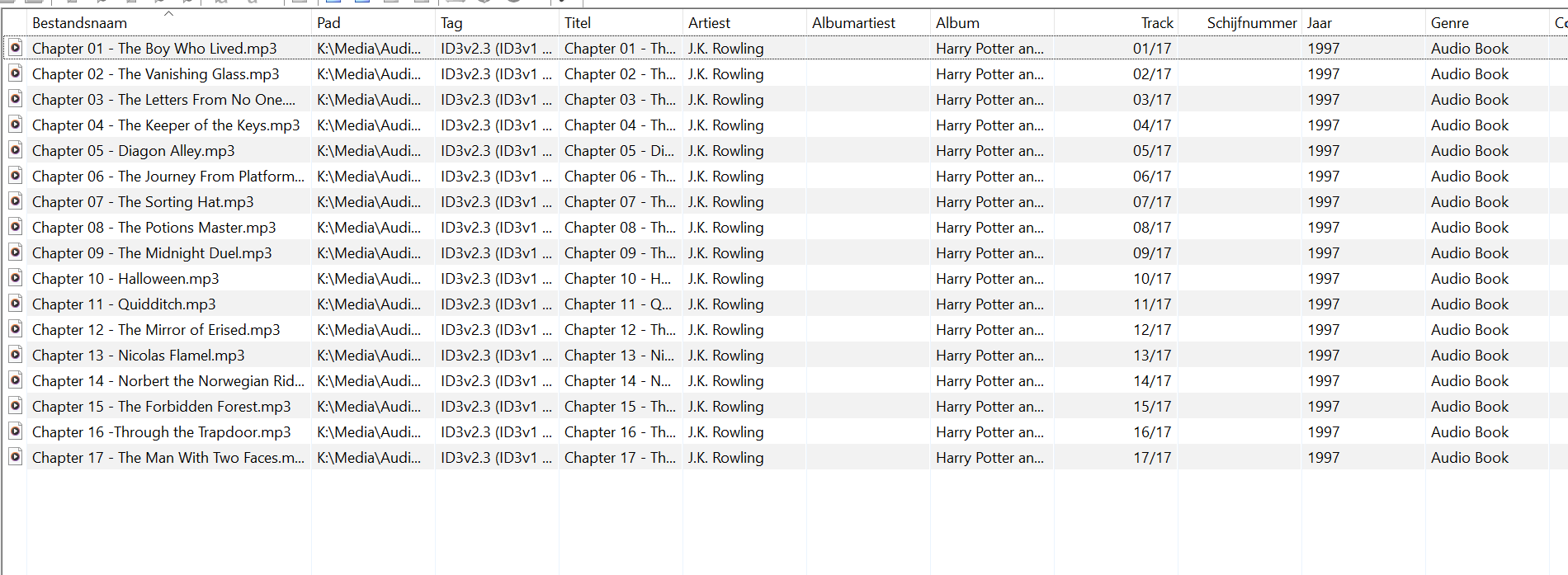

brothom 211 Posted January 23 Posted January 23 1 hour ago, mrjay42 said: Ok I'm gonna try this! I'll update this post when I'll have some new results Recently I got some of my audiobooks digitized and found that this setup works fine for me: It's important to have the audio metadata itself also written correctly, especially Artist, Album and Track (for the correct order). I used mp3tag to apply the correct metadata to the audiobook chapter I'd digitized myself as shown below:
Luke 42242 Posted January 24 Posted January 24 I think it depends on your content. If none of your audio books are on musicbrainz or audiodb, then you should disable those to avoid possible false matches.

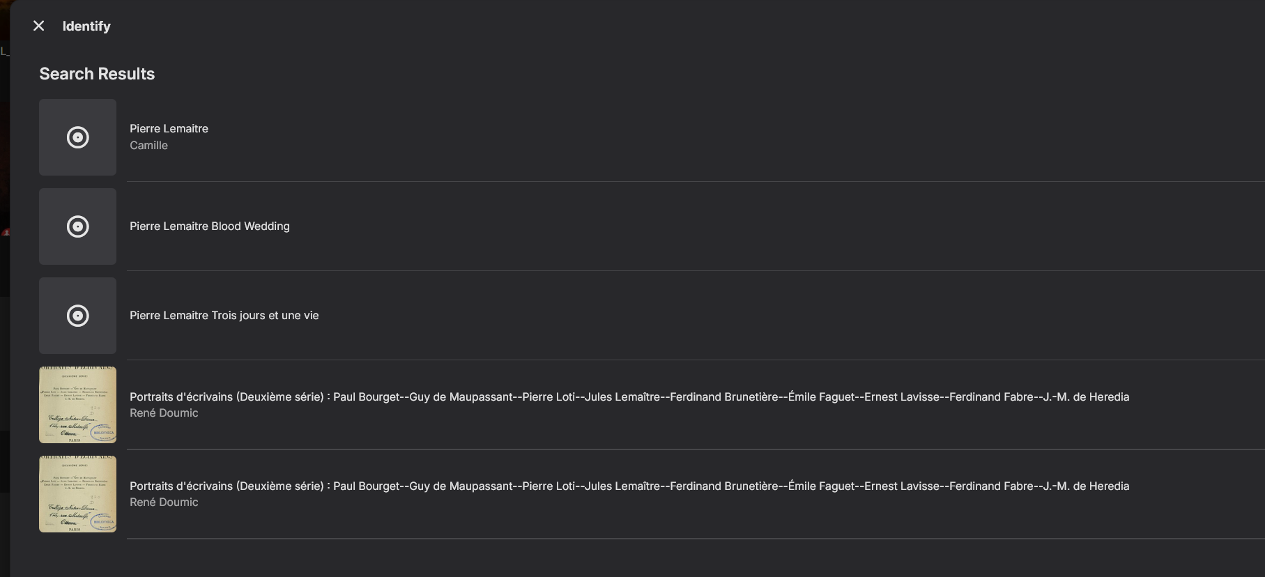

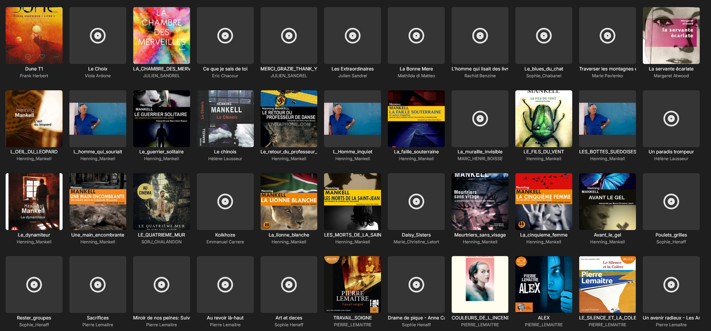

mrjay42 5 Posted January 27 Author Posted January 27 Ok so here's what I did: As suggested by @brothomI have installed/enabled the following plugins "TheAudioDB" and "OpenLibrary" I selected them as the metadata manager for my library called "Audiobooks" And I went to my favorite website and downloaded the most well-known and most available audiobook, which is "Dune - Frank Hebert", in French. Because my "audiobooks" library is ONLY in French And all the metadata were retrieved perfectly and immediately for THAT BOOK BUT I have so many other books that are NOT identified!! Even when I try to do it manually: For instance, you can see in the bottom row of the above screenshot, books by "Pierre Lemaitre" who is, without any doubt, a famous author (https://en.wikipedia.org/wiki/Pierre_Lemaitre ) in wikipedia page is literally translated in THIRTY languages. This is not an old obscure random unknown author. And when I type HIS NAME, in the search bar, to identify manually one of his books, I get this: Literally nothing. And when I search for the book title "sacrifices", I obviously get a long list but NO book by Pierre Lemaitre. So, the questions remain: Did I do anything wrong? Is there some kind of metadata manager/fetcher that is adapted to French authors/books/audiobooks? Did anything change recently in Emby that could cause this problem to emerge? Thanks again to all of you for your help Thanks @Luke@brothom
brothom 211 Posted January 27 Posted January 27 (edited) @mrjay42you're getting there! For Emby to correctly identify a book it also needs the metadata, see my previous explanation: On 23/01/2026 at 15:29, brothom said: It's important to have the audio metadata itself also written correctly, especially Artist, Album and Track (for the correct order). I used mp3tag to apply the correct metadata to the audiobook chapter I'd digitized myself as shown below: In the previous example I had to correct the author J.K. Rowling, as something had put "I.K. Rowling" in and the book name (it didn't include Harry Potter and). The "Album" and "Artist" metadata are most important here. Using these two fields separately, Emby will be able to figure out which book you're actually referring to. Combining both fields, it allows Emby to group the underlying media files in a sort of playlist style. 20 minutes ago, mrjay42 said: I have so many other books that are NOT identified!! Even when I try to do it manually: If you want to automate the process, or have an application try to identify your audiobooks for you there are two popular options: https://www.audiobookshelf.org/ and https://calibre-ebook.com/. One is a separate server and (I think) the other is just an application. I also had a lot of issues identifying books, especially books that are slightly less popular (I'm looking at you Goosebumps!). --- Regarding Pierre Lemaitre's Sacrifices, it does exist on openlibrary.org: https://openlibrary.org/works/OL23231222W/Sacrifices?edition=key%3A/books/OL32370833M. What you could do, is if manually identifying (via search) doesn't give you the right result, is enter the ID manually in Emby via the Edit function. That should basically always strictly identify the media: Edited January 27 by brothom 1

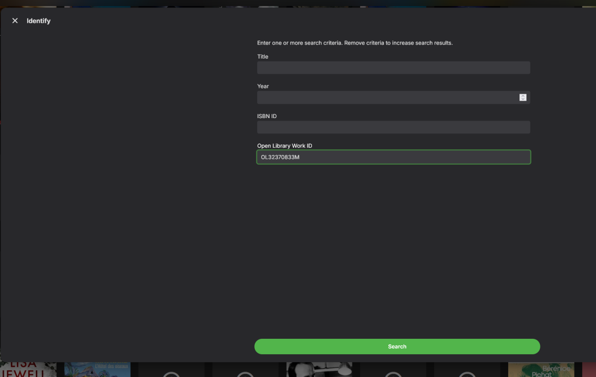

mrjay42 5 Posted January 27 Author Posted January 27 @brothomthanks again. So the manual identification worked! Thanks. It's not automatic, but at least fully manual identification via Open Library Work ID works 1
