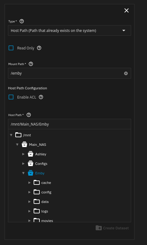

AshPhantom32 0 Posted January 17 Posted January 17 Hi, I have Emby installed on TrueNas community edition and when i am setting up the libraries i put the path in and im able to access all folders in the host path except the folder which contain my movies and shows. when i just type the path in instead its unable to scan the folders and none of the media is appearing on the server. In TrueNas Emby has been given full access to the host path, i have tried it while shared with SMB, after that didn't work i deleted the share and tried to access it then but still no luck here is the host path in using for my media. any help would be appreciated as this is driving me mad
AshPhantom32 0 Posted January 18 Author Posted January 18 off the back of this i just tried creating a new group within TrueNas for Emby with the GID of 3002 and then set the GID in the config to 3002 and then made sure in the ACL that the group has full control of the host path but im still getting the same problem, i can access all folders within the host bath except the ones where my media is. at this point im not sure its a permissions problem
Luke 42242 Posted January 20 Posted January 20 How exactly are you trying to access them in Emby Server?
AshPhantom32 0 Posted January 20 Author Posted January 20 im trying to access them through the libraries ive set up You can see the host path in the other screenshot i took is also setup on the config in TrueNas

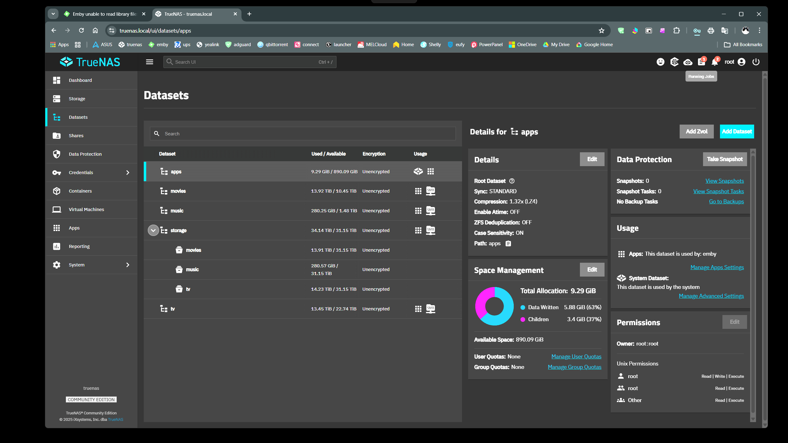

Solution dgrigo 35 Posted January 31 Solution Posted January 31 (edited) Hmm dunno if it works like this, on root of a dataset, I suggest to create datasets for the categories MOVIES, TV etc. Understand? Ignore my dataset storage its a backup , so different setup. Focus on datasets I have in root, those are my library folders If not I will be back later and here is some examples of mount paths volumes: - bind: create_host_path: False propagation: rprivate read_only: False source: /mnt/storage/emby target: /backup type: bind - bind: create_host_path: False propagation: rprivate read_only: False source: /mnt/storage/watchfolder target: /watchfolder type: bind - bind: create_host_path: False propagation: rprivate read_only: False source: /mnt/tv/books_library target: /books type: bind - bind: create_host_path: False propagation: rprivate read_only: False source: /mnt/apps/embyserver target: /config type: bind - bind: create_host_path: False propagation: rprivate read_only: False source: /mnt/movies/movies_library target: /movies type: bind - bind: create_host_path: False propagation: rprivate read_only: False source: /mnt/music/music_library target: /music type: bind - bind: create_host_path: False propagation: rprivate read_only: False source: /mnt/tv/tv_recording target: /recording type: bind - bind: create_host_path: False propagation: rprivate read_only: False source: /mnt/tv/tv_library target: /tv type: bind - bind: create_host_path: False propagation: rprivate read_only: False source: /mnt/tv/video_library target: /video type: bind Edited January 31 by dgrigo insert picture
AshPhantom32 0 Posted February 1 Author Posted February 1 This worked!! Thank you for the help guys, i appreciate it
