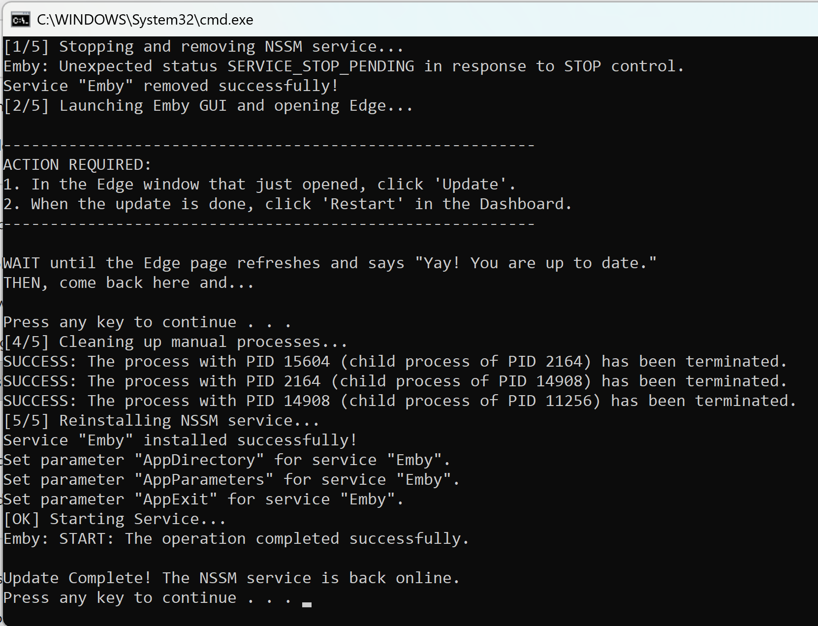

I have Emby Server installed on windows 11 running as a service through NSSM. Whenever I do the manual update, to get a new version of Emby something always messes up (database corrupted, user profile missing etc). I have given up on that manual install or Emby Server to update it process.
My work around is to delete the NSSM service for Emby -> update Emby in the web GUI (update, then restart) -> then resetup Emby as a service through NSSM.
This manual process always works, but takes like 5 or 10 minutes of manual clicking. However, I never have an update issue. So I decided to make a script out of it, which mostly automates the entire process (see attached .txt file for script).
  1. Save the script as a .bat file extension
  2.  run script as admin (you will see terminal pop up and sit there with an explanation - see attached screenshot)
  3.  it will relaunch Emby for you (assume in Edge browser)
  4. You need to click update Emby in GUI
  5. You need to click restart Emby
  6. You need to go back to terminal window and press any key to resume script -> Emby is configured as a service again. Done.
This assumes that you have OS Windows 11, Embyserver installed on it, and NSSM installed. See attached screenshot for sample output of script if interested.
The only thing you should need to change is the "sets" at the beginning of the script.
  • Set 1 - whatever you currently have NSSM service called to run Emby as a service. I simply named mine "Emby"
  • Set 2 & 3. You need to update your windows 11 user profile name. My windows user profile is called "Emby". Yours might be Bob or whatever "users\bob\appdata etc"
  • Set 4 leave it alone
