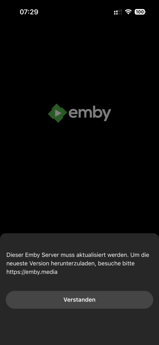

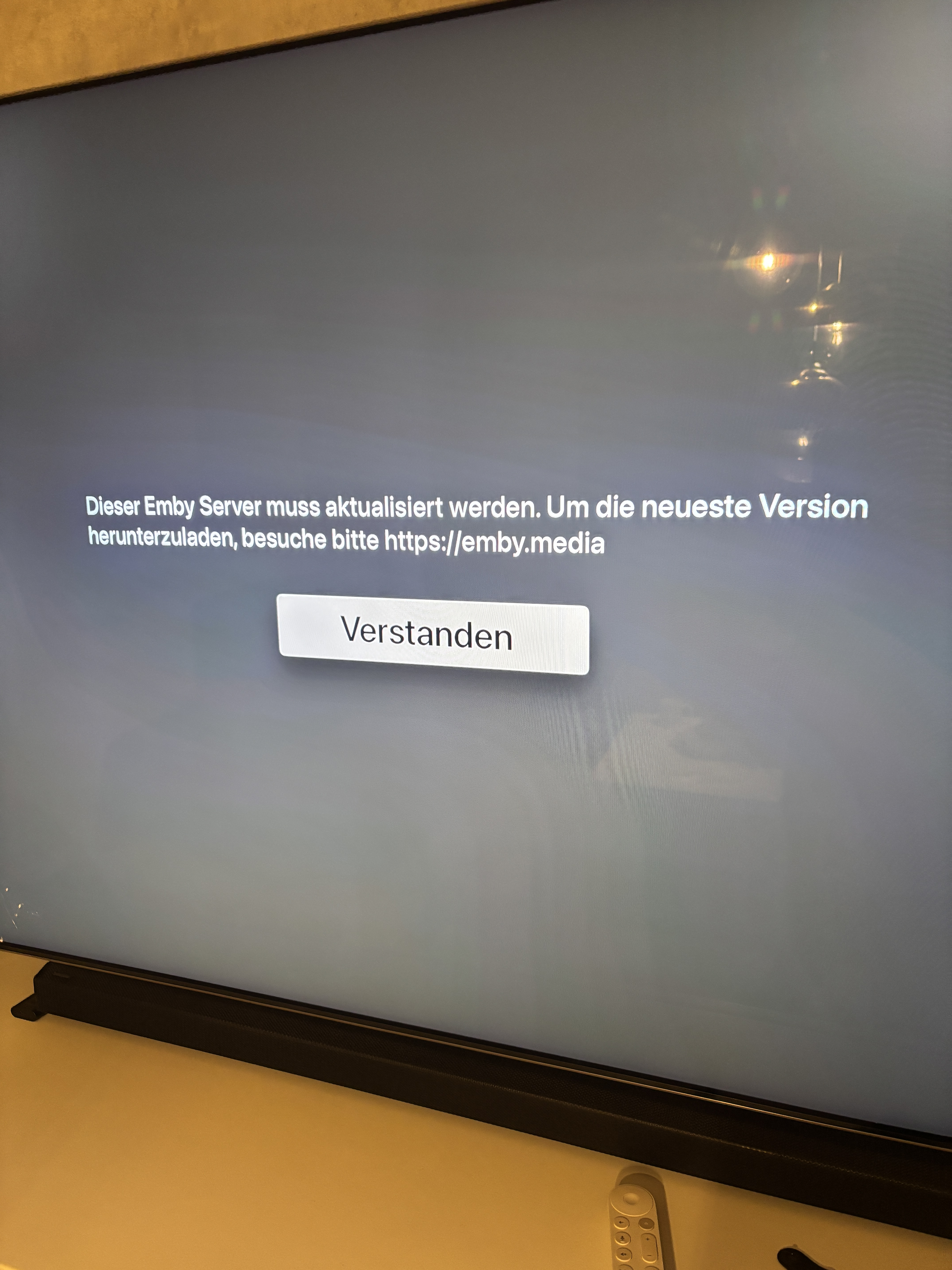

Babatom 11 Posted January 16 Posted January 16 Hi, ich teste gerade Emby, Server ist auf Unraid installiert mit Portmapping 8099:8096 weil Jellyfin schon auf 8096 läuft. Sobald ich die App schließe iOS & tvOS bekomme ich immer den Fehler "Server muss aktualisiert werden" und er zeigt mir die "ServerIP :8096" an obwohl ich beim einrichten ja Port 8099 angegeben habe. Ist das ein Bug oder mache ich was falsch? In den Server einstellungen unter Übersicht zeigt er mir auch an : Heimnetzwerk-Zugriff (LAN): http://10.18.2.2:8096.

Babatom 11 Posted January 17 Author Posted January 17 (edited) It happens with both the internal IP address and my domain. When I connect to the server with the internal IP address, I choose port 8099; for the domain, I don't specify a port. The connection works. As soon as I close and reopen the app, I get the error "The server needs to be updated." When I go to the info, I see that port 8096 is saved. Edited January 17 by Babatom

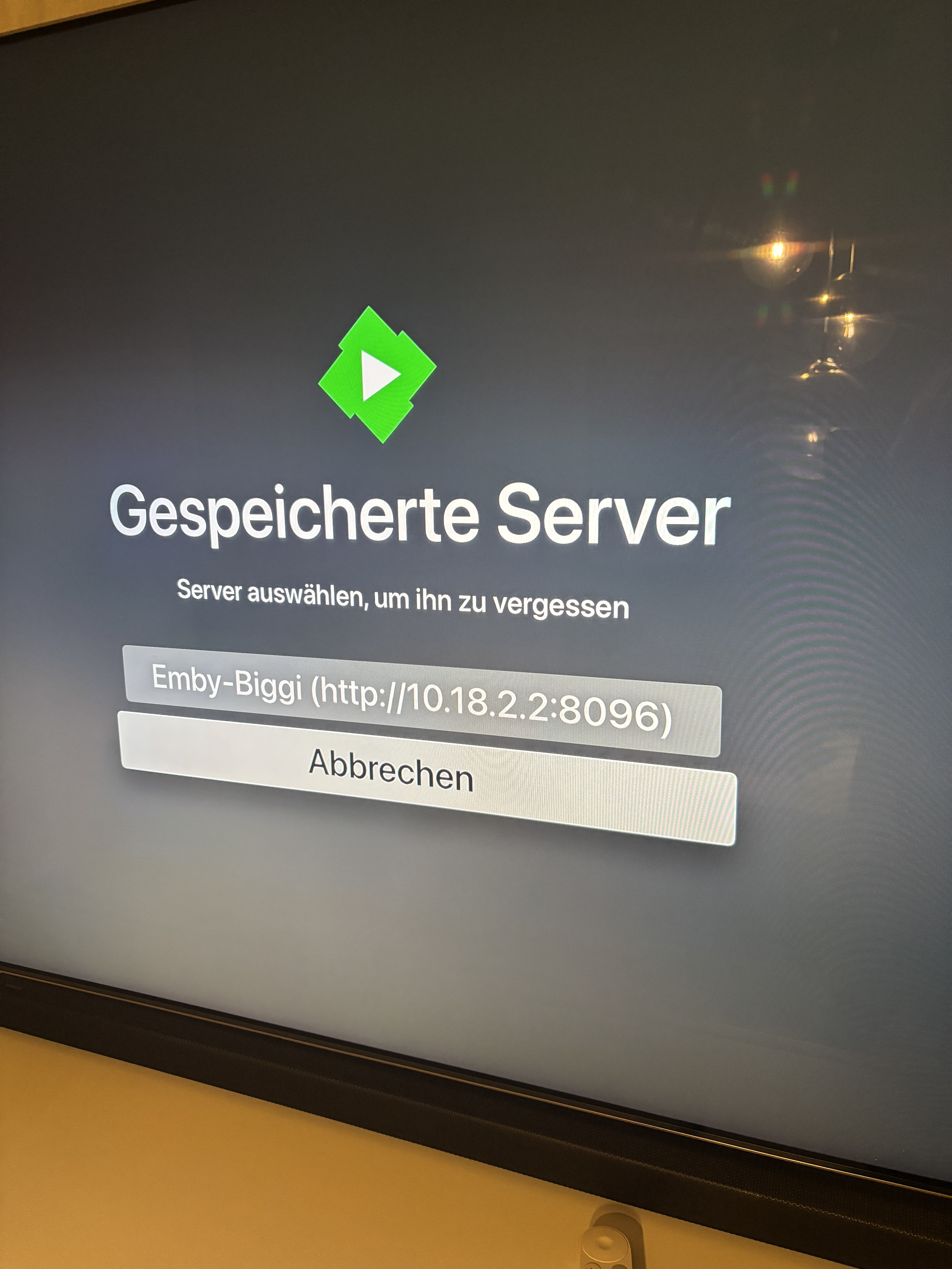

Babatom 11 Posted January 17 Author Posted January 17 Come on... forget the domain. I connect to 10.18.2.2:8099 and it works. If I close the app and reopen it, I get the error. If I go to "forget this server," I see that 10.18.2.2:8096 is saved. Then I delete the server and enter 10.18.2.2:8099 again, and it works again.

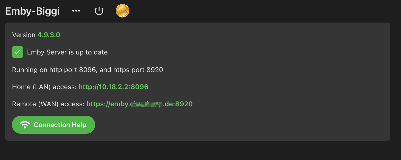

Babatom 11 Posted January 17 Author Posted January 17 No. The LAN address shows port 8096, and the WAN address shows HTTP, not HTTPS. Under settings-network-external domain, I've entered the correct subdomain with https://. (The external connection works.)

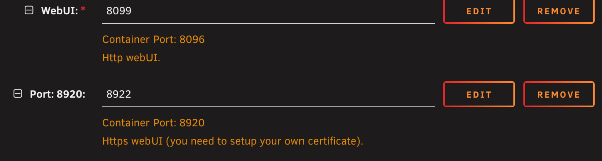

Babatom 11 Posted January 20 Author Posted January 20 Sorry, but I don't quite understand. In the Unraid template, I've set the port mapping to 8099:8096 for HTTP and 8922:8920 for HTTPS. Local access works with internal_ip:8099, and externally I'm using a subdomain and a reverse proxy(caddy), with the subdomain pointing to internal_ip:8099. I have now set the following in the Emby network settings: local HTTP port 8099 and external HTTP port 8099. Now I can no longer access my server.

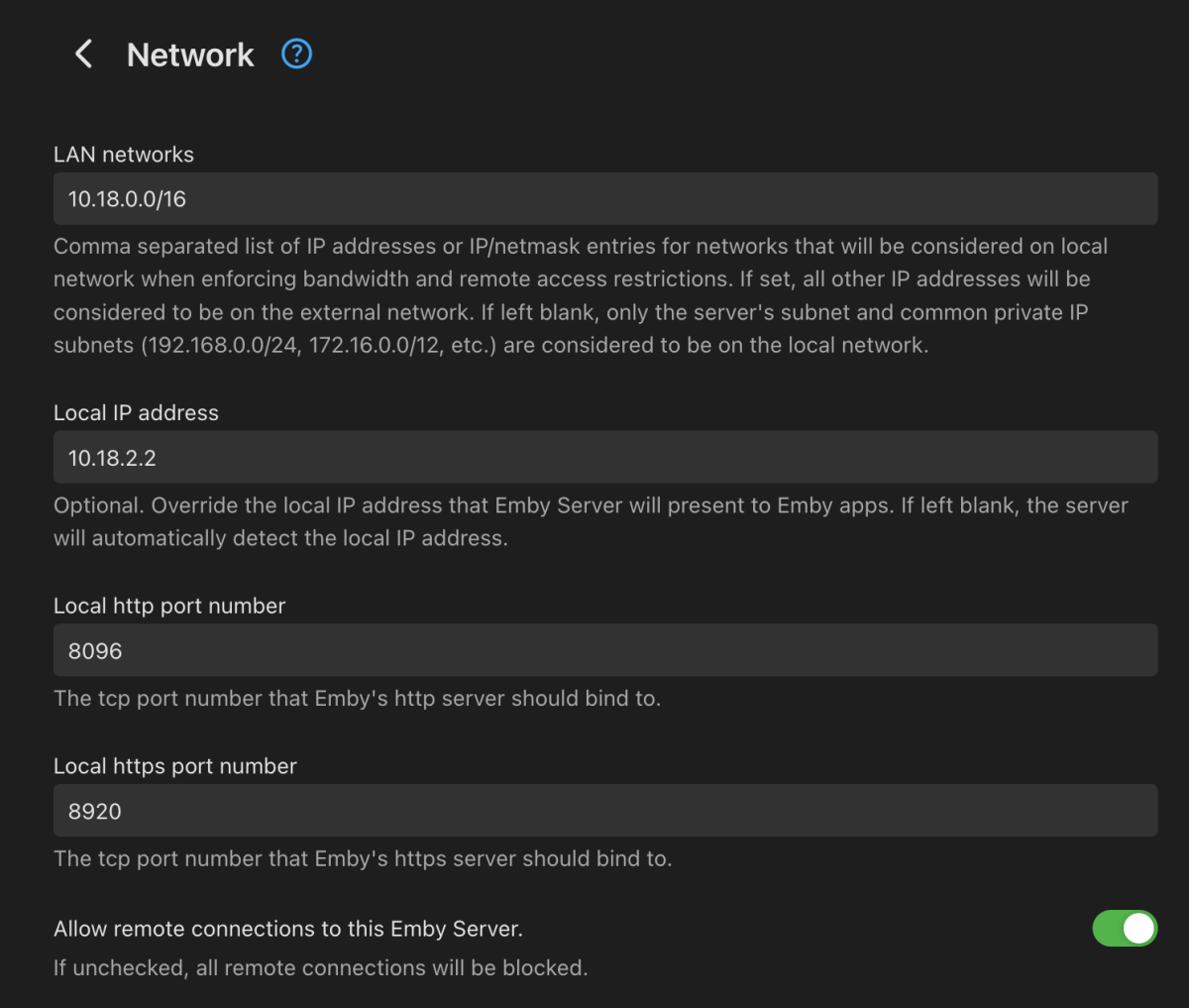

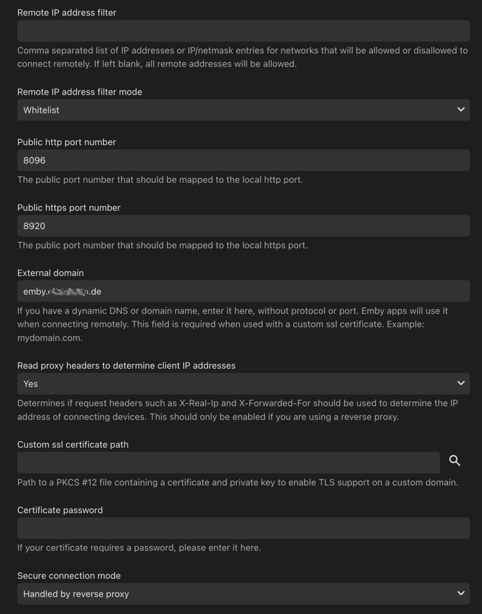

Babatom 11 Posted January 21 Author Posted January 21 Ich bekomme das Problem nicht in den Griff. Habe mal meine Netzwerk Einstellung gescreenshottet, vielleicht sieht jemand den fehler! Ich kann mich Intern einloggen mit 10.18.2.2:8099 Von extern geht es mit emby.meinedomain.de Beides funktioniert bis ich die App komplett schließe, dann kommt immer der Fehler aus Post #5. ( iOS & tvOS ) emby.meinedomain.de wird von Caddy (VPS) auf 10.18.2.2:8099 geroutet, habe CGNat deswegen ein VPS. ----- Ich habe außerdem Emby Connect probiert, mein Admin Account mit meinem Emby Account verbunden. Dann einen neuen User erstellt, vorher für diesen ebenfalls einen Emby Account angelegt und dann eingeladen. Der User verbindet sich auch und ich sehe meinen Server aber wenn ich darauf klicke bekomme ich wieder "Verbindung zum Server nicht möglich". ( Diese Verbindung soll auch von extern erfolgen )

Babatom 11 Posted January 22 Author Posted January 22 As you can see in my screenshot of the Unraid template, I'm mapping port 8099 to 8096. So, when I want to connect to Emby, whether via the app or browser, I use port 8099. The Emby dashboard shows port 8096. When I connect to Emby via a domain, again with the app or browser, I only use the subdomain without specifying a port, but the Emby dashboard does show a port number. A port MUST be specified in the network settings.
Luke 42237 Posted January 22 Posted January 22 Quote Now does the server dashboard display the addresses that you want to connect with? So yes? And what router ports do you want to use?

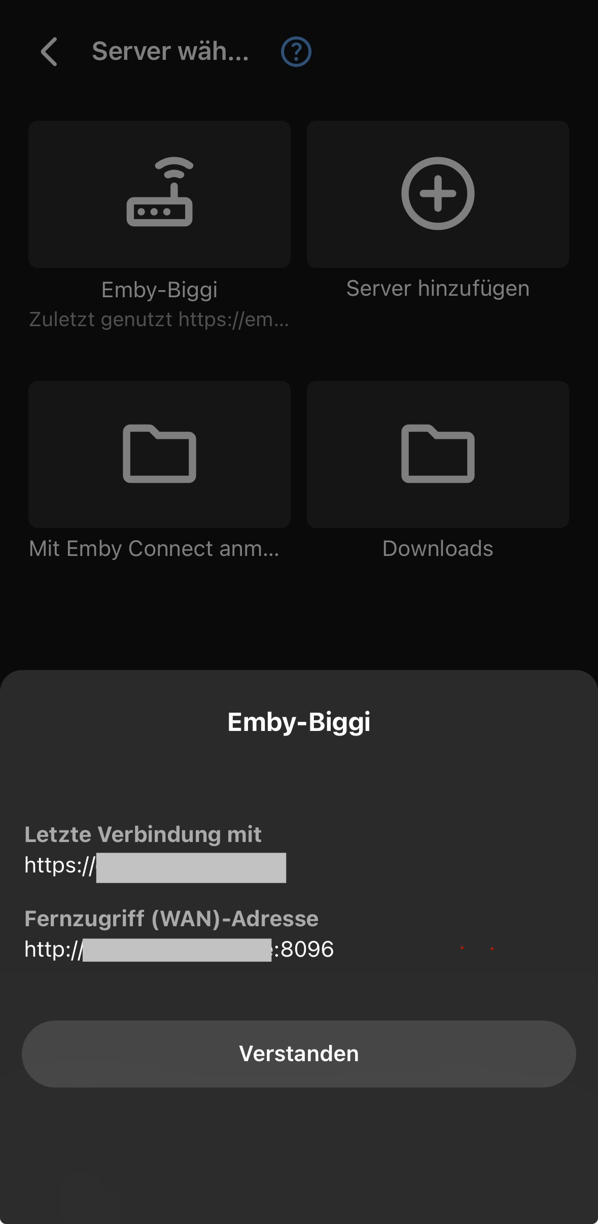

Babatom 11 Posted January 23 Author Posted January 23 @Luke Okay, I think it's a bug or a restriction with the Apple client apps. I tested the Emby app on Android TV and I don't have this problem there. No matter what server address I enter in Apple, it always tries to connect via port 8096 after restarting. The only solution for me is probably to disable port forwarding and use 8096. 18 hours ago, Luke said: So yes? Please take a look at the first screenshot from my last post. The address http://10.18.2.2:8096 is displayed there for LAN, and I see exactly this address every time I restart the app, even though I previously set up the server with http://10.18.2.2:8099. After restarting the client app, it simply ignores what I used previously. 18 hours ago, Luke said: And what router ports do you want to use? None at all; no ports are open on the router. The external connection goes through a VPS with a reverse proxy, which is connected to my Unraid server via WireGuard. emby.mydomain.com --> 10.18.2.2:8099
Luke 42237 Posted January 29 Posted January 29 On 1/20/2026 at 2:04 AM, Babatom said: Sorry, but I don't quite understand. In the Unraid template, I've set the port mapping to 8099:8096 for HTTP and 8922:8920 for HTTPS. Local access works with internal_ip:8099, and externally I'm using a subdomain and a reverse proxy(caddy), with the subdomain pointing to internal_ip:8099. I have now set the following in the Emby network settings: local HTTP port 8099 and external HTTP port 8099. Now I can no longer access my server. Hi, these are not Emby server settings. These look like TrueNAS container settings. It looks like you also want to set 8099 in the local port number field in emby server network settings.
Babatom 11 Posted January 29 Author Posted January 29 1 hour ago, Luke said: These look like TrueNAS container settings Unraid. 1 hour ago, Luke said: It looks like you also want to set 8099 in the local port number field in emby server network settings. I've now simply left Emby on port 8096 and assigned Jellyfin port 8099. This works flawlessly with all clients, both Emby and Jellyfin.

Babatom 11 Posted January 30 Author Posted January 30 1. Allow remote connections to this Emby Server must be enabled. 2. Enter the domain under "external domain" 3. "Secure connection mode" -> handled reverse proxy Thats works for me. The app only failed to save the changes when I changed the default port to 8096 in the container template, but the connection always worked for me.
