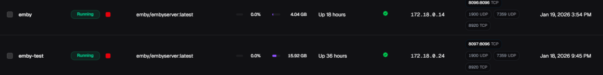

ryzilla 13 Posted January 18 Author Posted January 18 (edited) so, seems a little high still. 23.93 GB idle after (Uptime 38 hours) I've spun up another docker image from same version (non-premium) and no library / apps to see what happens with a base install. Edited January 18 by ryzilla

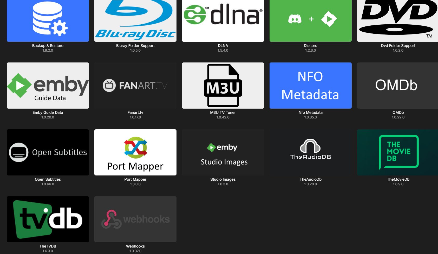

ryzilla 13 Posted January 19 Author Posted January 19 (edited) These are the only plugins i have and i think my reverse proxy is working fine, i dont see any errors when streaming from the web client Edited January 19 by ryzilla

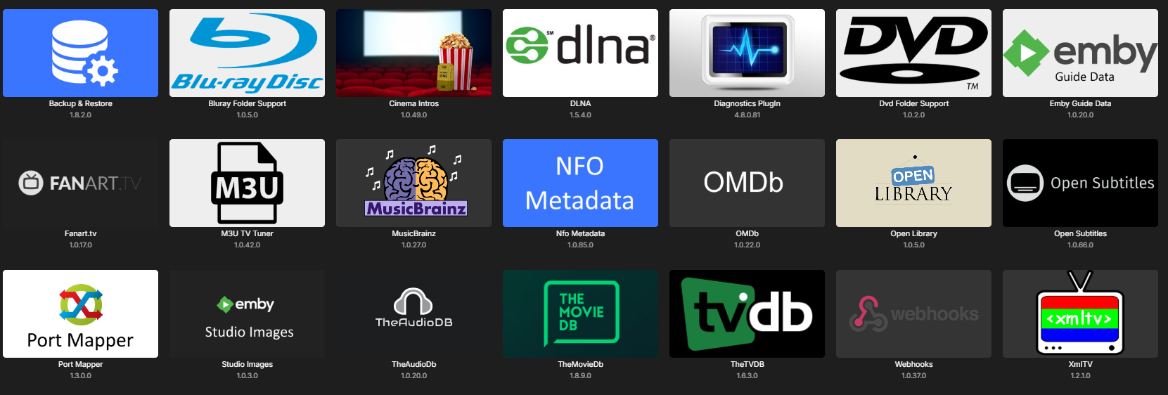

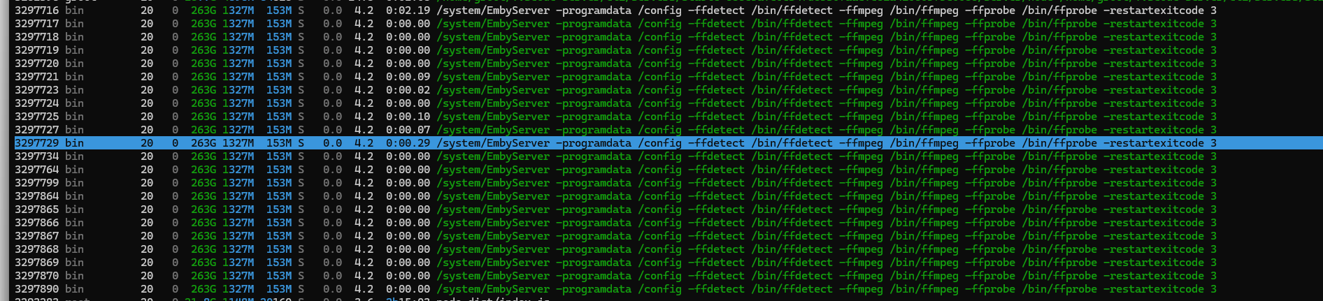

brothom 211 Posted January 19 Posted January 19 (edited) @ryzillawoah that's a lot of ffmpeg processes. Are you sure your system is idling? I also noticed you have an Emby + Discord plugin. Perhaps that's the culprit somehow? Perhaps this plugin getting into a loop or so? Can you also try running the Emby Server locally, without a network connection or so? Maybe this is caused by some kind of spam traffic. Additionally The plugins I'm running are: Edited January 19 by brothom

ryzilla 13 Posted January 19 Author Posted January 19 4 hours ago, brothom said: @ryzillawoah that's a lot of ffmpeg processes. Are you sure your system is idling? yep zero active streams, maybe something is getting stuck?
yocker 1414 Posted January 19 Posted January 19 15 hours ago, ryzilla said: not sure if thats a issue while idle? That's normal. 1

brothom 211 Posted January 20 Posted January 20 8 hours ago, yocker said: That's normal. Excuse me? Look at how much RAM those idle processes are using? Why is ffmpeg being started by Emby if there's nothing to do? 6 hours ago, ryzilla said: Think if found the issue but not the fix On both my test instance and prod instance have the same issue. 300MB memory usage, play tv show 30sec stop close window, 700MB usage and won't go down. repeat again and again and the ram keeps going up and up and wont go back down again until i restart the container. The only reason for so many processes I can think of, is that Emby is creating Thumbnails, Video Previews, etc. But that shouldn't result is so many ffmpegs running tho. Do these ffmpeg processes also keep running and hogging up more and more memory? Do these processes also appear when nothing is being streamed, like I said before, maybe check to see what happens if you run it without an internet connection.
yocker 1414 Posted January 20 Posted January 20 1 minute ago, brothom said: Excuse me? Look at how much RAM those idle processes are using? Why is ffmpeg being started by Emby if there's nothing to do? That does not show ram usage per ffprobe process, if i remember htop right it shows Emby using 1327MB of memory in that picture. It was discussed in another thread i can't remember the name of why htop shows that amount of ffprobes, what you see in that screenshot is normal.
