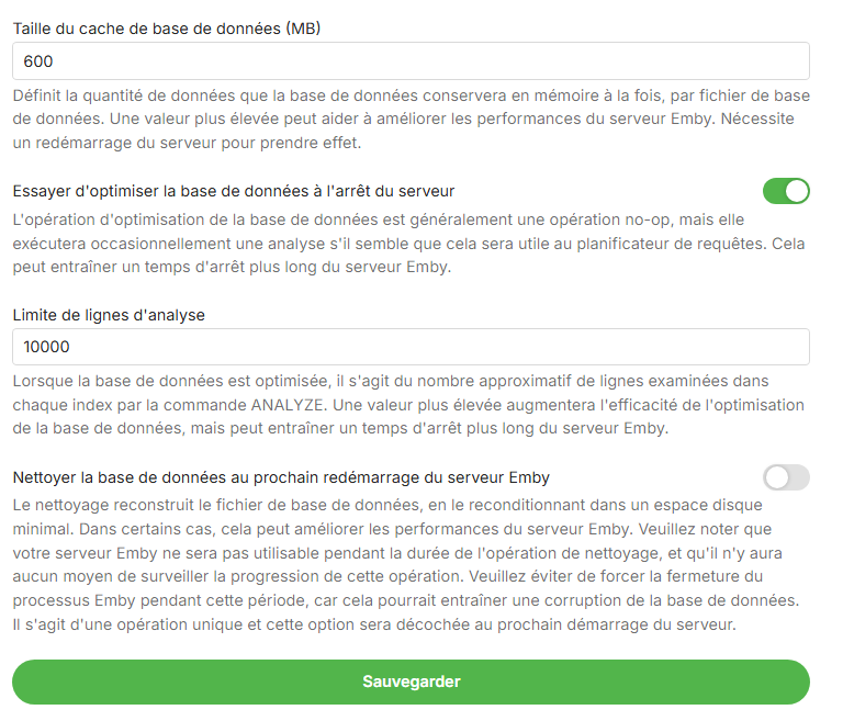

MAX92 93 Posted January 15 Posted January 15 Bonjour, Pour un serveur en I5 avec 16Go de mémoire qui est uniquement pour EMBY, j'ai mis cela : Qu'en pensez-vous s'il y a des experts ? Merci
Solution sa2000 695 Posted January 15 Solution Posted January 15 (edited) @MAX92I would suggest keeping the database cache as default with a value of 128Mb. We now have multiple database connections and each would try and have cache of that size. So run with 128Mb and you could experiment by gradually raising it and see how the server performes and if there are in any issues with excessive memory use Run at 128Mb and you can experiment with gradual increates, going to 192Mb and trying that for a week and then increase further to, say, 256Mb I do not recommend running with a high value of 600Mb Edited January 15 by sa2000
