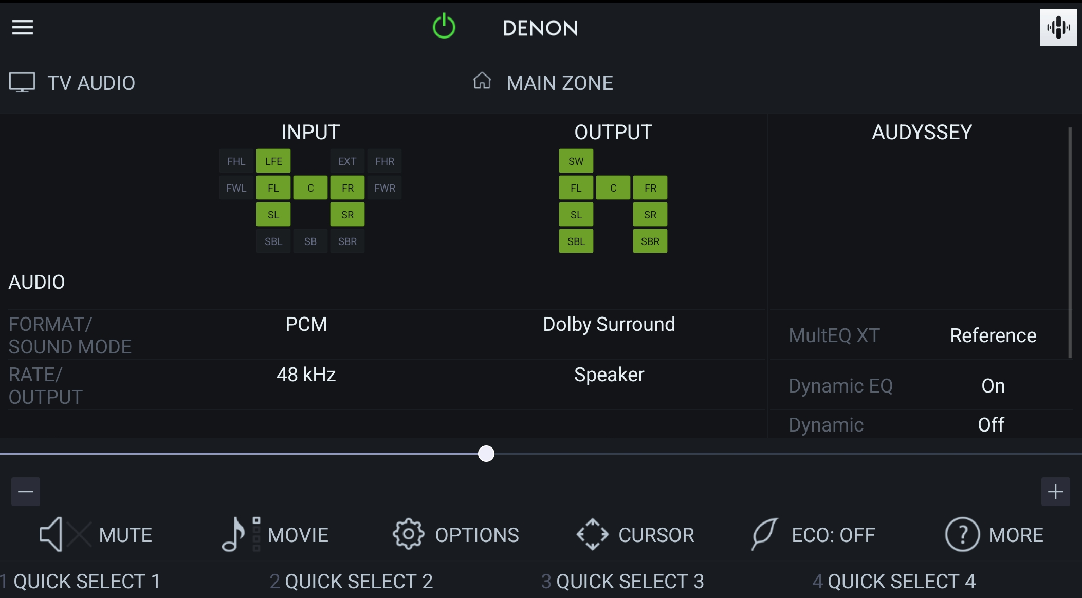

visproduction 381 Posted May 18 Posted May 18 I see that PCM also seems to be listed as surround. I have not seen that used before. I wonder if the Firestick is just expecting to see a different audio file type before it turns surround on. Your Denon screen shows PCM 5.1 and output to Dolby 7.1. Does it just create the missing 2 channels? Maybe that setting is throwing it off and it defaults back to Stereo.
TMCsw 323 Posted May 18 Posted May 18 off-topic -- TL;DR 45 minutes ago, visproduction said: Your Denon screen shows PCM 5.1 and output to Dolby 7.1. Does it just create the missing 2 channels? Yes it is but that is because I have set to do so (5.1 → 7.1).It is receiving a PCM 5.1 stream and using DSP to enhance it. (There was a time when DSP sucked (comb filters etc.) ) I really don’t know how it works but there must somehow be a channel ID (l,r,c,sr...) embedded in each PCM channel. As I said I normally use my Fire Cube as it does pass-through.. The only time(s) I use the TCL is because it handles ATSC 3.0 c./w DRM and one of the channels broadcasts FHD with DV(HDR) 1
