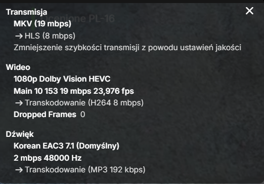

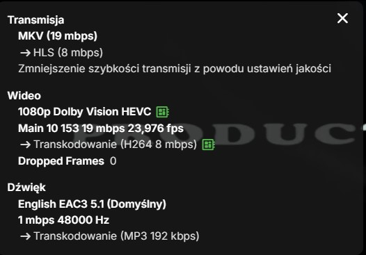

Reaper47 13 Posted January 12 Posted January 12 Hi. I'm running Emby in Docker on Debian. I'm using Intel i5 8500 with QuickSync for transcoding. I had everything configured nicely and working on previous Emby version. After updating to 4.9.3.0 it stopped working. On Transcoding page it shows as if hardware acceleration is available: Spoiler But once I start playback it falls back to software: Spoiler On the other file I tested "Stats for Nerds" showed HW transcoding icon, but there was no tonemapping and in logs I can see it is falling back to software: Spoiler Playback was on Emby Web in Brave browser. Logs attached. 2_ffmpeg-transcode-88b65a00-b581-4570-a4ae-ded178385be6_1.txt embyserver.txt 1_ffmpeg-transcode-90f88052-ff1d-44af-aca3-f6f2b6dcf317_1.txt

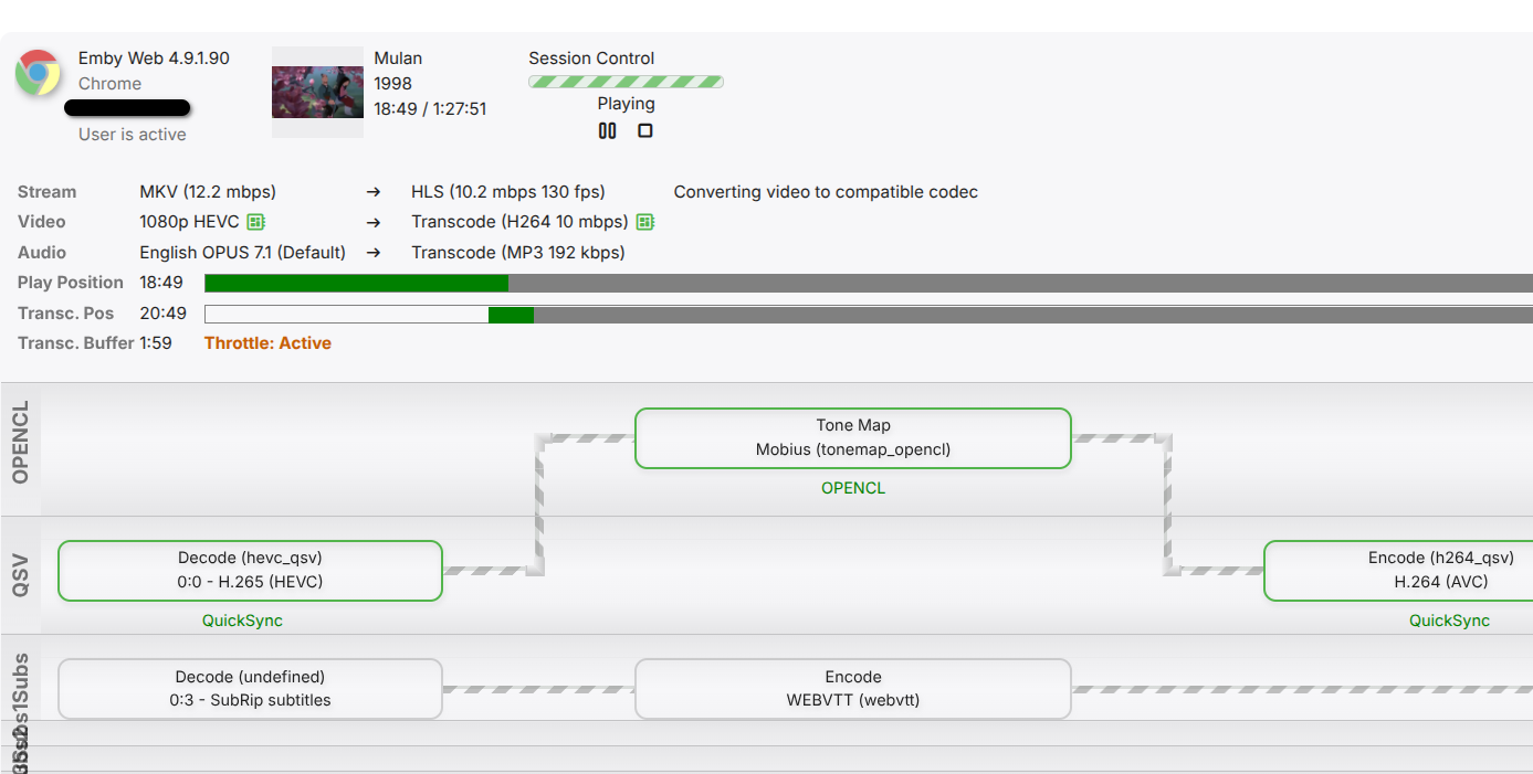

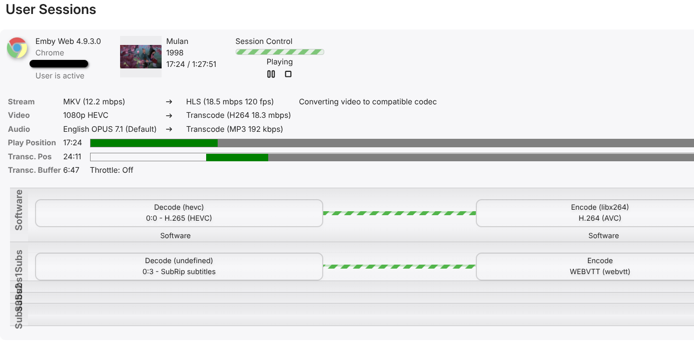

Q-Droid 1011 Posted January 22 Posted January 22 (edited) I can confirm this. Also on a Coffee Lake CPU, i5-9600k and release 4.9.3 stable falls back to software transcoding. Edit to add: So far this is with HDR content. HW works when tone mapping isn't needed. This one is the previous stable release - 4.9.1.90: This one is the current stable release - 4.9.3.0: Edited January 26 by Q-Droid

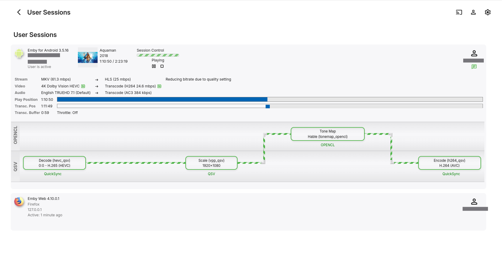

Reaper47 13 Posted January 29 Author Posted January 29 For 4.10.0.1 beta there is a temporary fix for this using Diagnostic Plugin: Not marking this as a solution yet, since I haven't tried it for 4.9.3.0 (running 4.10.0.1 beta at the moment), but if anyone uses 4.9.3.0 and has this issue, please try this and report.

Q-Droid 1011 Posted January 29 Posted January 29 45 minutes ago, Reaper47 said: For 4.10.0.1 beta there is a temporary fix for this using Diagnostic Plugin: Not marking this as a solution yet, since I haven't tried it for 4.9.3.0 (running 4.10.0.1 beta at the moment), but if anyone uses 4.9.3.0 and has this issue, please try this and report. No dice. HDR to SDR still falls back to software transcoding.
