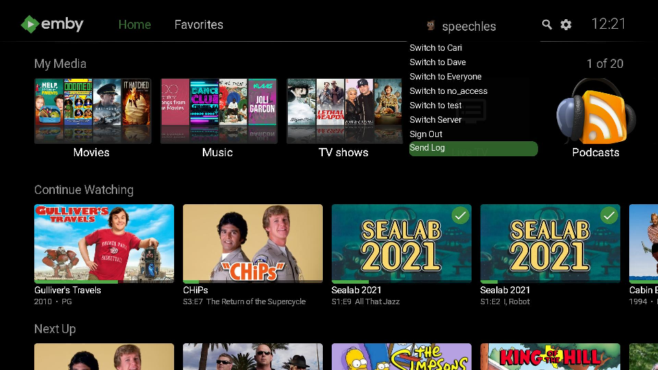

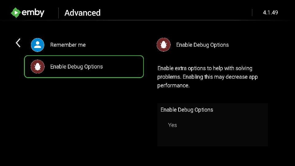

speechles 2062 Posted January 12 Posted January 12 (edited) @redkatt Apologies. We would need to see Roku device logs to see why that happened. There should never be crashes in the app. Especially during video playback. To send us logs you would need to do a few things. First you press the "star" * button on the Roku remote when on the home screen. It will open the settings. Click on settings, then Advanced. You will wind up on the screen above. Make sure the enable debug options says yes. Once it does, just press HOME on the Roku remote. The Emby app needs to restart to have the send log option appear on the home screen. Afterwards, you will see this option appear when you click on your username at the top of the home screen. Now you can recreate the crash. Once it crashes, great. The information from the last exit is retained. If this last exit was a crash we can know what happened. Then open the Emby app and go right to the send logs option. Click it and it should tell you it has sent it to developers. Once you've done that come back here and give us the time in EST and the username logged in when it was sent. Then we can likely fix this very promptly. Thanks. Edited January 12 by speechles
