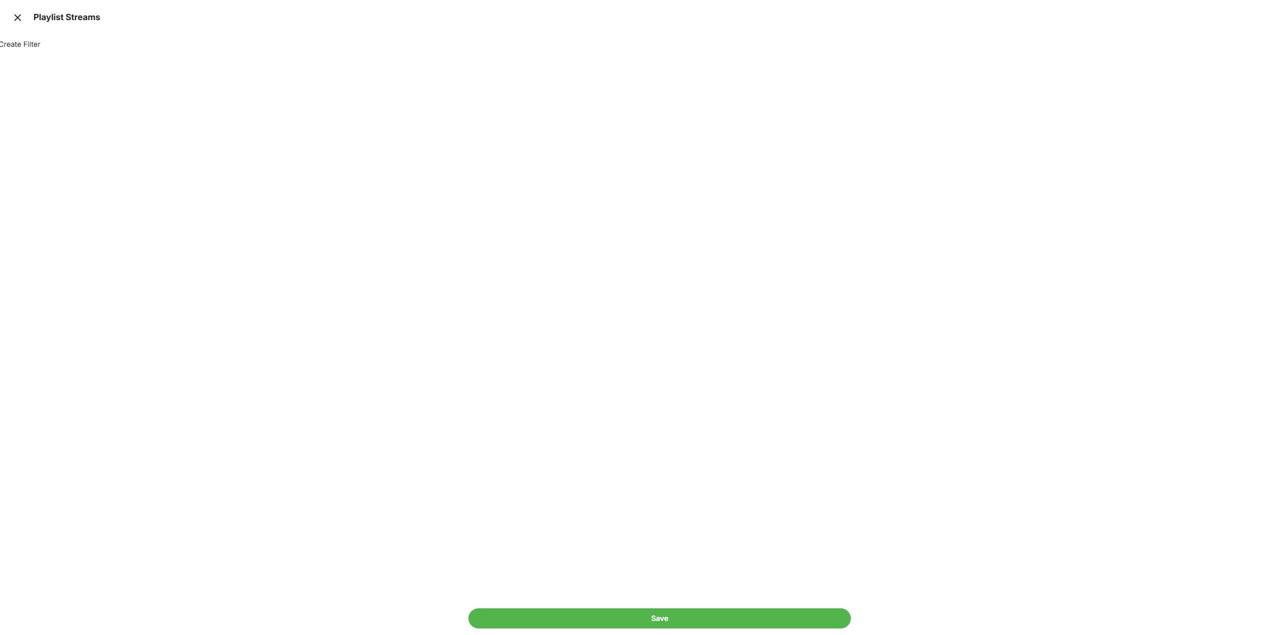

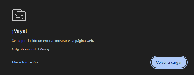

Lalico 3 Posted January 11 Posted January 11 Hello. I’ve just installed this plugin, but I can’t get it to work — I always get an error when I try to apply a filter. I’m attaching a screenshot. Am I doing something wrong? After that error appears, I can’t do anything else with the plugin — I have to restart Emby to try again.

Lalico 3 Posted January 14 Author Posted January 14 @softworkz I’m testing it locally, on the same machine where the server is running, and also locally from another computer. I tried different browsers and there was no way to make it work. It only worked when I started removing lines from the m3u. The strange thing is that I reached a number where it seemed to work — in fact, it let me create several filters — but now it no longer works. With the same playlist and without changing anything, it just gets stuck and I have to restart Emby. The group creation screen goes blank and it doesn’t let me do anything. @Luke Which log file would be needed? Now that it has let me create some groups, I was able to test how it works, and honestly it looks pretty bad. It lets me watch for a few minutes and then it stops; it stays frozen for one or two minutes and then starts again for a few more minutes until it stops again, and this keeps happening constantly. It’s not a playlist issue because I use Smartes IPTV Pro and it works perfectly there.
Lalico 3 Posted January 14 Author Posted January 14 I’ve already read which file was needed; I’m attaching it here right after trying again and when the screen gets stuck like this: What’s strange is that after removing many lines from the m3u, it finally let me create several filters, and now suddenly it won’t let me anymore and the screen goes blank when I try… embyserver.txt

Solution softworkz 5133 Posted January 15 Solution Posted January 15 31 minutes ago, Lalico said: This last m3u that worked at the beginning has 83,000 entries; the original one that causes the big error from the start has 2,621,643. Holy ***, I've never come across nor even heard about an m3u having 2.5M items. What you are seeing aligns with our testing: Item counts up to 100k are handled well. To be honest, I've never even spent a thought about cases with multi-million entries. The point is that it's not just the client UI filtering operation which can't handled this, but it applies to everything that is involved from parsing to updating to item updating in the server, metadata retrieval etc. etc. It's not designed to handle such amounts of items and I'm afraid to say that there's no change to be expected in this regard, other than erroring with a clear message instead of failing unexplained like now. Thanks and sorry! 1
