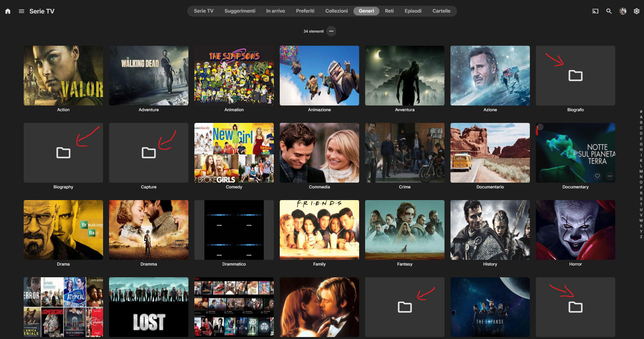

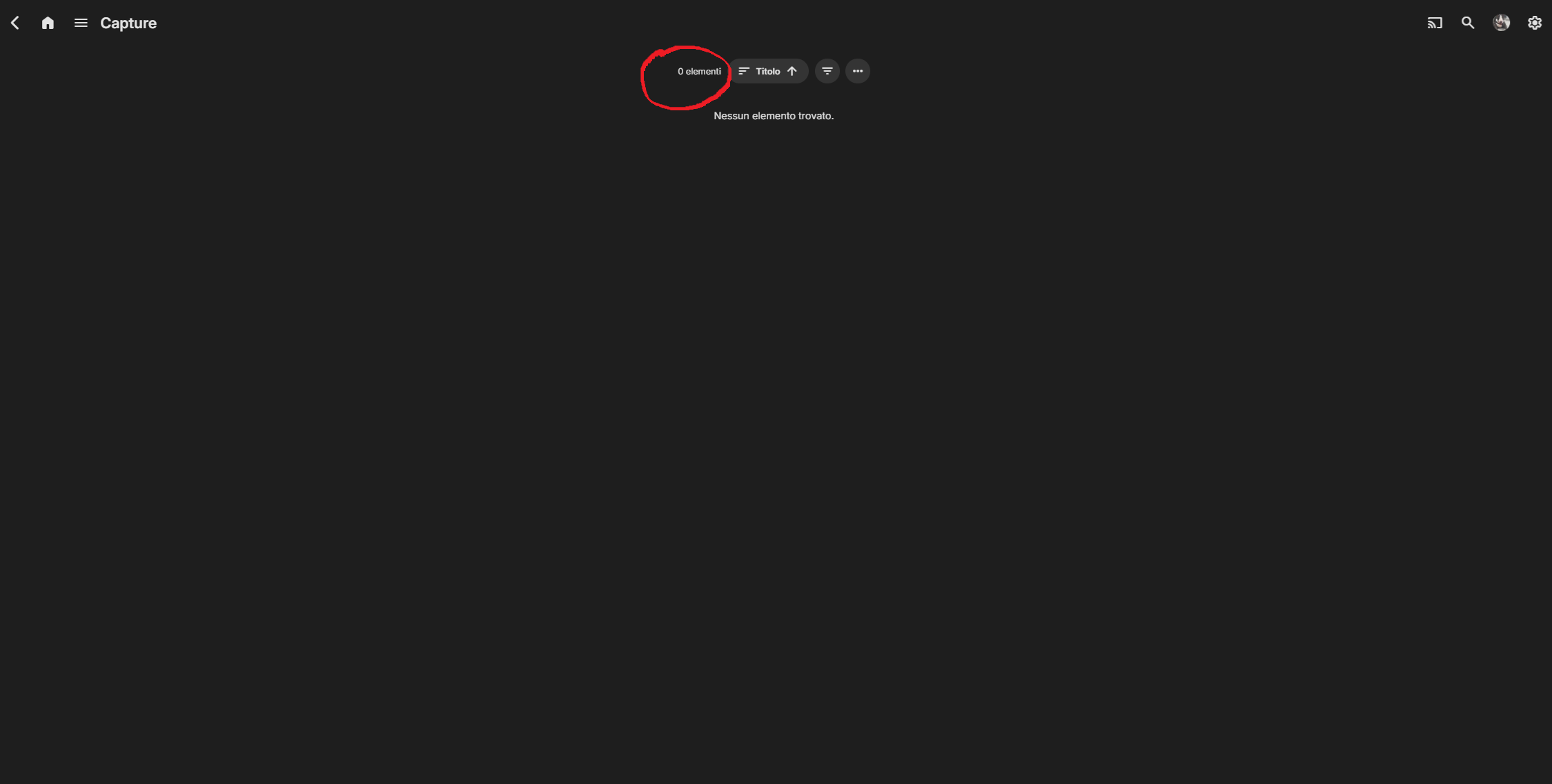

Hispanico957 23 Posted January 9 Posted January 9 (edited) I don't know how or why but if I go to view the TV Series genres, genres appear that don't exist and if I go inside they are empty. How can I delete and not show these? Thank you Hispa Edited January 9 by Hispanico957
Neminem 1630 Posted January 10 Posted January 10 @Hispanico957do you see a play button when you mouse over the empty genre? If you do you can see that the playing episode has genre in metadata. I suspect that Emby for some reason has started to import genre's from single episodes. 1
Hispanico957 23 Posted January 10 Author Posted January 10 (edited) 36 minutes ago, Neminem said: @Hispanico957do you see a play button when you mouse over the empty genre? If you do you can see that the playing episode has genre in metadata. I suspect that Emby for some reason has started to import genre's from single episodes. Yes is true...i search also in metadati of SerieTv, but there is not to change this strange import Now that we found this bug how i can fix ? Thnak Hispa Edited January 10 by Hispanico957
Neminem 1630 Posted January 10 Posted January 10 (edited) Devs would need to answer that But I went into every episode and removed genres from them. That fixed it for me, I have not seen the issue after. TBH it was a lot of work. Clicking play on genre, to see what episode to edit. Edited January 10 by Neminem 1

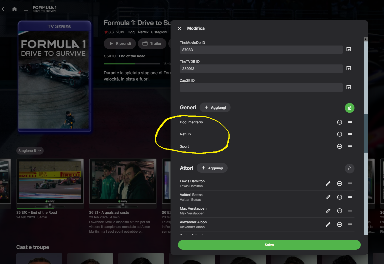

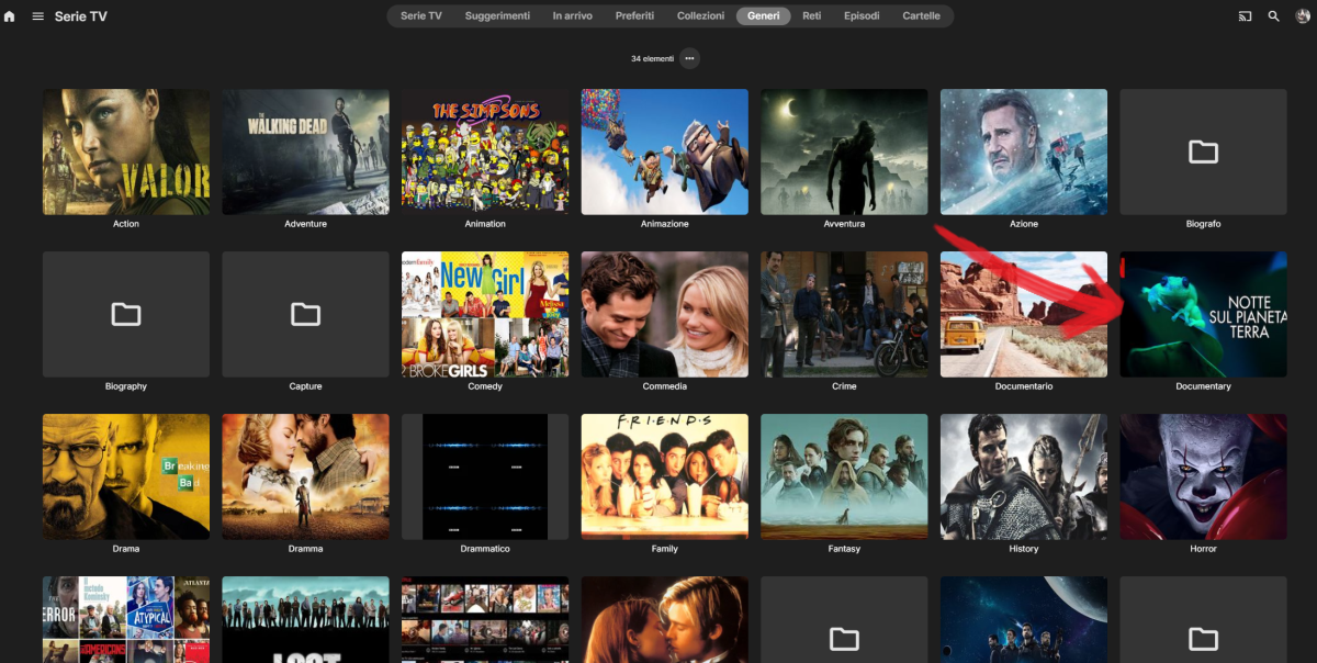

Hispanico957 23 Posted January 11 Author Posted January 11 I verify again with different case: - screenshot 01 where appear this generes "Documetary" callod "Notte sul Pianeta terra". This Tvseries or movie not exist on my nas. I play cliking on video arrow and play Tvseries "Formula 1 Drvi to survive" ??????? - scrrenshot 02 i click on TVseries "Formula 1 Drvi to survive" and not Documentary genres appear. I delete anyway all genres and it appears the same !!!!! I hope staff solve this BUG Thank Hispa 1

cochize1 55 Posted January 15 Posted January 15 Just to chip in. I also noticed that problem that some empty genres are generated and even random episodes/series are played when right-clicking Play on that folder. It is probably because episodes within the series have that genre listed and not the series itself. To help my locate that files I wrote a python script that scans your library nfo and list all nfo's that has given genre. In my case, that was 'Sci-Fi'. I have also 'Science Fiction' and 'Sci-Fi & Fantasy' but the 'Sci-Fi' folder was empty but present. What I did was find the episodes with that tag and added 'Sci-Fi' to the series itself so it would not be empty. Still a bug, but worked around it. Here is the script.scifi.py 1

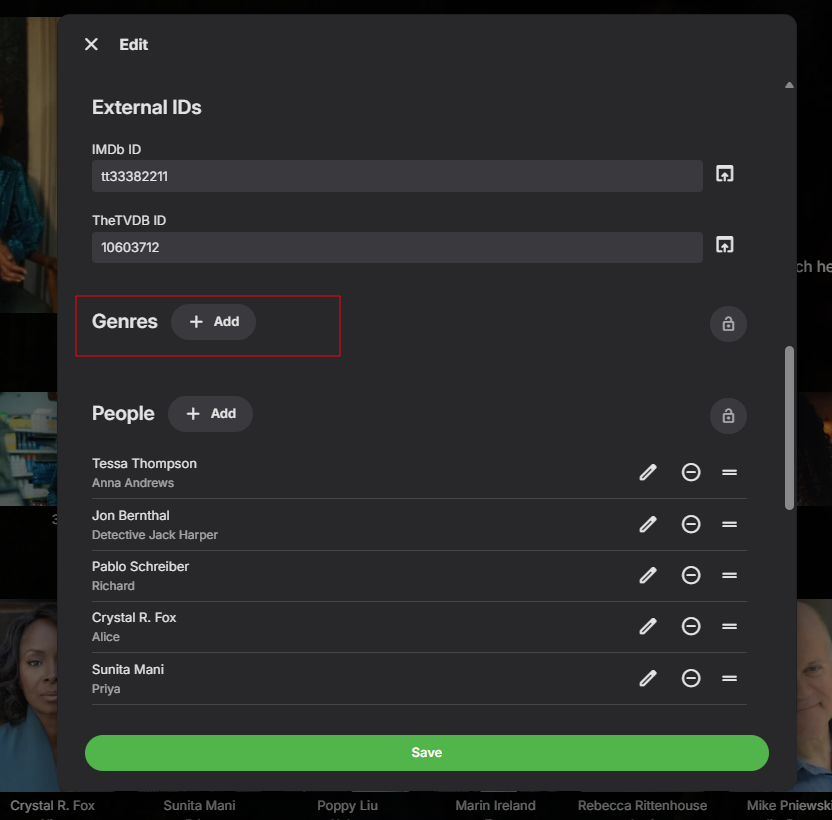

Hispanico957 23 Posted January 19 Author Posted January 19 (edited) But after editing the .nfo file, do you have to lock the series to prevent the metadata from updating? Should the lock be green or black? Thank Hispa P.S. I hope STAFF FIX IT as soon as possible because It's really time consuming and tedious to sort out all the nfo files. wrong Edited January 19 by Hispanico957
cochize1 55 Posted January 19 Posted January 19 If you edit genre in emby itself I believe it locks itself automatically and stays that way. If you edit nfo manually I think you need to run either Scan Library or Scan Metadata Folder but this will not lock the genres and will change should you ever hit refresh metadata for this series (or had it set to refresh i.e. every month in library settings). What I did, i didnt delete unnecessary genres one by one, i just added the given genre (Biography or Sci-Fi) tp the show that had at least of it's episodes under that genre. Believe it was much faster that way. 1
Hispanico957 23 Posted January 19 Author Posted January 19 Okay understand ...but only for infomation the lock on geners must be green or black to blocked updates ? Thank again Hispa
