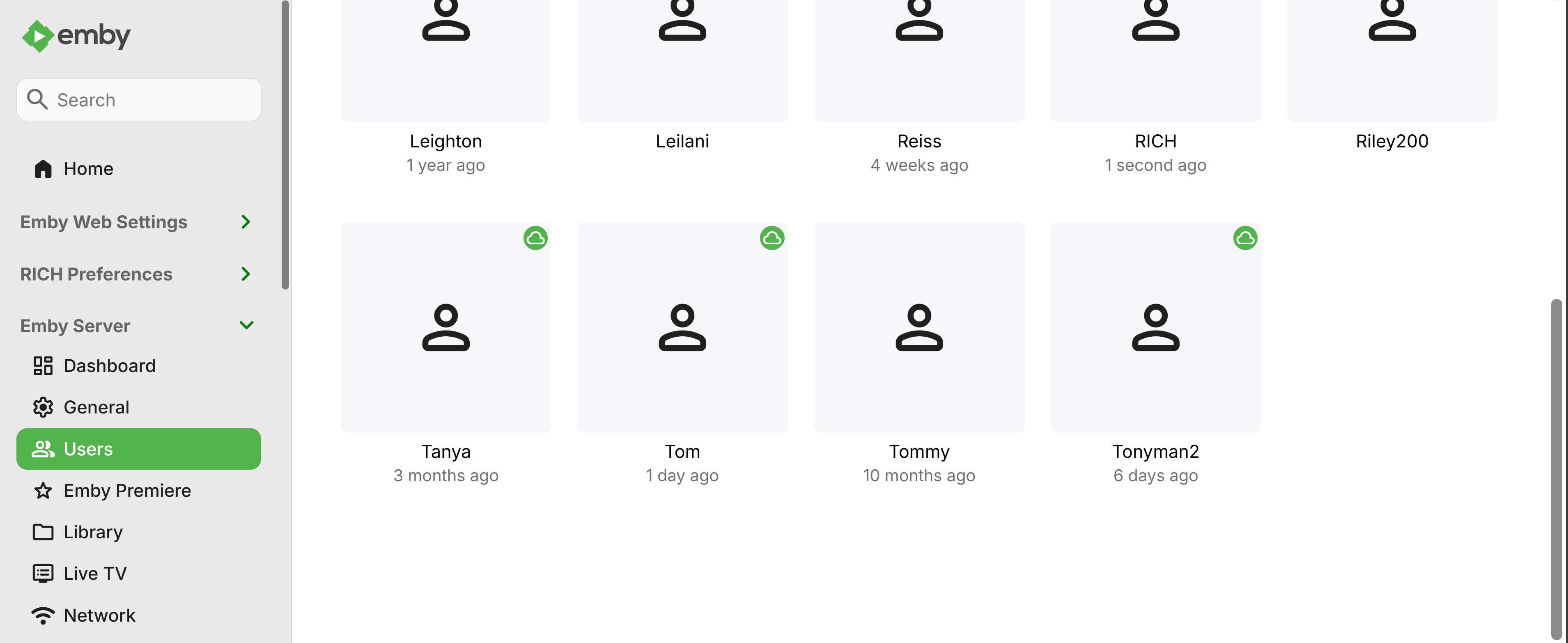

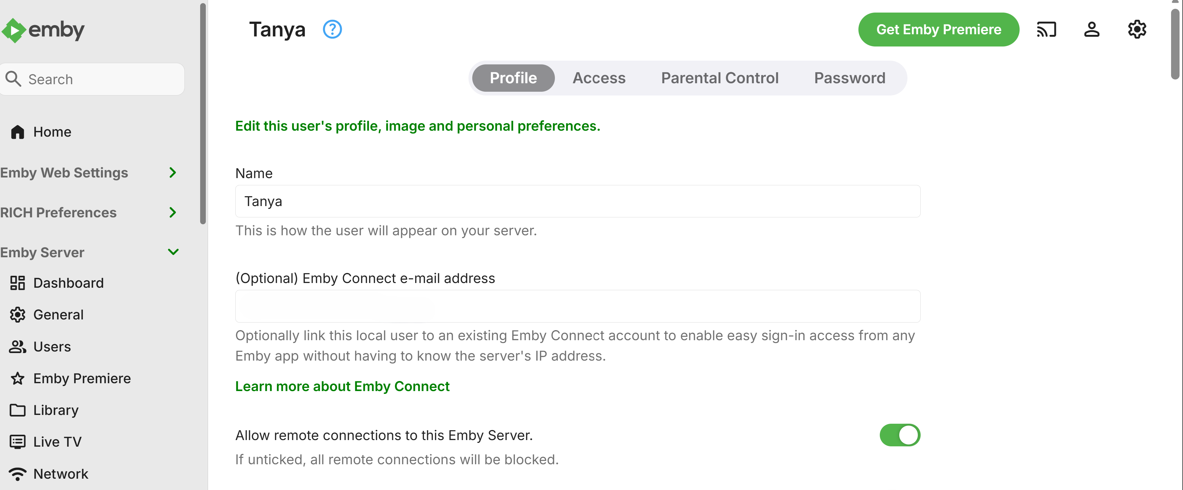

rcsnoopdog 11 Posted January 9 Posted January 9 (edited) Hi everyone, I run an Emby server on my Windows PC and I’m trying to help someone connect remotely from their phone. Because I only ever see the server side, I don’t get to see what the remote user sees on their mobile app, so I want to confirm whether the instructions I’m giving them are correct. Here’s the situation: I’ve set up remote access for a friend, but they couldn’t log in on their first attempt. This isn’t unusual — in my experience, the first attempt rarely works for anyone I’ve set up before. I suspect the system may have been confused by their very long email address, so I’m trying a different approach. Below are the instructions I gave them. Could someone confirm if these are the correct steps for a remote user connecting from a phone? Instructions I Provided (no credentials included): Open the Emby app Tap “Add Server” (Ignore “Sign in with Emby Connect”) In the Server Address field, enter: emby.media If that doesn’t connect, try: http://emby.media Tap Next When prompted for login details, enter the assigned username and assigned password (not using email) but the username from the profile on Emby server Tanya as seen in picture , I have erased her email from this picture before i gave her email to login with this was my previous instructions that did not work ,, Here’s how to log into Emby on your phone or tablet: Install the Emby app - Open Google Play Store - Search for “Emby for Android” - Tap Install Open the app - Tap the Emby icon Sign in with Emby Connect - Tap “Sign in with Emby Connect” - Enter your email: xxxxxxxxxx (or it might ask for the display name, which is TanyaFamily) - Enter your password: - Tap Log In Connect to the server - Tap JACK RABBIT SLIMS - You’ll see movies and shows - tap to play If anything doesn’t work, message me and I’ll help this part I don't know were i got it from as (or it might ask for the display name, which is TanyaFamily) is the display name the one in the picture , i gave these instructions a long time ago and cant remember but if it is it seems i changed it or is display name something else If anyone can confirm whether this is the correct method — or if I should be instructing them differently — I’d really appreciate it. Thanks in advance. Edited January 9 by rcsnoopdog
Lessaj 484 Posted January 9 Posted January 9 (edited) If not using Emby Connect then they would have to enter your domain name or IP and the port number, not emby.media - unless you replaced your actual domain with that value, which is definitely understandable for posting on the forum. Then they would log in with the local credentials, which based on your screenshot is Tanya and whatever password you assigned. Edited January 9 by Lessaj

seanbuff 1356 Posted January 10 Posted January 10 35 minutes ago, rcsnoopdog said: I will try Emby connect again with her , was my original instructions to her good then ? Yes, your "previous" instructions for Emby Connect were fine. As long as Tanya has registered an Emby Connect account here: https://emby.media/community/index.php?/register/ You also need to add her email address to the (Optional) field on her local user account. After she installs the app, instruct her to login with Emby Connect using the email address and password that she used to register above and she will be presented with your server without needing to know any more details. That's it.
rcsnoopdog 11 Posted January 10 Author Posted January 10 3 minutes ago, seanbuff said: Yes, your "previous" instructions for Emby Connect were fine. As long as Tanya has registered an Emby Connect account here: https://emby.media/community/index.php?/register/ You also need to add her email address to the (Optional) field on her local user account. After she installs the app, instruct her to login with Emby Connect using the email address and password that she used to register above and she will be presented with your server without needing to know any more details. That's it. I set up the email for her like i did my family and registered her for emby connect and added email in optional , it even has green cloud over her name but it did not work the first time , she is in Ukraine and I am in the UK were the server is would this make a difference as i was under the impression it would not , she is able to download the app on her Samsung phone
Luke 42241 Posted January 10 Posted January 10 1 hour ago, rcsnoopdog said: I set up the email for her like i did my family and registered her for emby connect and added email in optional , it even has green cloud over her name but it did not work the first time , she is in Ukraine and I am in the UK were the server is would this make a difference as i was under the impression it would not , she is able to download the app on her Samsung phone HI, what exactly happened?

Luke 42241 Posted January 10 Posted January 10 3 minutes ago, rcsnoopdog said: I don't quite know as she is in Ukraine and other things came up but I did see my end that in the dashboard Failed Login Attempt from Tanya on JACK RABBIT SLIMS 05/11/2025, 10:29 185.220.100.255 Time Wednesday, 5 November 2025 10:29 As I say a lot has happened since then so never go round to dissecting it That means they tried to do a direct login to your server rather than signing in with emby connect.
rcsnoopdog 11 Posted January 10 Author Posted January 10 Just now, Luke said: That means they tried to do a direct login to your server rather than signing in with emby connect. Could you give me exact instructions for her , she will be using Samsung phone , I will fill in the details
seanbuff 1356 Posted January 10 Posted January 10 1 hour ago, rcsnoopdog said: Could you give me exact instructions for her , she will be using Samsung phone , I will fill in the details As I previously advised, your previous instructions were already correct (with the exception of the display name): Quote Here’s how to log into Emby on your phone or tablet: Install the Emby app - Open Google Play Store - Search for “Emby for Android” - Tap Install Open the app - Tap the Emby icon Sign in with Emby Connect - Tap “Sign in with Emby Connect” - Enter your email: xxxxxxxxxx (or it might ask for the display name, which is TanyaFamily) - Enter your password: - Tap Log In It is simply 4 steps: Sign in with Emby Connect Enter email address Enter password click 'Sign In' Use these instructions, and provide a more recent example if there is a failure. Good luck.
ebr 16334 Posted January 10 Posted January 10 10 hours ago, seanbuff said: It is simply 4 steps: Sign in with Emby Connect Enter email address Enter password click 'Sign In' Use these instructions, and provide a more recent example if there is a failure. Good luck. This is correct. Your original instructions were telling them to "skip" Emby Connect... 16 hours ago, rcsnoopdog said: Open the Emby app Tap “Add Server” (Ignore “Sign in with Emby Connect”)
