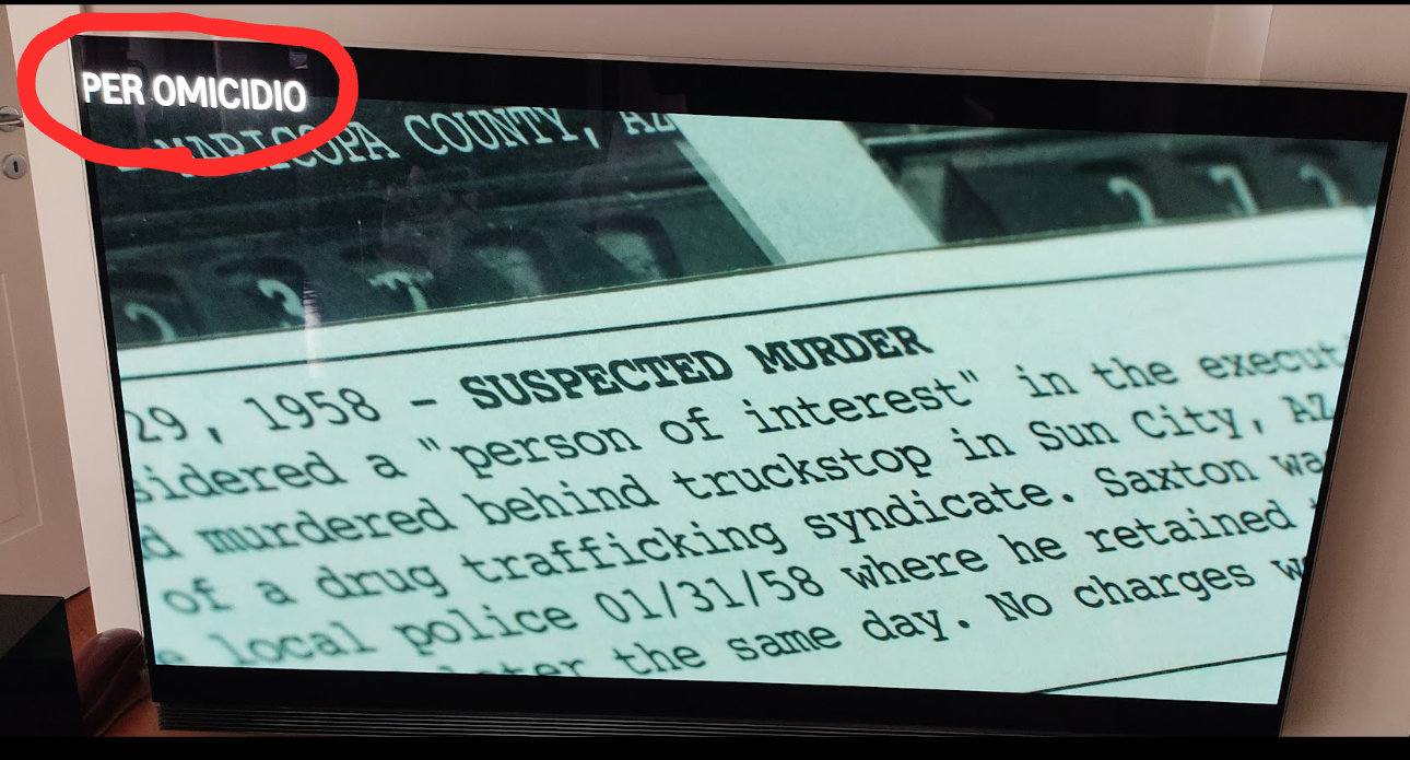

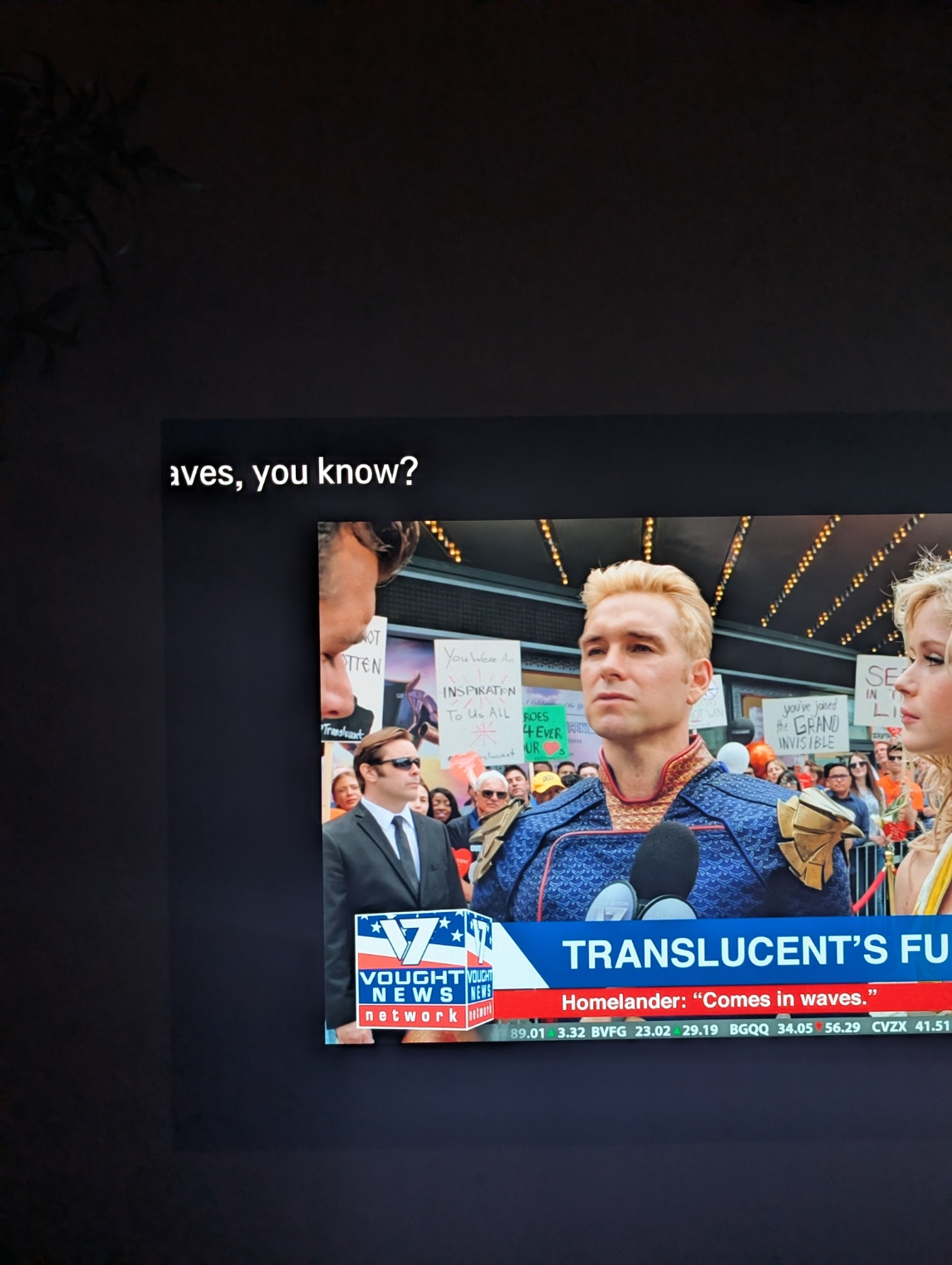

coolspot 22 Posted January 8 Posted January 8 My issue is somewhat different on 1.0.49 than the others. I have an older LG C17 model. My playback is working fine but the subtitles started going to the upper left corner after the update so I've had to turn off subtitles. I can't see the entire subtitle, just the last few words of sentences, etc. Hope that makes sense. 1
Luke 42231 Posted January 8 Posted January 8 @coolspot Hi there, let's look at an example. Please attach the information requested in how to report a media playback issue. Thanks!
seanbuff 1354 Posted January 8 Posted January 8 @coolspotplease also provide server logs as per link provided. Also detail the media info including subtitle format (eg. external or embedded? SRT or ASS, etc.) 1

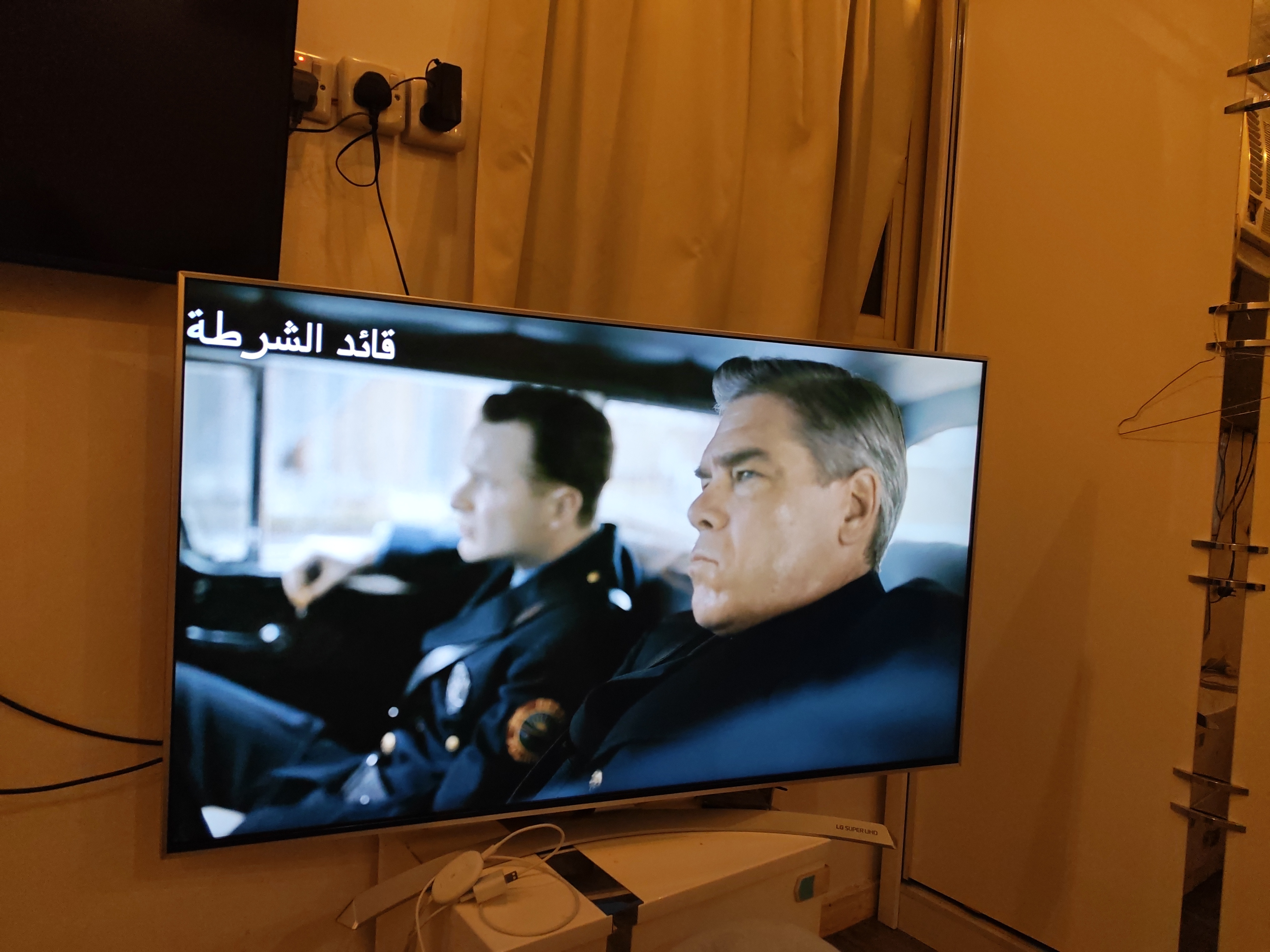

shafto 0 Posted January 24 Posted January 24 Hey there, Just registered to post that I too am experiencing this. I have an LG C7 (2017) too with the same issue, subtitles in the top left, doesn't matter what language it is. Weird characters showing for non-english too. I can confirm I fixed the issue by rolling back from Emby Server 4.9.3.0 to 4.9.1.90. I am using the latest Emby client on LG TV 1.0.50 also.
Luke 42231 Posted January 24 Posted January 24 Hi, we should have a server update out to resolve this in the next few days. Thanks. 1
