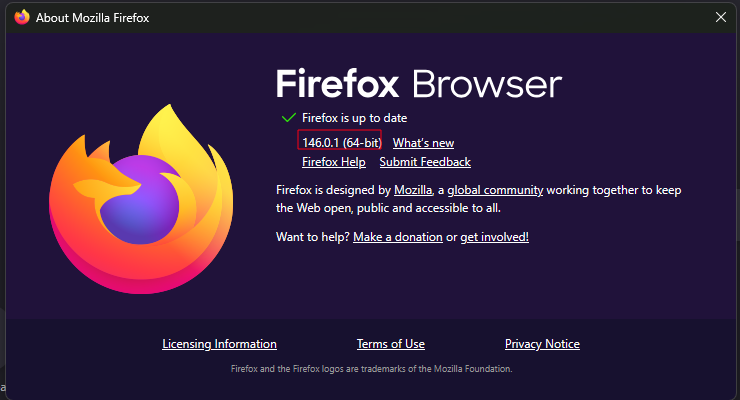

Marco2G 4 Posted January 7 Author Posted January 7 embyserver.txt Here ya go. I'd look at timestamp 20:06 and forward. Just now the stream started almost immediately in firefox connecting internally from my machine. From 20:06 onward it's a connection from the mediacenter, still connecting internally. THAT took longer again. It seems the delay is fluctuating and the problem thus intermittent. My firefox version is 146.0

Solution Jefemy 3 Posted January 19 Solution Posted January 19 The recently released Firefox MKV support doesn't allow for partial retrieval of the video content it seems. You can disable it by going to about:config and changing media.mkv.enabled to false. 3
