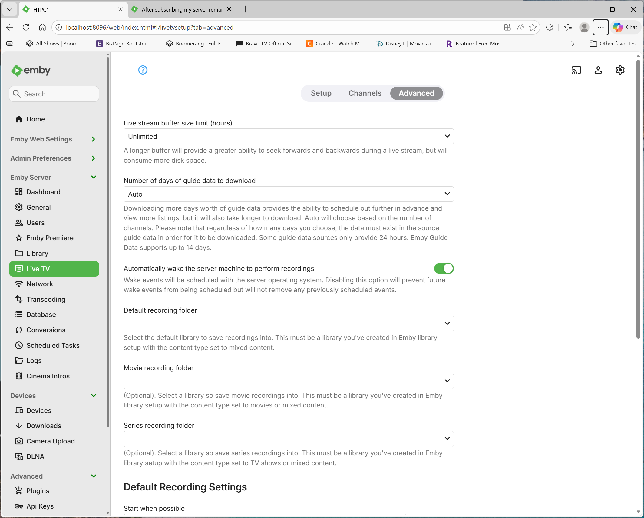

I still can't find ANY DVR menu similar or the one you sent me a pic of. Here is a screenshot of my advanced tab. In the livetv section I see one channel.
Quote
Can you show us?
Also in live tv setup, what do you see under the Channels tab? This will show all of the channels that were imported from nextpvr.
  • Solution
js28194
Ah, I think I know what maybe going on as I do experience this same issue with EMBY.  I do not RECORD with EMBY as I use Kodi as my daily driver.  My observations:
Emby will suck in all live tv channels from NextPVR for viewing, but for recording will do it's "own thing".  If you schedule a recording in EMBY, EMBY settings govern, it does not get passed over to NextPVR.  The only "Work Around" is to set the same recording directory in EMBY to the same as NextPVR, but I can assure you, that NextPVR will not be governing that recording.  It's a one way communication to suck in channels and guide (if you setup the guide in NextPVR).  Recording triggers and events are not passed back as far I have observed.
This has really happened to me ONCE as my remote offsite location recorded in EMBY and that's how I stumbled upon this.  Never an issue for me locally as triggering a recording schedule and event from Kodi gets passed directly through the NextPVR addon to the NextPVR backend.  Again, don't use EMBY app locally to care enough and never really made a big deal of it.
