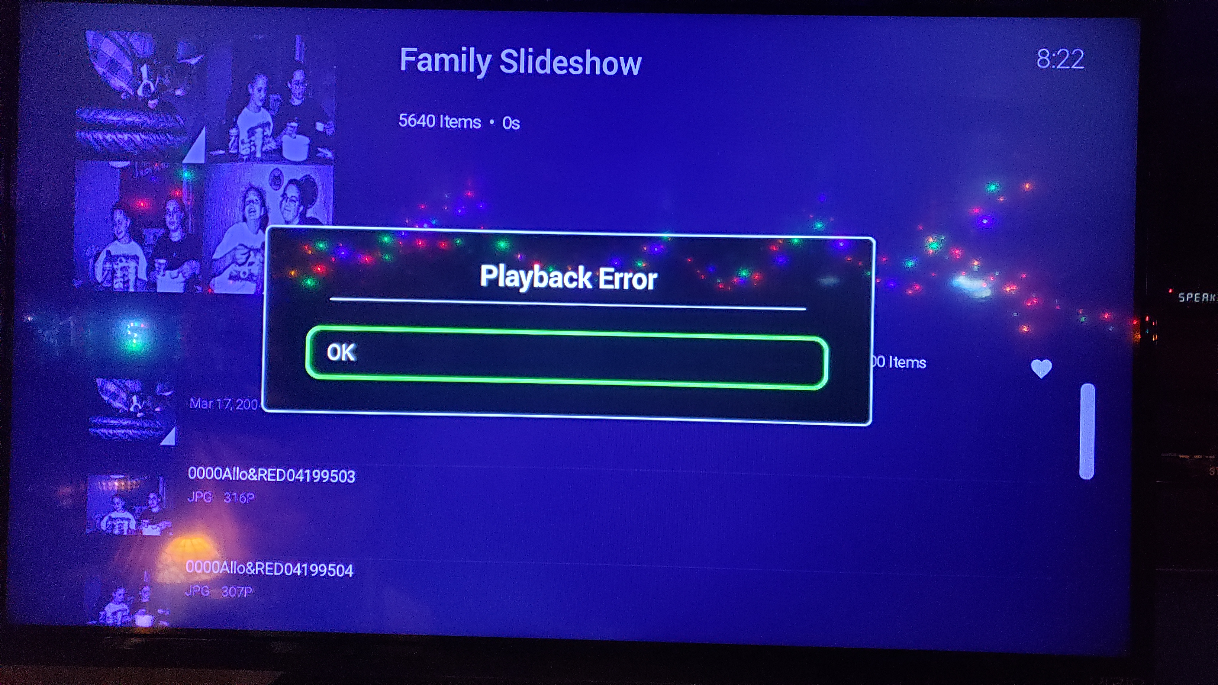

SumpnFishy 1 Posted January 6 Author Posted January 6 I go into my Photos library and select folders. Select one folder and created playlist Family Slideshow. On the Roku app go to playlists and select the slideshow and hit the play button. The screenshot shows the result. Happens on every Roku I have tested it with. Checked the Emby Roku app and it says it's up to date.
ebr 16332 Posted January 6 Posted January 6 The Roku app doesn't understand playlists of photos at this point in time so I understand that. I was asking about this: 18 hours ago, SumpnFishy said: Then in the Roku client I went to folder and selected play. You said went to the folder. Did you actually mean playlist? Have you tried playing from a folder of photos?
