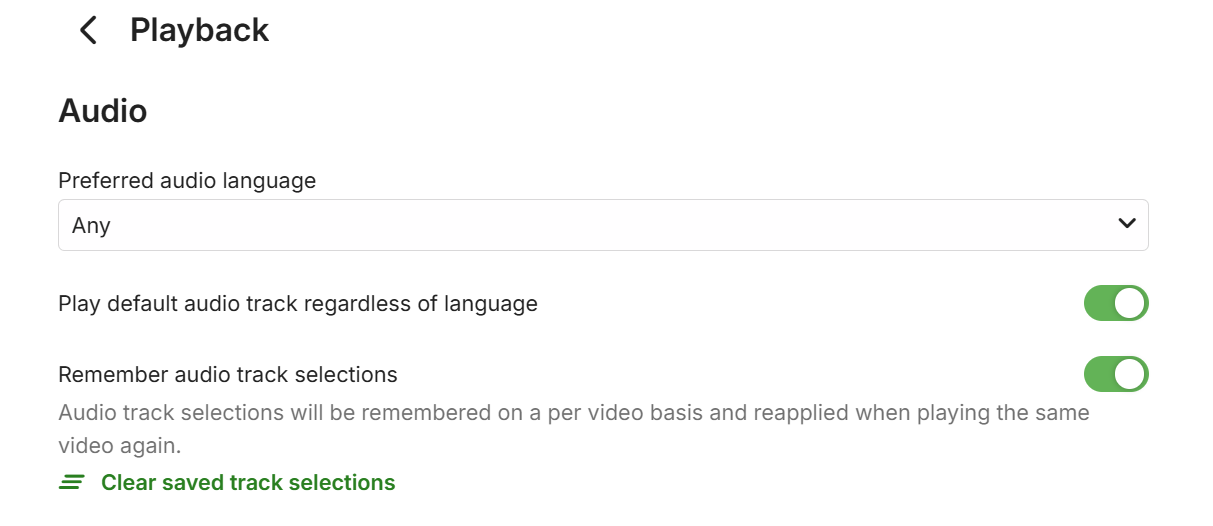

sergeymetallic 0 Posted January 5 Posted January 5 Samsung model number: UE65KS7500 Samsung firmware version: 260 (Tizen 2.4.0) Samsung Emby client version: 2.2.9 Emby server version: 4.9.1.90 Steps to reproduce: 1. Start watching a video with several audio channels. Choose non-default one(not the first in the list) 2. Pause a video and exit emby client(or shut down the TV) 3. Start emby client and resume watching Expected: audio is the one chosen on the previous session Actual: audio is the one that is the first in the list. At the same time in the choose box correct one is chosen. Example: The fist channel is in spanish, I choose english and watch in english. Next time I start the client audio is in spanish, although english is still chosen. So in order to have english again I need to choose spanish first and then english again. I have these setting for playback on the server side:
Luke 42237 Posted January 5 Posted January 5 Hi there, let's look at an example. Please attach the information requested in how to report a media playback issue. Thanks!

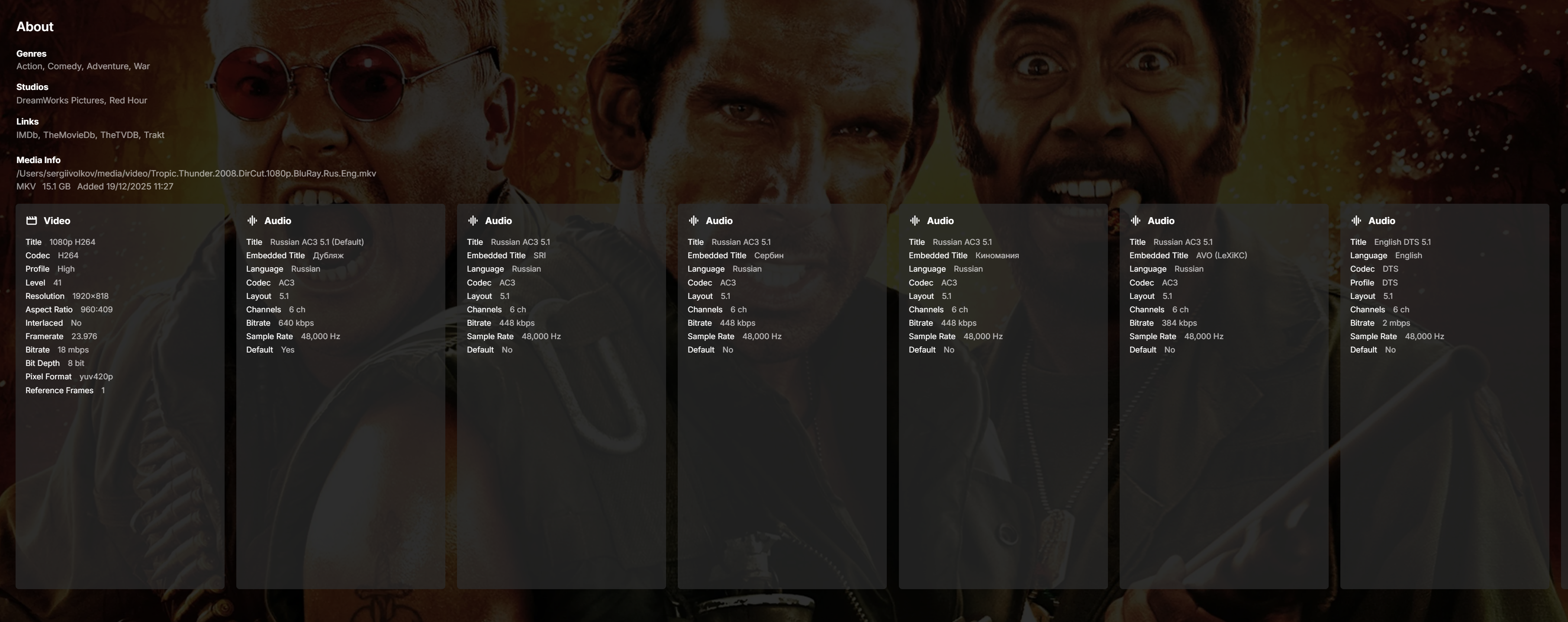

sergeymetallic 0 Posted January 5 Author Posted January 5 (edited) Please see the media info and the log file". So I am trying to watch the movie in english, but when I resume the defaut russion is picked up(Marked with ""Default: yes""). embyserver-63903168001.txt Edited January 5 by sergeymetallic
Luke 42237 Posted January 5 Posted January 5 OK what exactly makes you think the wrong track was played?
sergeymetallic 0 Posted January 5 Author Posted January 5 (edited) Because I was watching in english and when stop, exit app and then resume it starts in russian(although english is still chosen) Edited January 5 by sergeymetallic

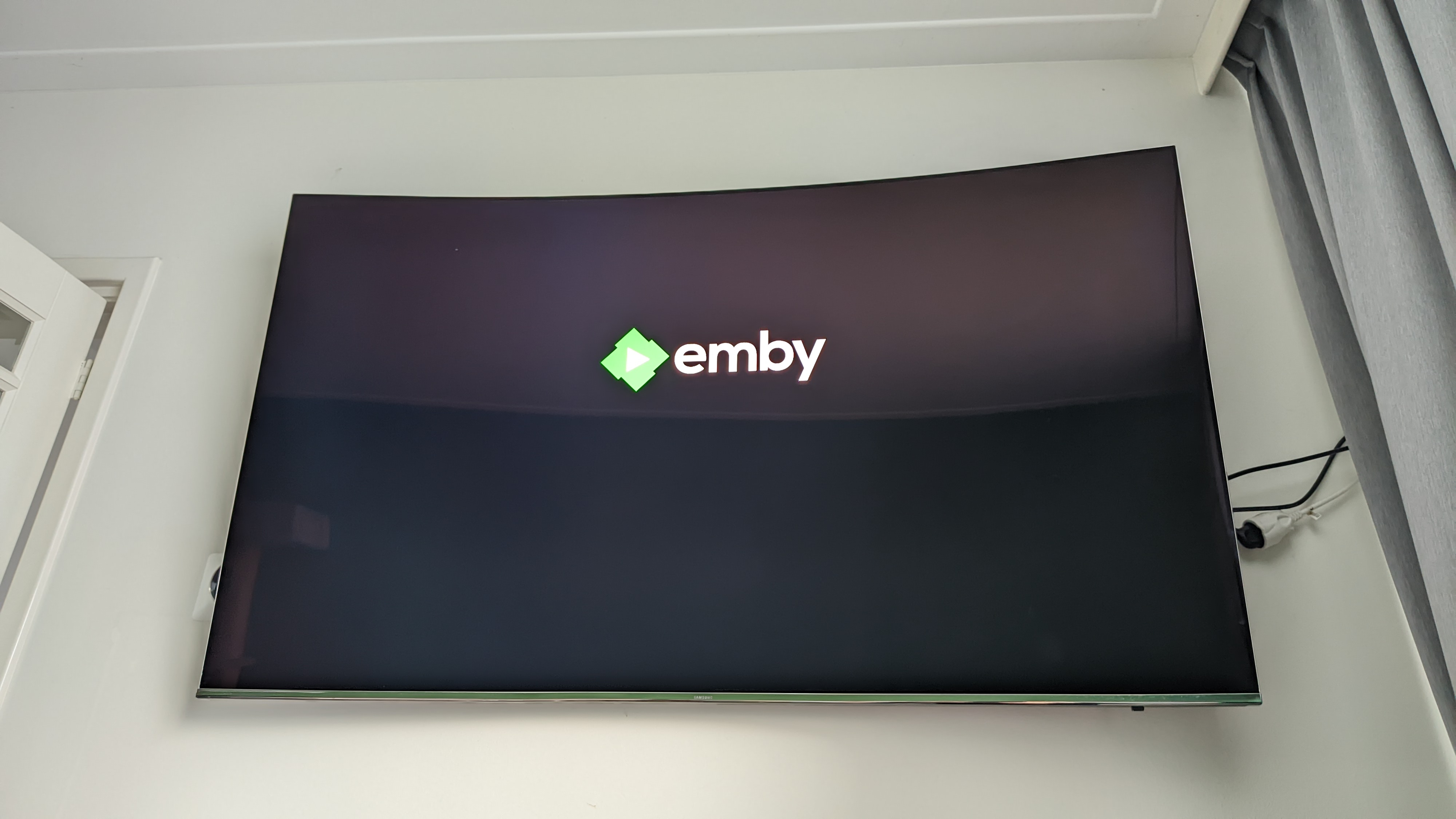

sergeymetallic 0 Posted February 7 Author Posted February 7 Today I downloaded the new version from https://github.com/MediaBrowser/Emby.Releases/raw/master/tizen/tizen.zip , I see files are dated 29/01/2026(I suspect version 2.3.1). App installed fine but when I try to start it it shows the loading indicator for a moment but otherwise just a logo on the black screen forever. I tried to delete/install, restart my TV. Nothing helps, meanwhile the app store version works just fine. I see these lines in my logs: 2026-02-07 18:48:22.878 Info VideoService-0HNIS6RRQ2T5A:00000002: http/1.0 GET http://192.168.178.195:8196/emby/videos/4602/original.mkv?DeviceId=9ee044df-20ed-42d6-9714-cfa917901415&MediaSourceId=mediasource_4602&PlaySessionId=8dda458cbf8c41ca87b56871858f3f12&api_key=x_secret5_x. Source Ip: host3, Accept=*/*, Host=192.168.178.195:8196, User-Agent=samsung-agent/1.1, Range=bytes=0- 2026-02-07 18:48:22.997 Info VideoService-0HNIS6RRQ2T5A:00000002: http/1.0 Response completed after client disconnected to host3. Time: 119ms. GET http://192.168.178.195:8196/emby/videos/4602/original.mkv?DeviceId=9ee044df-20ed-42d6-9714-cfa917901415&MediaSourceId=mediasource_4602&PlaySessionId=8dda458cbf8c41ca87b56871858f3f12&api_key=x_secret5_x. Headers: Connection=close, Content-Type=video/x-matroska, Date=Sat, 07 Feb 2026 17:48:22 GMT, Server=UPnP/1.0 DLNADOC/1.50, Accept-Ranges=bytes, Cache-Control=private, no-transform, Content-Range=bytes 0-1928185063/1928185064, ETag="96f525fc8954ee96bc4297ed14d27801", Content-Length=1928185064, Cross-Origin-Resource-Policy=cross-origin, Private-Network-Access-Name=Sergiis-Mac-mini, Private-Network-Access-Id=5799bcb6066a46c791718e1a82dc2a62 2026-02-07 18:48:23.013 Info VideoService-0HNIS6RRQ2T5B:00000002: http/1.0 GET http://192.168.178.195:8196/emby/videos/4602/original.mkv?DeviceId=9ee044df-20ed-42d6-9714-cfa917901415&MediaSourceId=mediasource_4602&PlaySessionId=8dda458cbf8c41ca87b56871858f3f12&api_key=x_secret5_x. Source Ip: host3, Accept=*/*, Host=192.168.178.195:8196, User-Agent=samsung-agent/1.1, Range=bytes=1928126546- 2026-02-07 18:48:23.015 Info VideoService-0HNIS6RRQ2T5B:00000002: http/1.0 Response 206 to host3. Time: 3ms. GET http://192.168.178.195:8196/emby/videos/4602/original.mkv?DeviceId=9ee044df-20ed-42d6-9714-cfa917901415&MediaSourceId=mediasource_4602&PlaySessionId=8dda458cbf8c41ca87b56871858f3f12&api_key=x_secret5_x. Headers: Connection=close, Content-Type=video/x-matroska, Date=Sat, 07 Feb 2026 17:48:22 GMT, Server=UPnP/1.0 DLNADOC/1.50, Accept-Ranges=bytes, Cache-Control=private, no-transform, Content-Range=bytes 1928126546-1928185063/1928185064, ETag="96f525fc8954ee96bc4297ed14d27801", Content-Length=58518, Cross-Origin-Resource-Policy=cross-origin, Private-Network-Access-Name=Sergiis-Mac-mini, Private-Network-Access-Id=5799bcb6066a46c791718e1a82dc2a62 2026-02-07 18:48:23.091 Info VideoService-0HNIS6RRQ2T5C:00000002: http/1.0 GET http://192.168.178.195:8196/emby/videos/4602/original.mkv?DeviceId=9ee044df-20ed-42d6-9714-cfa917901415&MediaSourceId=mediasource_4602&PlaySessionId=8dda458cbf8c41ca87b56871858f3f12&api_key=x_secret5_x. Source Ip: host3, Accept=*/*, Host=192.168.178.195:8196, User-Agent=samsung-agent/1.1, Range=bytes=524288- 2026-02-07 18:48:24.068 Info VideoService-0HNIS6RRQ2T5C:00000002: http/1.0 Response completed after client disconnected to host3. Time: 977ms. GET http://192.168.178.195:8196/emby/videos/4602/original.mkv?DeviceId=9ee044df-20ed-42d6-9714-cfa917901415&MediaSourceId=mediasource_4602&PlaySessionId=8dda458cbf8c41ca87b56871858f3f12&api_key=x_secret5_x. Headers: Connection=close, Content-Type=video/x-matroska, Date=Sat, 07 Feb 2026 17:48:22 GMT, Server=UPnP/1.0 DLNADOC/1.50, Accept-Ranges=bytes, Cache-Control=private, no-transform, Content-Range=bytes 524288-1928185063/1928185064, ETag="96f525fc8954ee96bc4297ed14d27801", Content-Length=1927660776, Cross-Origin-Resource-Policy=cross-origin, Private-Network-Access-Name=Sergiis-Mac-mini, Private-Network-Access-Id=5799bcb6066a46c791718e1a82dc2a62 2026-02-07 18:48:24.090 Info VideoService-0HNIS6RRQ2T5D:00000002: http/1.0 GET http://192.168.178.195:8196/emby/videos/4602/original.mkv?DeviceId=9ee044df-20ed-42d6-9714-cfa917901415&MediaSourceId=mediasource_4602&PlaySessionId=8dda458cbf8c41ca87b56871858f3f12&api_key=x_secret5_x. Source Ip: host3, Accept=*/*, Host=192.168.178.195:8196, User-Agent=samsung-agent/1.1, Range=bytes=1478838409- 2026-02-07 18:48:27.357 Info VideoService-0HNIS6RRQ2T5D:00000002: http/1.0 Response completed after client disconnected to host3. Time: 3267ms. GET http://192.168.178.195:8196/emby/videos/4602/original.mkv?DeviceId=9ee044df-20ed-42d6-9714-cfa917901415&MediaSourceId=mediasource_4602&PlaySessionId=8dda458cbf8c41ca87b56871858f3f12&api_key=x_secret5_x. Headers: Connection=close, Content-Type=video/x-matroska, Date=Sat, 07 Feb 2026 17:48:23 GMT, Server=UPnP/1.0 DLNADOC/1.50, Accept-Ranges=bytes, Cache-Control=private, no-transform, Content-Range=bytes 1478838409-1928185063/1928185064, ETag="96f525fc8954ee96bc4297ed14d27801", Content-Length=449346655, Cross-Origin-Resource-Policy=cross-origin, Private-Network-Access-Name=Sergiis-Mac-mini, Private-Network-Access-Id=5799bcb6066a46c791718e1a82dc2a62 2026-02-07 18:48:29.587 Info PlaystateService-0HNIS6RRQ2T59:00000005: http/1.1 POST http://192.168.178.195:8196/emby/Sessions/Playing/Stopped?X-Emby-Client=Emby for Samsung&X-Emby-Device-Name=Samsung Smart TV (UE65KS7500)&X-Emby-Device-Id=9ee044df-20ed-42d6-9714-cfa917901415&X-Emby-Client-Version=2.2.9&X-Emby-Token=x_secret5_x&X-Emby-Language=en-gb&reqformat=json. Source Ip: host3, UserAgent: Mozilla/5.0 (SMART-TV; Linux; Tizen 2.4.0) AppleWebKit/538.1 (KHTML, like Gecko) Version/2.4.0 TV Safari/538.1 2026-02-07 18:48:29.587 Info SessionManager: Playback stopped reported by app Emby for Samsung 2.2.9 on Samsung Smart TV (UE65KS7500) playing Unnamed item. Position: 1491650 ms. PlaySessionId: 8dda458cbf8c41ca87b56871858f3f12. IsPaused: False 2026-02-07 18:48:29.588 Info PlaystateService-0HNIS6RRQ2T59:00000005: http/1.1 Response 204 to host3. Time: 1ms. POST http://192.168.178.195:8196/emby/Sessions/Playing/Stopped?X-Emby-Client=Emby for Samsung&X-Emby-Device-Name=Samsung Smart TV (UE65KS7500)&X-Emby-Device-Id=9ee044df-20ed-42d6-9714-cfa917901415&X-Emby-Client-Version=2.2.9&X-Emby-Token=x_secret5_x&X-Emby-Language=en-gb&reqformat=json. 2026-02-07 18:55:10.696 Info App: Udp message sent to :46797 2026-02-07 18:55:11.859 Info SessionsService-0HNIS6RRQ2T5G:00000005: http/1.1 POST http://192.168.178.195:8196/emby/Sessions/Capabilities/Full?X-Emby-Client=Emby for Samsung&X-Emby-Device-Name=Samsung Smart TV (UE65KS7500)&X-Emby-Device-Id=9ee044df-20ed-42d6-9714-cfa917901415&X-Emby-Client-Version=2.3.1&X-Emby-Token=x_secret5_x&X-Emby-Language=en-gb&reqformat=json. Source Ip: host3, UserAgent: Mozilla/5.0 (SMART-TV; Linux; Tizen 2.4.0) AppleWebKit/538.1 (KHTML, like Gecko) Version/2.4.0 TV Safari/538.1 2026-02-07 18:55:11.860 Info SessionsService-0HNIS6RRQ2T5G:00000005: http/1.1 Response 204 to host3. Time: 3ms. POST http://192.168.178.195:8196/emby/Sessions/Capabilities/Full?X-Emby-Client=Emby for Samsung&X-Emby-Device-Name=Samsung Smart TV (UE65KS7500)&X-Emby-Device-Id=9ee044df-20ed-42d6-9714-cfa917901415&X-Emby-Client-Version=2.3.1&X-Emby-Token=x_secret5_x&X-Emby-Language=en-gb&reqformat=json. 2026-02-07 18:55:12.918 Info HttpClient: GET https://assets.fanart.tv/fanart/hamnet-68fda51bbbb88.jpg 2026-02-07 18:55:13.486 Info HttpClient: Http response 200 from https://assets.fanart.tv/fanart/hamnet-68fda51bbbb88.jpg after 569ms 2026-02-07 18:55:13.892 Info ProviderManager: Saving image to /Users/sergiivolkov/.config/emby-server/metadata/library/1a/1a9f3fe959adc0beb85fa6918907585e/landscape.jpg 2026-02-07 18:56:59.527 Info App: Udp message sent to :59757 2026-02-07 18:57:00.722 Info SessionsService-0HNIS6RRQ2T5V:00000005: http/1.1 POST http://192.168.178.195:8196/emby/Sessions/Capabilities/Full?X-Emby-Client=Emby for Samsung&X-Emby-Device-Name=Samsung Smart TV (UE65KS7500)&X-Emby-Device-Id=9ee044df-20ed-42d6-9714-cfa917901415&X-Emby-Client-Version=2.3.1&X-Emby-Token=x_secret5_x&X-Emby-Language=en-gb&reqformat=json. Source Ip: host3, UserAgent: Mozilla/5.0 (SMART-TV; Linux; Tizen 2.4.0) AppleWebKit/538.1 (KHTML, like Gecko) Version/2.4.0 TV Safari/538.1 2026-02-07 18:57:00.722 Info SessionsService-0HNIS6RRQ2T5V:00000005: http/1.1 Response 204 to host3. Time: 0ms. POST http://192.168.178.195:8196/emby/Sessions/Capabilities/Full?X-Emby-Client=Emby for Samsung&X-Emby-Device-Name=Samsung Smart TV (UE65KS7500)&X-Emby-Device-Id=9ee044df-20ed-42d6-9714-cfa917901415&X-Emby-Client-Version=2.3.1&X-Emby-Token=x_secret5_x&X-Emby-Language=en-gb&reqformat=json. 2026-02-07 18:58:02.488 Info App: Udp message sent to :41859 2026-02-07 18:58:03.668 Info SessionsService-0HNIS6RRQ2T66:00000005: http/1.1 POST http://192.168.178.195:8196/emby/Sessions/Capabilities/Full?X-Emby-Client=Emby for Samsung&X-Emby-Device-Name=Samsung Smart TV (UE65KS7500)&X-Emby-Device-Id=9ee044df-20ed-42d6-9714-cfa917901415&X-Emby-Client-Version=2.3.1&X-Emby-Token=x_secret5_x&X-Emby-Language=en-gb&reqformat=json. Source Ip: host3, UserAgent: Mozilla/5.0 (SMART-TV; Linux; Tizen 2.4.0) AppleWebKit/538.1 (KHTML, like Gecko) Version/2.4.0 TV Safari/538.1 2026-02-07 18:58:03.669 Info SessionsService-0HNIS6RRQ2T66:00000005: http/1.1 Response 204 to host3. Time: 0ms. POST http://192.168.178.195:8196/emby/Sessions/Capabilities/Full?X-Emby-Client=Emby for Samsung&X-Emby-Device-Name=Samsung Smart TV (UE65KS7500)&X-Emby-Device-Id=9ee044df-20ed-42d6-9714-cfa917901415&X-Emby-Client-Version=2.3.1&X-Emby-Token=x_secret5_x&X-Emby-Language=en-gb&reqformat=json. 2026-02-07 19:08:23.237 Info App: Udp message sent to :56996 2026-02-07 19:08:24.442 Info SessionsService-0HNIS6RRQ2T6M:00000005: http/1.1 POST http://192.168.178.195:8196/emby/Sessions/Capabilities/Full?X-Emby-Client=Emby for Samsung&X-Emby-Device-Name=Samsung Smart TV (UE65KS7500)&X-Emby-Device-Id=9ee044df-20ed-42d6-9714-cfa917901415&X-Emby-Client-Version=2.3.1&X-Emby-Token=x_secret5_x&X-Emby-Language=en-gb&reqformat=json. Source Ip: host3, UserAgent: Mozilla/5.0 (SMART-TV; Linux; Tizen 2.4.0) AppleWebKit/538.1 (KHTML, like Gecko) Version/2.4.0 TV Safari/538.1 2026-02-07 19:08:24.443 Info SessionsService-0HNIS6RRQ2T6M:00000005: http/1.1 Response 204 to host3. Time: 1ms. POST http://192.168.178.195:8196/emby/Sessions/Capabilities/Full?X-Emby-Client=Emby for Samsung&X-Emby-Device-Name=Samsung Smart TV (UE65KS7500)&X-Emby-Device-Id=9ee044df-20ed-42d6-9714-cfa917901415&X-Emby-Client-Version=2.3.1&X-Emby-Token=x_secret5_x&X-Emby-Language=en-gb&reqformat=json. 2026-02-07 19:10:59.140 Info App: Udp message sent to :53331 2026-02-07 19:16:20.662 Info App: Udp message sent to :34369 2026-02-07 19:25:33.306 Info App: Udp message sent to :42300 2026-02-07 19:26:50.752 Info App: Udp message sent to :43030 2026-02-07 19:26:54.617 Info App: Udp message sent to :40462 2026-02-07 19:27:44.904 Info UserService-0HNIS6RRQ2T7F:00000006: http/1.1 POST http://192.168.178.195:8196/emby/Users/authenticatebyname?X-Emby-Client=Emby for Samsung&X-Emby-Device-Name=Samsung Smart TV (UE65KS7500)&X-Emby-Device-Id=8c13c788-809a-48c0-93f1-a28db91818b2&X-Emby-Client-Version=2.2.5&X-Emby-Language=en-gb. Source Ip: host4, Accept=application/json, Connection=keep-alive, Host=192.168.178.195:8196, User-Agent=Mozilla/5.0 (SMART-TV; Linux; Tizen 2.4.0) AppleWebKit/538.1 (KHTML, like Gecko) Version/2.4.0 TV Safari/538.1, Accept-Charset=iso-8859-1, utf-8, utf-16, *;q=0.1, Accept-Encoding=gzip, deflate, Accept-Language=en-GB, Content-Type=application/x-www-form-urlencoded; charset=UTF-8, Origin=null, Content-Length=46, DNT=0 2026-02-07 19:27:44.910 Info UserManager: Authentication request for sergiivolkov has succeeded. 2026-02-07 19:27:44.910 Info SessionManager: Creating new access token for user 1 sergiivolkov 2026-02-07 19:27:44.912 Info UserService-0HNIS6RRQ2T7F:00000006: http/1.1 Response 200 to host4. Time: 8ms. POST http://192.168.178.195:8196/emby/Users/authenticatebyname?X-Emby-Client=Emby for Samsung&X-Emby-Device-Name=Samsung Smart TV (UE65KS7500)&X-Emby-Device-Id=8c13c788-809a-48c0-93f1-a28db91818b2&X-Emby-Client-Version=2.2.5&X-Emby-Language=en-gb. Headers: Content-Type=application/json; charset=utf-8, Date=Sat, 07 Feb 2026 18:27:44 GMT, Server=UPnP/1.0 DLNADOC/1.50, Content-Encoding=deflate, Expires=-1, Vary=Accept-Encoding, Content-Length=1256, Cross-Origin-Resource-Policy=cross-origin, Private-Network-Access-Name=Sergiis-Mac-mini, Private-Network-Access-Id=5799bcb6066a46c791718e1a82dc2a62 2026-02-07 19:27:44.980 Info SessionsService-0HNIS6RRQ2T7E:00000004: http/1.1 POST http://192.168.178.195:8196/emby/Sessions/Capabilities/Full?X-Emby-Client=Emby for Samsung&X-Emby-Device-Name=Samsung Smart TV (UE65KS7500)&X-Emby-Device-Id=8c13c788-809a-48c0-93f1-a28db91818b2&X-Emby-Client-Version=2.2.5&X-Emby-Token=x_secret6_x&X-Emby-Language=en-gb&reqformat=json. Source Ip: host4, UserAgent: Mozilla/5.0 (SMART-TV; Linux; Tizen 2.4.0) AppleWebKit/538.1 (KHTML, like Gecko) Version/2.4.0 TV Safari/538.1 2026-02-07 19:27:44.981 Info SessionsService-0HNIS6RRQ2T7E:00000004: http/1.1 Response 204 to host4. Time: 1ms. POST http://192.168.178.195:8196/emby/Sessions/Capabilities/Full?X-Emby-Client=Emby for Samsung&X-Emby-Device-Name=Samsung Smart TV (UE65KS7500)&X-Emby-Device-Id=8c13c788-809a-48c0-93f1-a28db91818b2&X-Emby-Client-Version=2.2.5&X-Emby-Token=x_secret6_x&X-Emby-Language=en-gb&reqformat=json. 2026-02-07 19:27:51.347 Info MediaInfoService-0HNIS6RRQ2T7Q:00000006: http/1.1 POST http://192.168.178.195:8196/emby/Items/4646/PlaybackInfo?UserId=x_secret3_x&StartTimeTicks=0&IsPlayback=false&AutoOpenLiveStream=false&MaxStreamingBitrate=200000000&X-Emby-Client=Emby for Samsung&X-Emby-Device-Name=Samsung Smart TV (UE65KS7500)&X-Emby-Device-Id=8c13c788-809a-48c0-93f1-a28db91818b2&X-Emby-Client-Version=2.2.5&X-Emby-Token=x_secret6_x&X-Emby-Language=en-gb&reqformat=json. Source Ip: host4, UserAgent: Mozilla/5.0 (SMART-TV; Linux; Tizen 2.4.0) AppleWebKit/538.1 (KHTML, like Gecko) Version/2.4.0 TV Safari/538.1 2026-02-07 19:27:51.351 Info MediaInfoService-0HNIS6RRQ2T7Q:00000006: User policy for sergiivolkov. EnablePlaybackRemuxing: True EnableVideoPlaybackTranscoding: True EnableAudioPlaybackTranscoding: True 2026-02-07 19:27:51.351 Info MediaInfoService-0HNIS6RRQ2T7Q:00000006: http/1.1 Response 200 to host4. Time: 5ms. POST http://192.168.178.195:8196/emby/Items/4646/PlaybackInfo?UserId=x_secret3_x&StartTimeTicks=0&IsPlayback=false&AutoOpenLiveStream=false&MaxStreamingBitrate=200000000&X-Emby-Client=Emby for Samsung&X-Emby-Device-Name=Samsung Smart TV (UE65KS7500)&X-Emby-Device-Id=8c13c788-809a-48c0-93f1-a28db91818b2&X-Emby-Client-Version=2.2.5&X-Emby-Token=x_secret6_x&X-Emby-Language=en-gb&reqformat=json. Is there any way to download previous version? Thanks
SamES 1084 Posted February 7 Posted February 7 Have you got 2 KS series TVs or just 1? It looks like you had version 2.3.1 and are now trying to load 2.2.5 Do you have both the store and usb versions installed? Doing this shouldn’t be an issue, but maybe it is causing some issues. Try uninstalling both versions, power cycle the TV then install the preferred version. Unless you need to troubleshoot a specific issue, or urgently need a new feature I would stick with the store version for that model while it continues to receive store updates. 2.2.5 is the latest store version and 2.2.8 is with Samsung for testing. The USB version number gets ahead of the store version as we have to update it every month due to the built in expiry from Samsung, but that doesn’t mean there are necessarily functional changes. Once there are important updates and features then a store version is submitted. Having said that, if you want to first test the USB version and provide feedback as if there are issues on this older model, it is a good opportunity for us to resolve it before a store version is submitted.

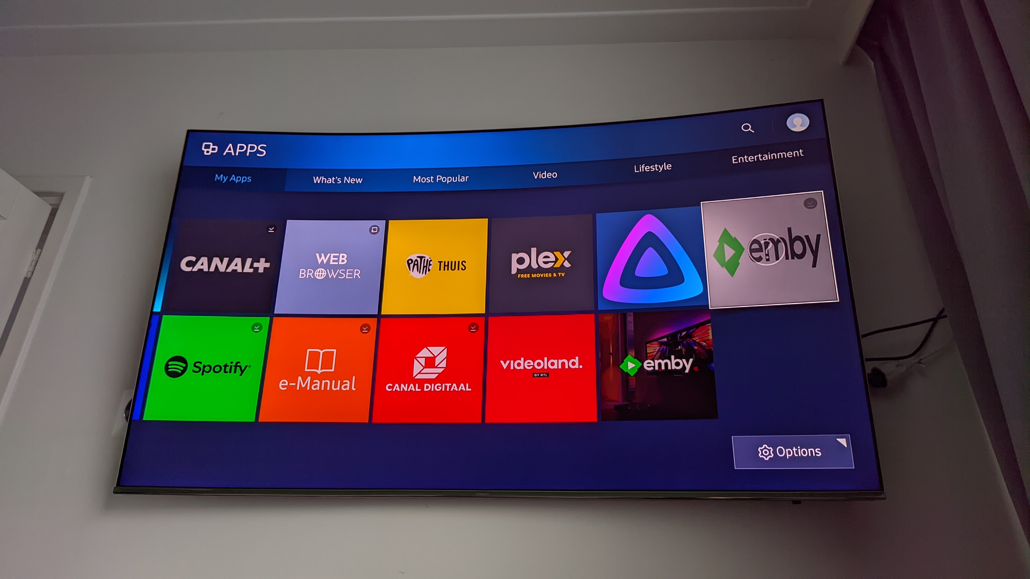

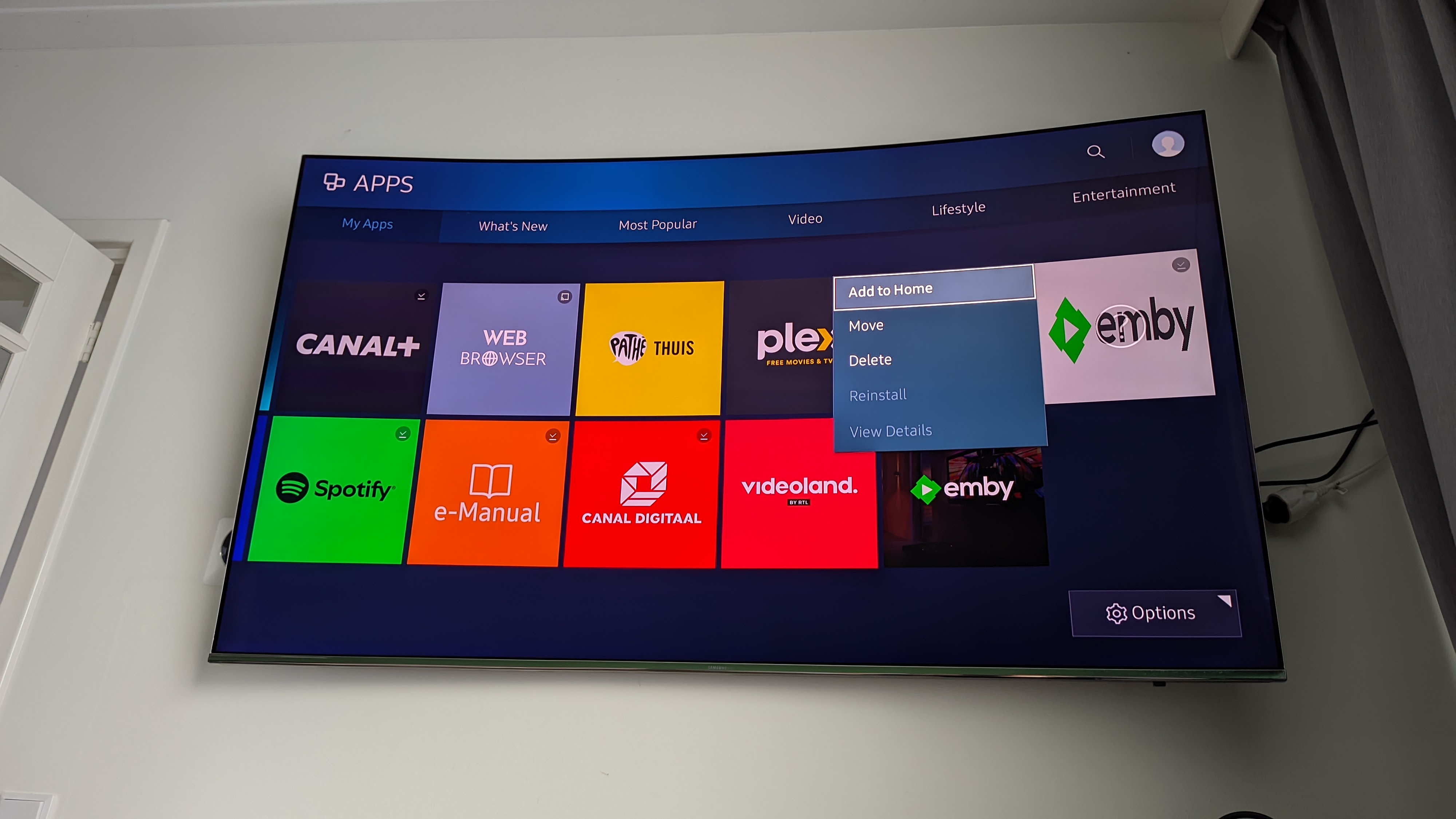

sergeymetallic 0 Posted February 8 Author Posted February 8 @SamES In past I had the store version and then I installed 2.2.9 via USB and it worked great. Then I wanted to test the fix you made for audio channel in th eversion 2.3.1(Improve error handling on audio track changes). So I installed an update via USB and got the problem I described. Then I unintalled all the versions, power cycled my TV and installed the latest version via USB - problem is still present. Then I installed the store version and it did not work either untill I removed USB version and re-installed the store version. Interesting observation: USB version does not have "View details" active and marked with white question mark(see photos). When I start USB version I get a screen with the logo and nothing changes. If I press down and then "Ok" I get some menu you can see on the first screenshot, but selecting and pressing Ok just returns me to the black screen with logo. I attached new log for today with my experiment if that could help. For now I stay with the store version but I really want to test audio channel fix. embyserver.txt
SamES 1084 Posted February 8 Posted February 8 Thanks. I can reproduce this on older models. You will have to run with the store app for now until we can get out a fix for this 1
