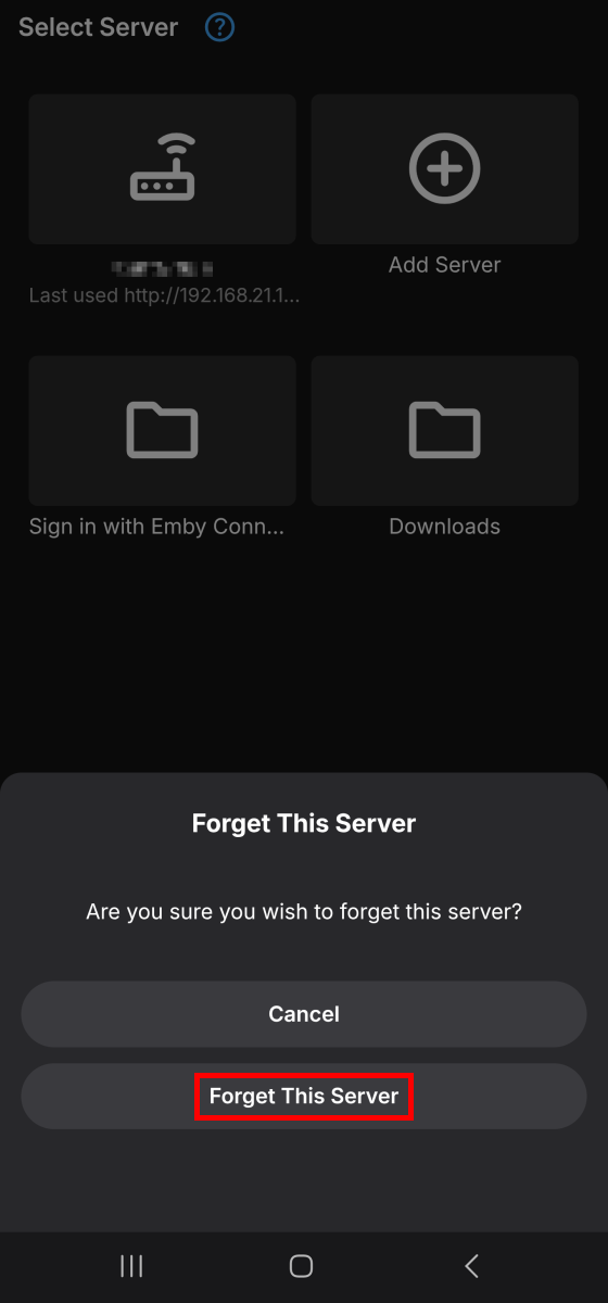

dma_k 2 Posted January 5 Posted January 5 I am using Android app v3.5.16. When I select the server, long press and select "Forget This Server", then nothing happens. I tried a few times... Expected that server is removed and I can add it again.
Luke 42241 Posted January 5 Posted January 5 Hi, if the server is on the same local network as the device, then after you click forget, it is probably just rediscovering it.
dma_k 2 Posted January 6 Author Posted January 6 (edited) 20 hours ago, Luke said: Hi, if the server is on the same local network as the device, then after you click forget, it is probably just rediscovering it. Thanks, that explains the behavior. Shouldn't the app show the message "The server xxx has been autodiscovered, would you like to add it [yes|no]?" That is probably the topic for another thread, but I decided to remove the server and re-add it, as connect to it does not work smoothly when I am on local network. Emby works just perfect under Apache proxy when I access it from Internet (using URL https://emby.myserver.com), for example, when I switch off WiFi on my mobile and use 4G. Emby seems to fail to connect to Emby server when Emby app accesses it from local network (WiFi is enabled)? Because then it shows above screen to select server. However when I click on "Downloads" icon on the bottom and then back to "Home", then correct Home screen is displayed (I can play videos / media). Also I tested the connection (telnet 192.168.21.1 8096) and it works just fine. Something to do with autodiscovery? Update: I got more details about the issue. Clients in local network are only allowed to access internet via proxy. Have you thought about such scenario? What happens is that Emby app asks proxy server to CONNECT 192.168.21.1:8096, but this is not allowed. Then on some reason Emby app sends GET http://192.168.21.1:8096/emby/system/info/public to proxy (that is allowed) and from them point it works fine. So I think that: If Emby app wants to connect to server using discovered IP address, it should ignore proxy settings for WiFi. Otherwise Emby app should use configured URL (CONNECT emby.myserver.com 443) at all times. Any better ideas? Edited January 6 by dma_k
