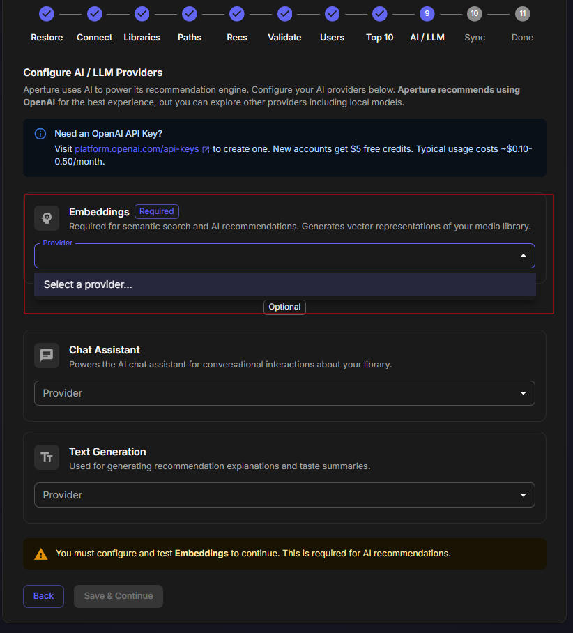

Just tried this as well.
A little info about my setup.
192.168.40.1 unRaid main server with a Nvidia 1080ti runs my Ollama docker.
192.168.40.2 unRaid test server runs Aperture and test Emby server.
How do I link Ollama to Aperture ?

I’ll have to investigate the setup wizard.

It's a route authorization issue. During first setup there is no logged in user, and the AI provider router is currently looking for one. I need to fix the route pattern.

Improved Setup Wizard
  • AI setup now works on fresh installs (previously failed because no auth existed yet)
  • All 3 AI functions are now required during setup
  • Existing configurations auto-populate when re-running the wizard
  • Added exit button for admins to return to settings

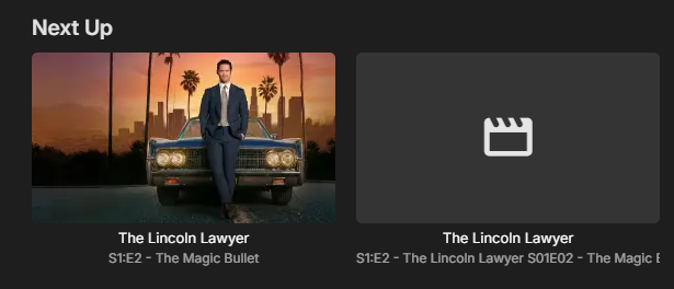

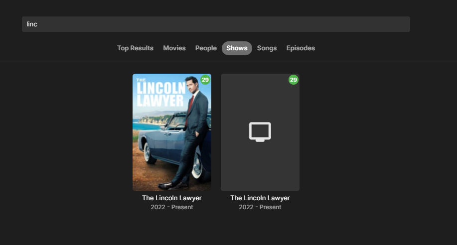

Is there any way to get rit off these duplicates?
Or is this just the nature of the beast 😁

It’s just how Emby sees things. Nothing I can do about that one

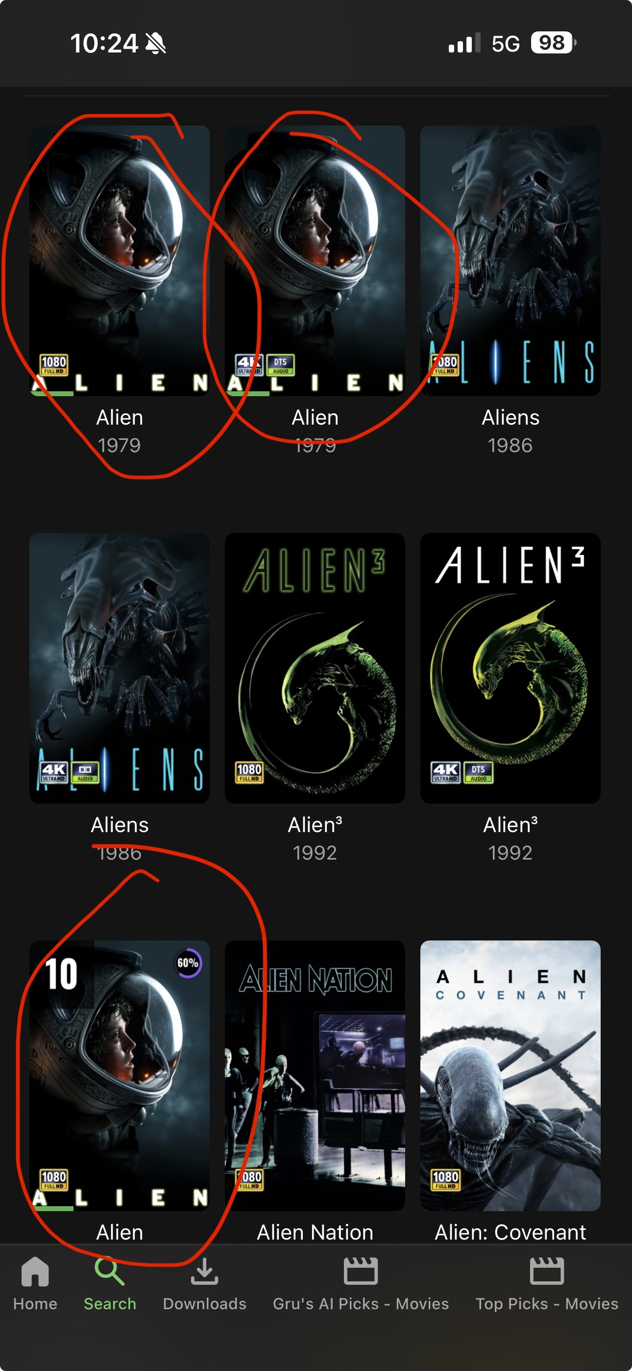

I have a movie library a movies 4k library and my AI recommendations library so I have Triplicates!
TheGru
Although it’s odd your dupes don’t show posters or the metadata.

For search duplicates you can turn on the library option 'Exclude from global seach'.

Hmm maybe I can set that via API on the libraries it creates! I’ll look in to it.
Test server with all metadata beside media files.
No metadata providers enabled 😉
That why 😁

Would be nice if the Emby team could also add exclude duplicates from continue watching and exclude duplicates from Recently released on the home screen @Luke

Yeah main server is master, that provides metadata to media.
Then Test server picks that up 😉
I don't want them both doing this.
And I like that the changes on main goes to test.
