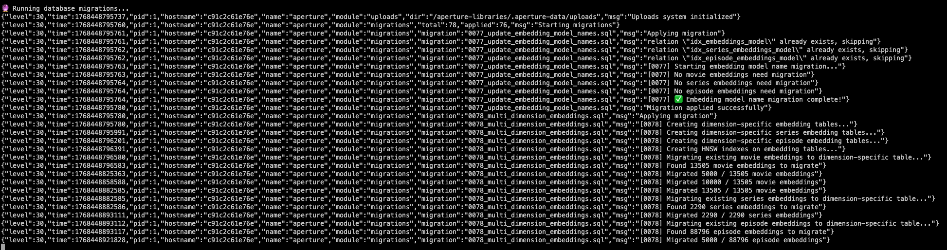

I attempted to use this wonderful looking tool for the fist time on a QNAP running QuTS 5 and I am having a bit of an issue. When the container starts, I see the below issued every few seconds:
🔮 Running database migrations...
{"level":30,"time":1768339087398,"pid":1,"hostname":"894401f83755","name":"aperture","module":"uploads","dir":"/aperture-libraries/.aperture-data/uploads","msg":"Uploads system initialized"}
{"level":50,"time":1768339090471,"pid":1,"hostname":"894401f83755","name":"aperture","module":"migrations","err":{"type":"Error","message":"connect EHOSTUNREACH 192.168.68.48:5432","stack":"Error: connect EHOSTUNREACH 192.168.68.48:5432\n    at /app/node_modules/.pnpm/pg-pool@3.10.1_pg@8.16.3/node_modules/pg-pool/index.js:45:11\n    at process.processTicksAndRejections (node:internal/process/task_queues:95:5)\n    at async runMigrations (file:///app/packages/core/dist/migrations.js:55:24)\n    at async main (file:///app/apps/api/dist/index.js:34:28)","errno":-113,"code":"EHOSTUNREACH","syscall":"connect","address":"192.168.68.48","port":5432},"msg":"Migration failed"}
Failed to run migrations: Error: connect EHOSTUNREACH 192.168.68.48:5432
    at async main (file:///app/apps/api/dist/index.js:34:28) {
  errno: -113,
  code: 'EHOSTUNREACH',
  syscall: 'connect',
  address: '192.168.68.48',
  port: 5432
I am using the stock QNAP file found here with two unused IP addresses and my subnet mask and network gateway changed appropriately . I think the issue is aperture container cannot talk to aperature.db, or probably the internet because of the complex QNAP network virtualization is not quite right.
Anyone have this working on a QNAP under AuTS willing to please share their docker-compose.yml?
Thank you in advance and thanks to the author for such a much needed tool!

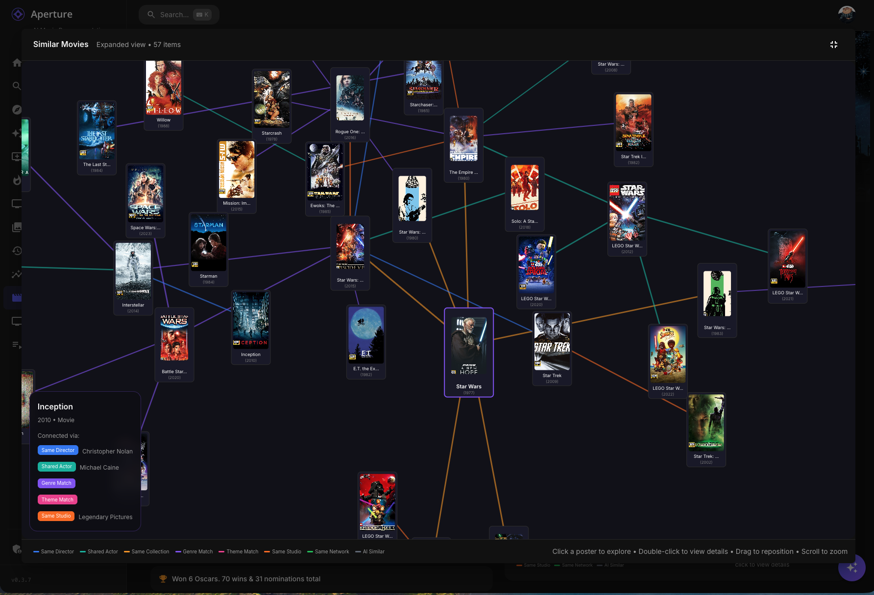

This is a major feature release introducing Similarity Graphs — a new interactive way to explore connections between movies and series in your library. Plus, you can now create playlists directly from your graph explorations!
🕸️ Similarity Graphs
Discover how your movies and series are connected through directors, actors, genres, collections, and more with our new interactive graph visualization.
What It Does
On any movie or series detail page, you'll now see a Graph tab alongside the traditional list view of similar content.
This graph displays:
  • Poster nodes — Each movie/series is shown as its actual poster
  • Color-coded connections — Lines between posters show why they're related:
    🔵 Blue — Same director
    🌊 Teal — Shared actors
    🥇 Gold — Same collection/franchise
    💜 Purple — Shared genres
    💗 Pink — Shared keywords/themes
    🟠 Orange — Same studio
    🟢 Green — Same network (TV)
    🩶 Gray — Vector similarity (AI-detected)
    💚 Emerald — AI Discovery (bubble breaker)
Interactive Features
  • Click any poster to refocus the graph on that item (rabbit-hole exploration!)
  • Double-click to navigate to that movie/series detail page
  • Drag posters to rearrange the layout
  • Scroll to zoom in and out
  • Hover on connections to see detailed relationship info
  • Breadcrumb navigation tracks your exploration path

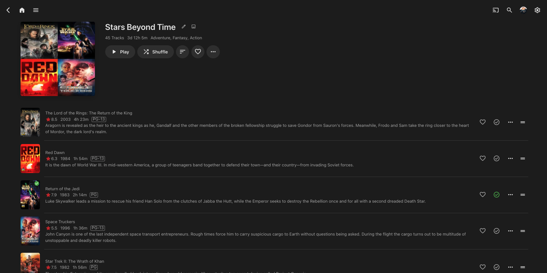

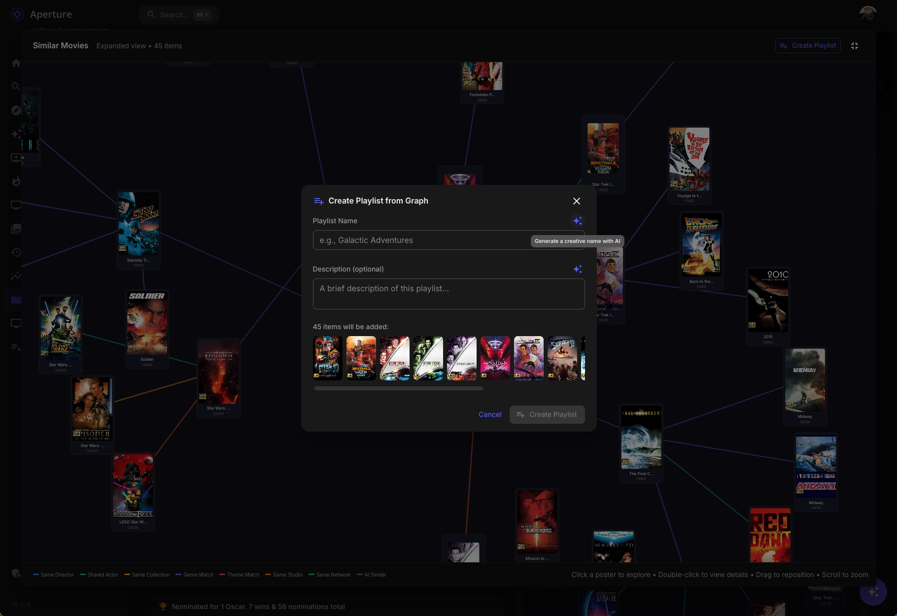

📋 Graph Playlists
Turn your graph explorations into playlists that sync to your media server!
Creating a Playlist
  • Open a similarity graph and go fullscreen
  • Explore until you have a nice collection of related content
  • Click Create Playlist
  • Choose a name (or click ✨ for AI-generated name)
  • Add a description (or click ✨ for AI-generated description)
  • Click Create
What Happens
  • Playlist is created in Emby/Jellyfin with all the graph items
  • Description/overview syncs to your media server
  • A record is saved in Aperture for tracking

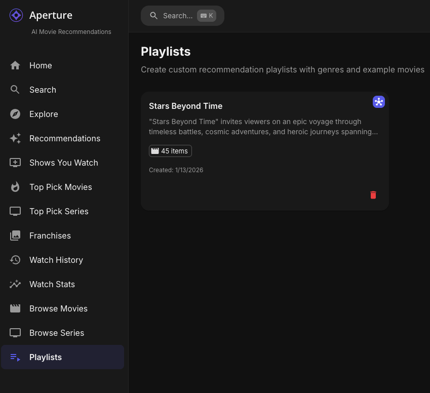

  • Graph playlists appear on the Playlists page with a hub icon badge
Managing Graph Playlists
  • View all playlists (both channel-based and graph-based) on the Playlists page
  • Delete with a confirmation dialog (no more accidental browser confirms!)
  • Graph playlists show their source item and item count

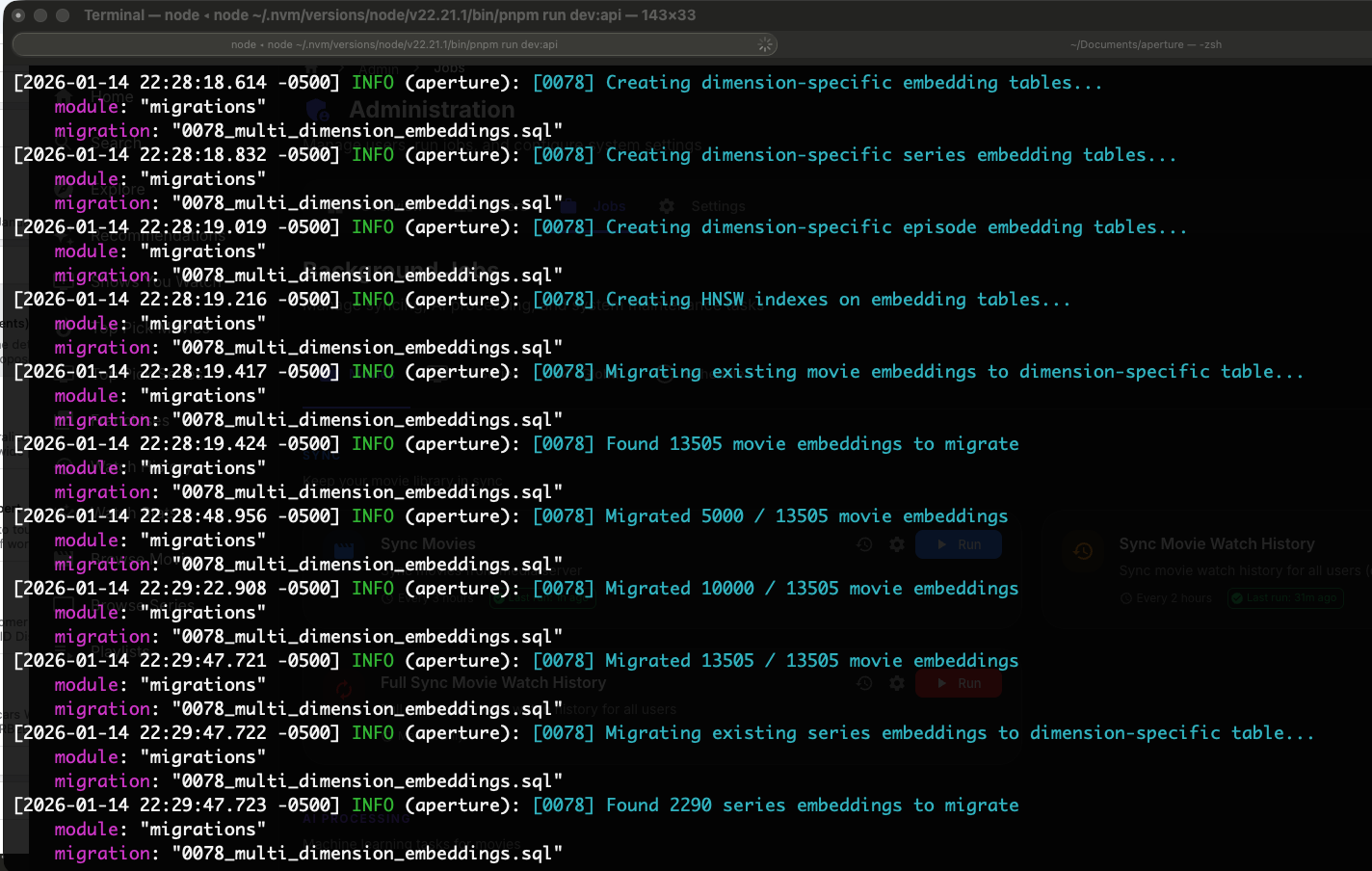

Migration Notes
Three new database migrations will run automatically:
  • 0072_similarity_validation_cache.sql
  • 0073_graph_playlists.sql
  • 0074_similarity_preferences.sql
No manual intervention required.

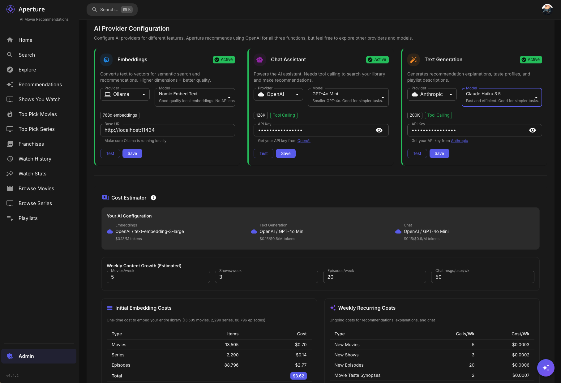

What is everyone selecting regarding OpenAI engines, plans and payments?
Looks like on the initial setup, I already ran out of freebees:
[5:47:02 PM] ✗ ❌ Batch failed: 429 You exceeded your current quota, please check your plan and billing details. For more information on this error, read the docs: https://platform.openai.com/docs/guides/error-codes/api-errors.
I don't want to give them a credit card and then find a $10,000 bill!
TheGru
[5:47:02 PM] ✗  Batch failed: 429 You exceeded your current quota, please check your plan and billing details. For more information on this error, read the docs: https://platform.openai.com/docs/guides/error-codes/api-errors.
1. Aperture should not run you much money at all on Open AI
2. You can configure Open Ai platform to set a max spend budget, so it will never go beyond what you are comfortable with.

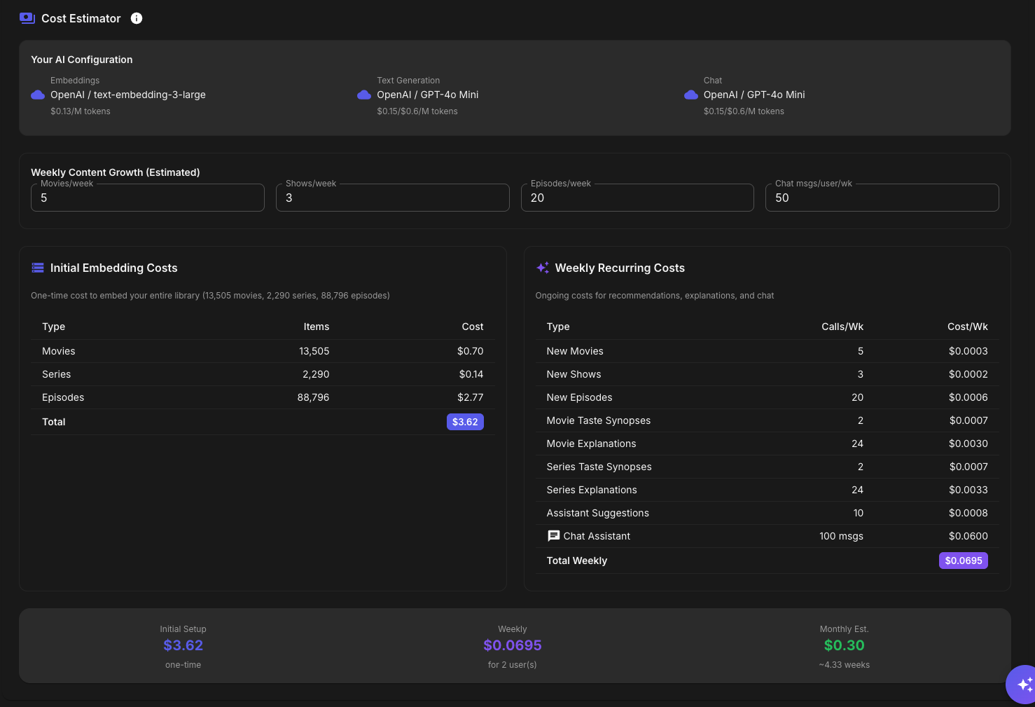

TheGru
I am also working on a cost estimator that takes things like your library size and estimated weekly content additions to your library in to consideration.

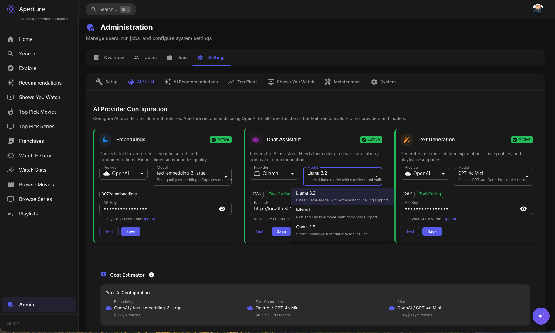

TeamB
have you experimented with ollama to see is self hosted models would work?
  • Like 1
  • Agree 1
TheGru
I have had the request to support it, I am building a branch using the Vercel AI-SDK now which supports many providers, OLLAMA being included so you can BYOAI.
It will be deployed to a different testing tagged and I will have more information when I need testers as I have no local LLMs setup here.
  • Agree 1
TeamB
the openai client should work directly with the ollama server with minimal to no changes, just set the base_url when creating the openai client to your local machine and it should work out of the box.
EDIT:
you would also need to change the model names for the embedding and chat calls
its going to be much slower and results might be lower quality but for cost conscious users or users with privacy concerns if it works it will no longer be a blocker for them.

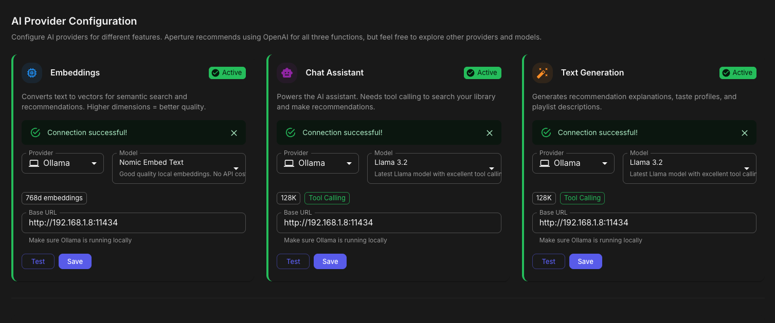

🚀 Aperture 0.4.2 Beta: Multi-LLM Support is Here!
Hey everyone! 👋
I'm excited to share a beta release of Aperture 0.4.2 featuring multi-provider AI/LLM support. This has been one of the most requested features, and it's finally ready for testing!
What's New?
🤖 Multi-Provider AI Support
You're no longer locked into OpenAI! Aperture now supports:

🎛️ Per-Function Configuration
The real power here is per-function provider selection. You can now mix and match:
Function Use Case Example Setup
Embeddings Semantic search, recommendations OpenAI text-embedding-3-large
Chat AI Assistant with tool calling Anthropic Claude 3.5 Sonnet
Text Generation Explanations, synopses Groq Llama 3 70B (fast & cheap)
Want embeddings from OpenAI but chat from Anthropic? Go for it!
💰 Dynamic Cost Estimation
The new AI / LLM Setup tab includes a cost estimator that:
  • Pulls real-time pricing from providers
  • Estimates costs based on your library size
  • Factors in your content growth rate
  • Shows $0.00 for self-hosted options (Ollama, LM Studio)

  • Setup Wizard Overhaul - Now includes multi-provider configuration
  • Admins can re-run setup - Click "Re-run Setup Wizard" anytime to reconfigure
  • Capability Detection - Warns you if a provider doesn't support features like tool calling
  • Automatic Migration - Existing OpenAI configs are automatically migrated

⚠️ Important: This will run a database migration that updates your embedding model names. If you've been using OpenAI embeddings, they'll be migrated to the new format automatically. THIS COULD TAKE A FEW MINUTES, BE PATIENT. Aperture logs will show you progress.

I setup Ollama on my unraid, and pulled in the models
Run these on your Ollama server:
# Chat/Text Generation models
ollama pull llama3.2
ollama pull mistral
ollama pull qwen2.5
# Embedding models
ollama pull nomic-embed-text
ollama pull mxbai-embed-large
ollama pull all-minilm
Or all at once:
for model in llama3.2 mistral qwen2.5 nomic-embed-text mxbai-embed-large all-minilm; do
  ollama pull $model
done
  • Like 1

TheGru
There will be a migration to reorganize existing embeddings... let it run it's not locked up
on unraid the above looks like this:
Aperture WEB UI will not be available until the migration completes and the API launches, until then you would see a 502 bad gateway error if you try and load the web interface.
Edited by TheGru

So in my Unraid server I have a NVIDIA Quadro P2000 worthless for anything AI
And the onboard intel GPU, which the Ollama container I installed can leverage... but my lord is this painfully slow. There is no universe where the negligible amount of money spent on OpenAI would ever be worth avoiding relative to your time!
In the period of ~5 minutes Ollama has spit out 2 recommendation vs ~48 seconds to generate 24, but you all do what you want!
TeamB
that sounds a little slow, do you think it is the embedding or the chat that is slow?
I tried to set it up but got stuck on the initial setup at the select embedding stage, the drop down was empty.
