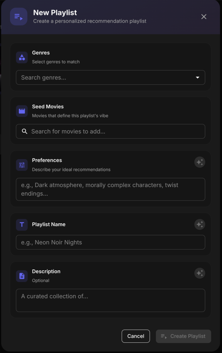

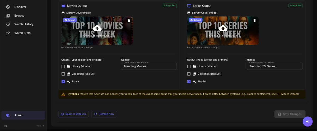

Jdiesel 1435 Posted January 24 Posted January 24 I noticed that Top List playlists aren't being generated. Manually created playlist do work and show up in Emby though. Playlists seem to work good with the new Home Screen Editor. Would it be possible to include playlists as an output option for AI Recommendations too? Also would it be possible to add the options to specify between movies, TV series or both when manually creating a playlist?
TheGru 149 Posted January 25 Author Posted January 25 7 hours ago, Jdiesel said: Does this have any implications for Aperture? "Creating a home screen section based on a playlist, collection, genre or tag." it will when I build against this newly release feature! But I am going to need a week, as I am tied up with a massive project
Jdiesel 1435 Posted January 25 Posted January 25 1 minute ago, TheGru said: it will when I build against this newly release feature! But I am going to need a week, as I am tied up with a massive project I've been testing it with playlists and it works pretty good so far. In addition to user recommendation playlists, things that would be nice to haves: Global playlists that can be shared/enabled across multiple users (playlist management) Task to re-generate user/admin created playlists on a set interval I didn't see anything in the Emby API that would allow a 3rd party app to create the home screen sections directly but having dynamic playlists should be a nice way to use the feature once it is manually setup. Looking forward to seeing what you come up with. 1

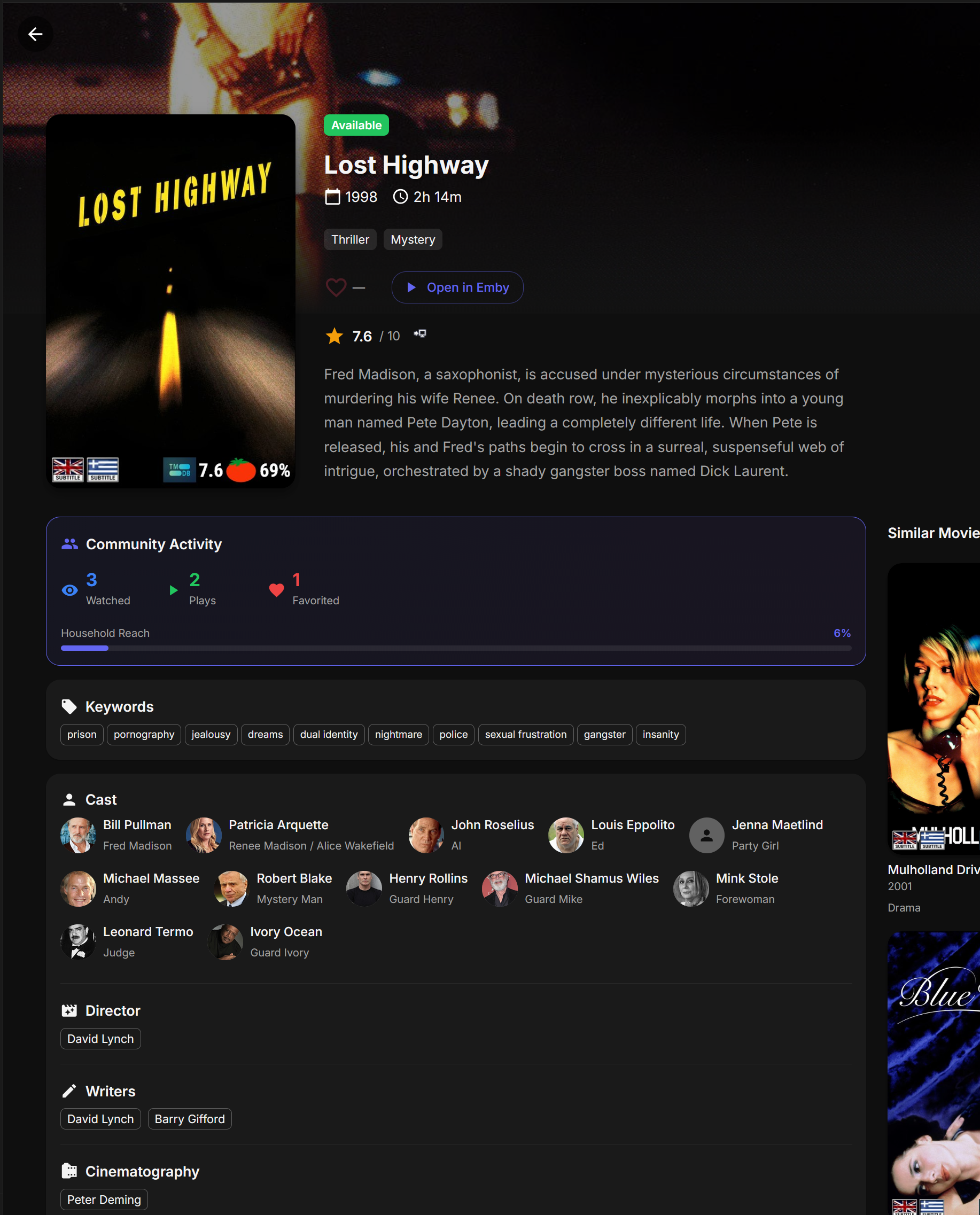

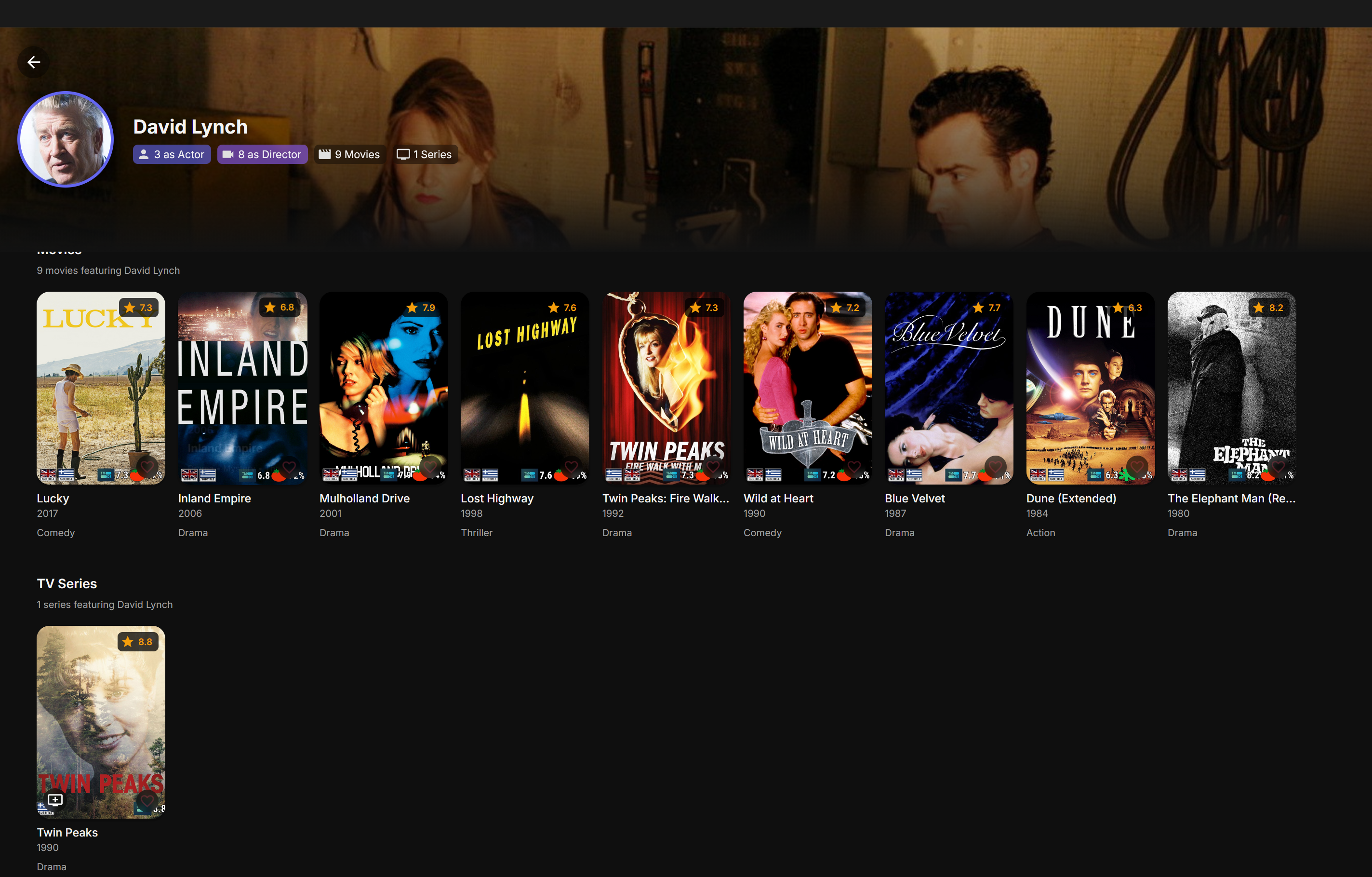

akacharos 31 Posted January 29 Posted January 29 A little UI discrepancy: While all persons exist as entities, they are not hyperlinks on movie details. Eg. All persons are simple text While they exist under /person/[Person Name] url (eg. /person/David Lynch)
