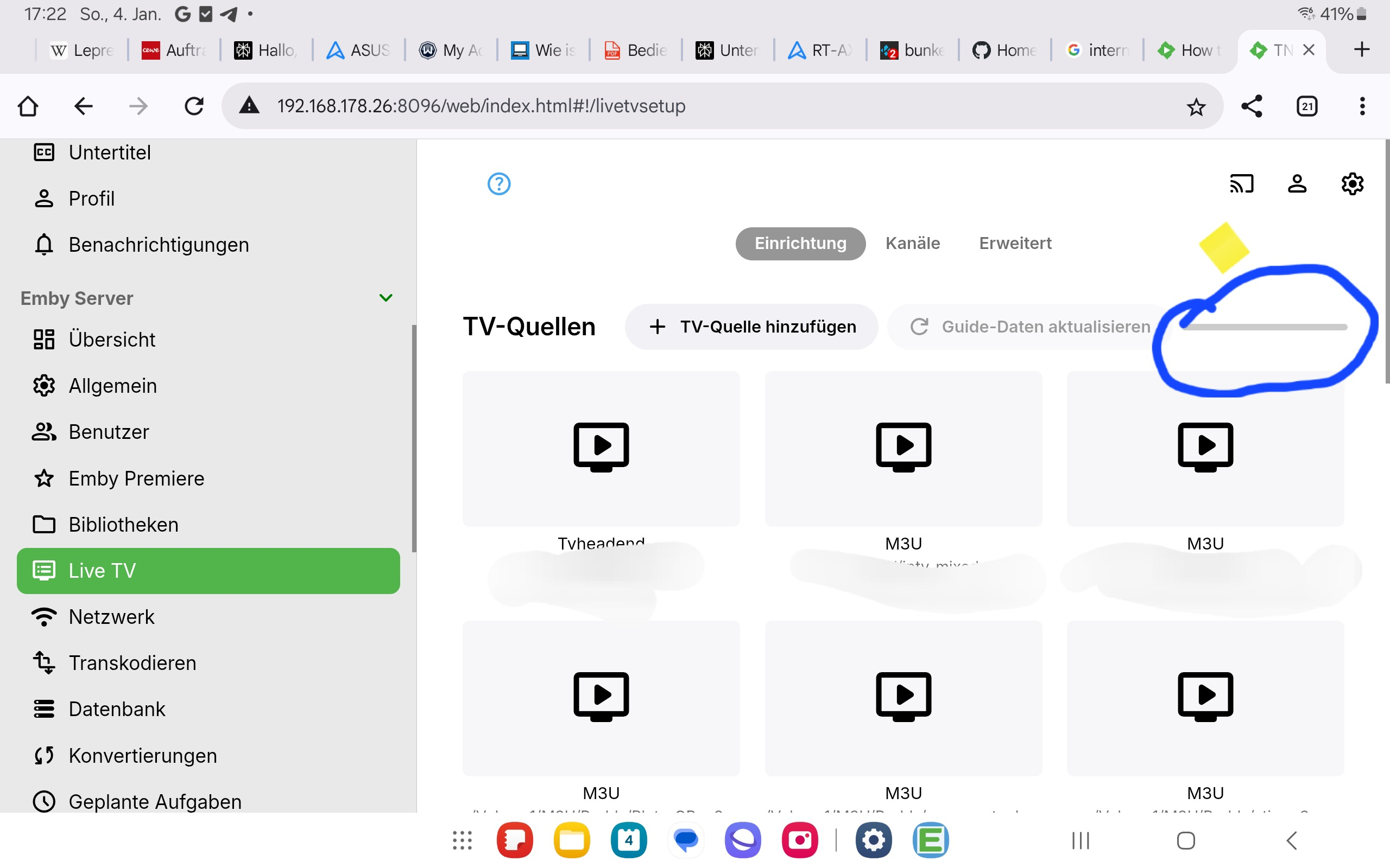

Hausmeier 7 Posted January 3 Posted January 3 (edited) Hey, I deleted aTV source (tv-Headhead) but the channels won't disappear in the channel list. On the other hand new tv-sources aren't added anymore. What could I do? If you need some logs just tell me. Don't know what to do anymore. Thanks anymore Edit: I think things were just not updated. If I update epg guide or channel list I only see the white bar which doesn't get green. It just disappears after some minutes. The new sources are listed in the settings or the deleted ones are removed in the settings but it has no influences on the live-tv list Edited January 3 by Hausmeier

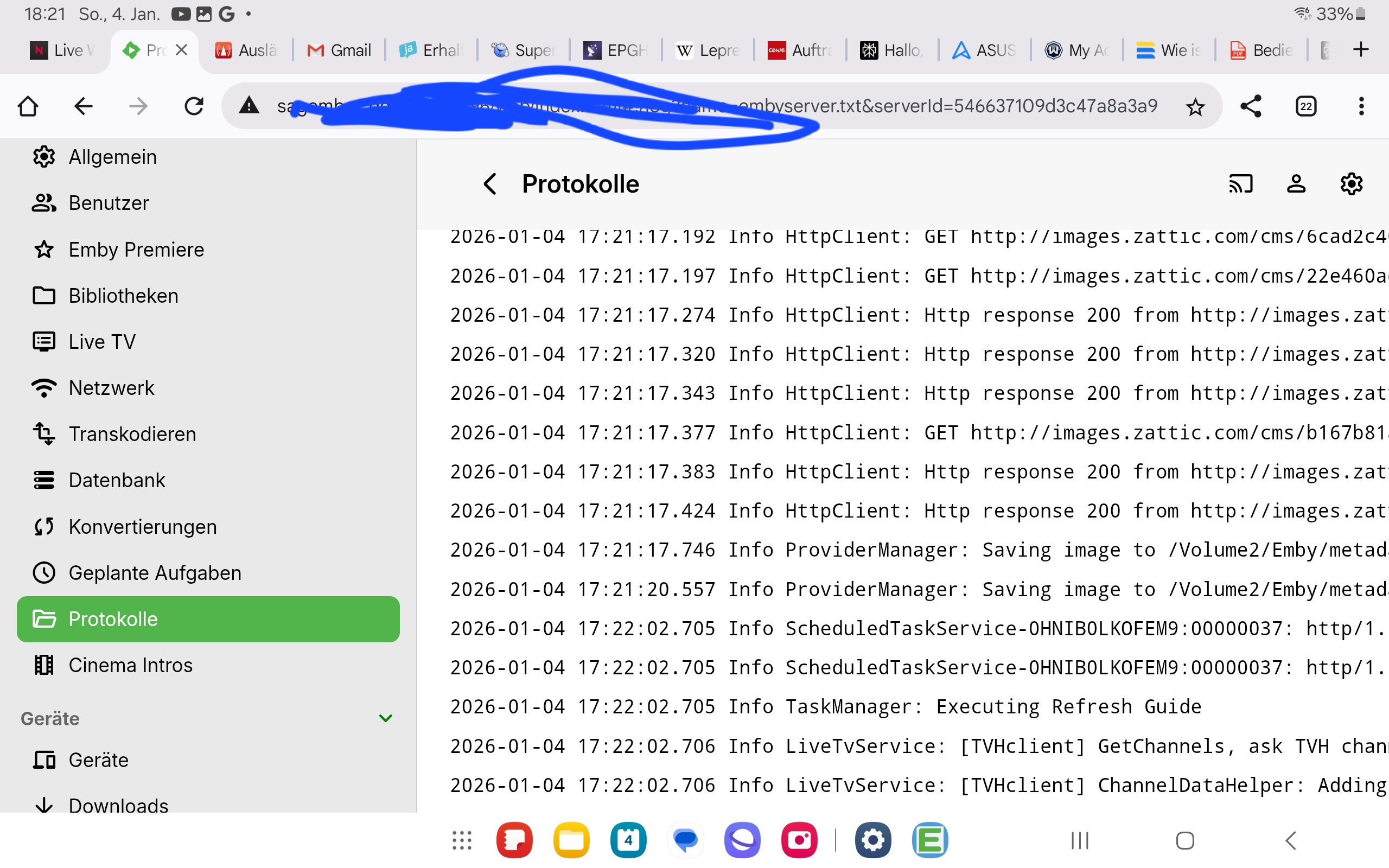

Hausmeier 7 Posted January 4 Author Posted January 4 (edited) I post 2 screenshots: First one showing the Bar Erich doesn't get Green weile updaten Guido. Second showing one Part of the log file (time wenn I updated guide). If you need whole logfile or anything Else, please let me know Edited January 4 by Hausmeier
Luke 42234 Posted January 4 Posted January 4 Hi, please attach the complete Emby server log file. Thanks.

Hausmeier 7 Posted January 9 Author Posted January 9 Well Do you have a clue how long it takes? Like I showed in the photo above I waited until the progres Bar that I circeled disappeared. But like I said it just disappeared and didn't turn Green...
