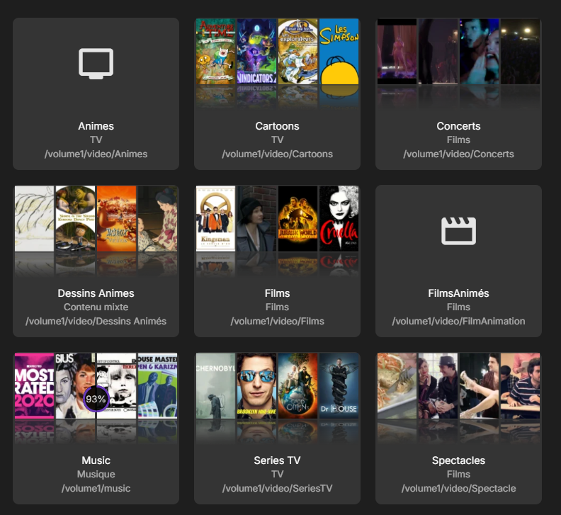

stream34000 2 Posted January 3 Posted January 3 Hi there, i'm using Emby Server 4.9.1.90 for synology. All my folder are reconised exept one... the "Animes". I think i've correctly param the emby app using system users rights. but this folder don't want to work no matter what i'm trying... i'm also using the nomenclature for tvdb. The thing i can't explain, jellyfin can read all the folders without any modifications. Why Emby don't want to work properly ? What i'm doing wrong ? (am also using AniDB and AniList for anime metadata) Thanks for your help

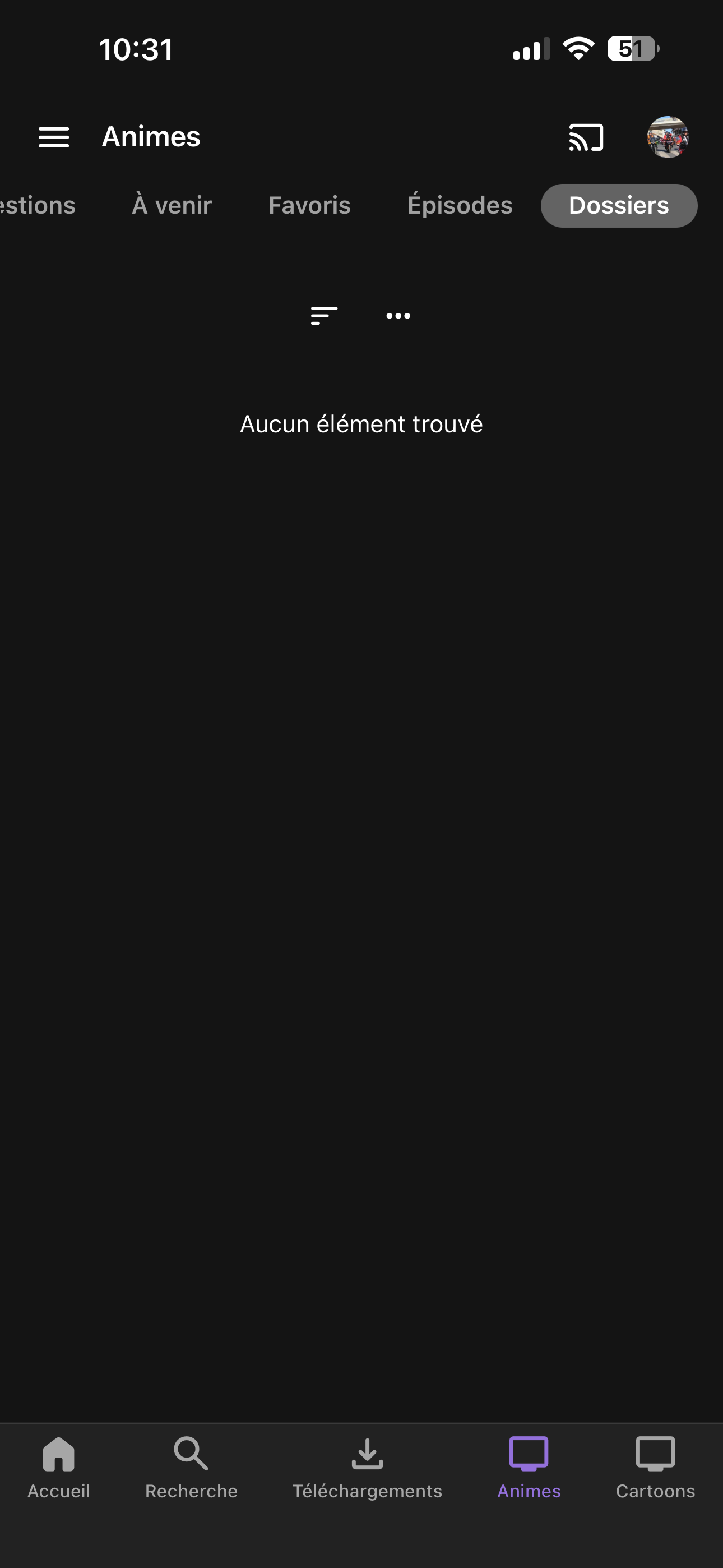

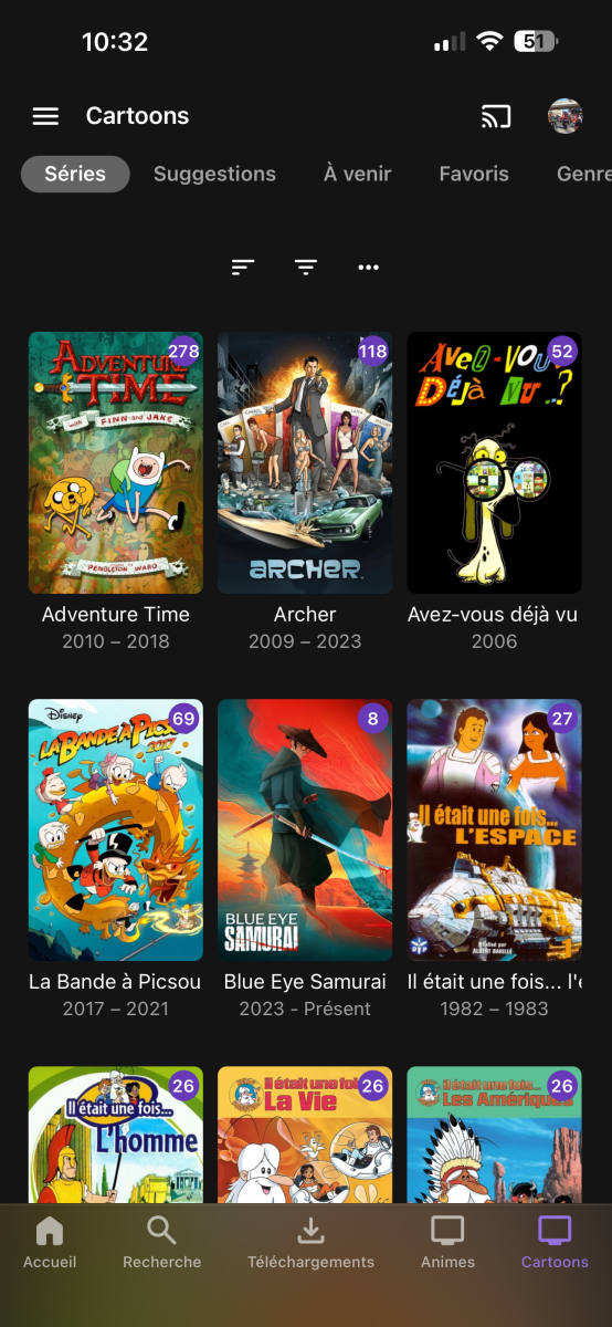

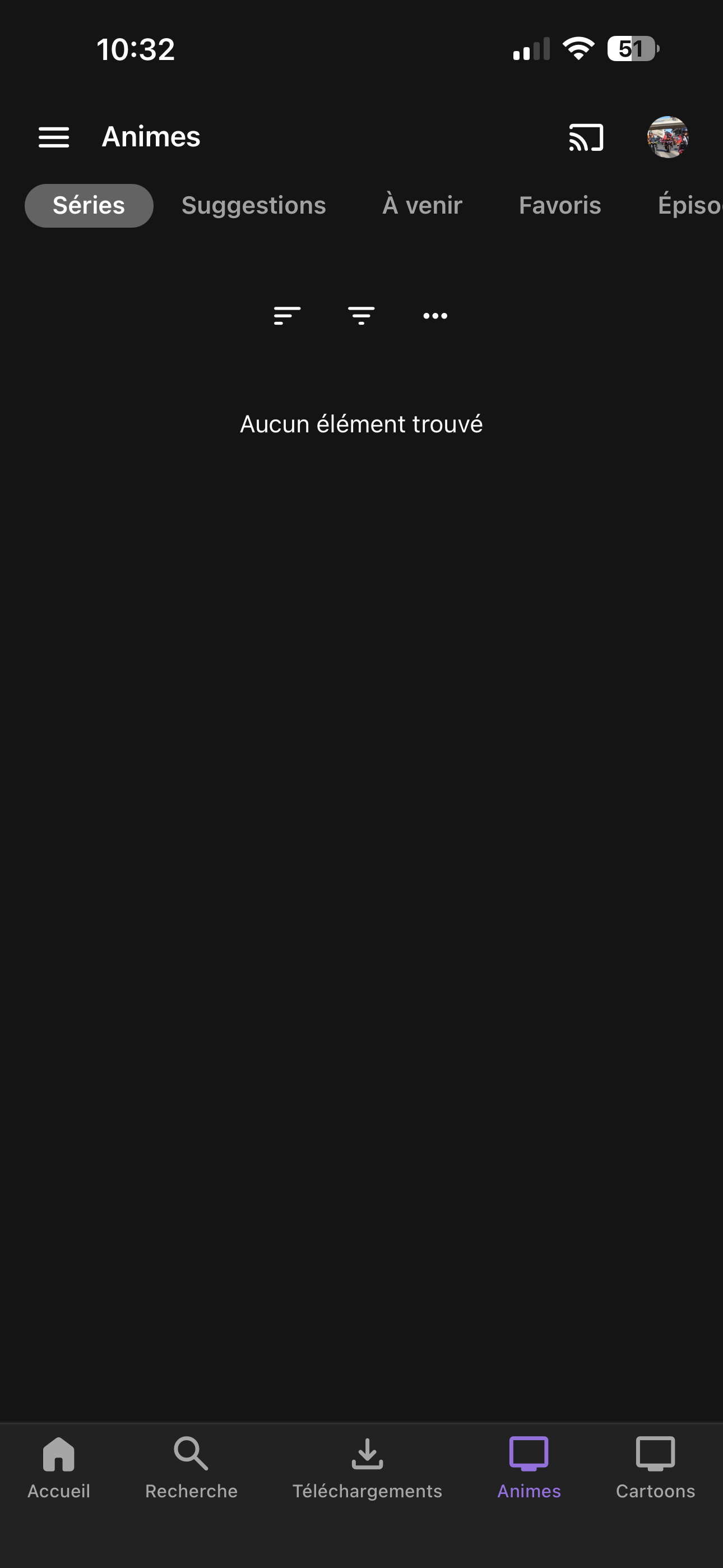

stream34000 2 Posted January 4 Author Posted January 4 Hi Luke, thanks for your answer. i think that because this folder is the only one who stays empty after a complete metadata update of the whole library. all the folders inside the folder « videos » are recognized, the files are available in every view of emby (for example the cartoons can be used in the following view : series, suggestions, à venir etc…) the anime one stays desperately empty even on the folder view
