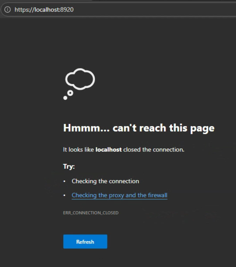

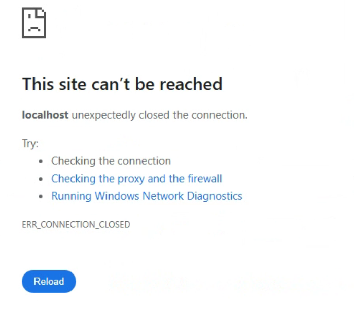

juerg 0 Posted January 15 Author Posted January 15 20 hours ago, Lessaj said: I don't see anything in your logs that would indicate there's anything preventing access to 8920 on localhost, that has nothing to do with your networking equipment it's completely local to the device. If that doesn't work, it'll never work from anywhere else either. What error are you seeing in the web browser when trying to connect to: https://localhost:8920 Hi here are the messages from chrome and edge, the same happens for 192.168.1.160 and 127.0.0.1

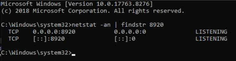

Lessaj 486 Posted January 15 Posted January 15 Hm, I'm not sure at this point, there shouldn't be anything preventing that from connecting, there's no error related to the certificate. I suppose make sure the port shows as listening is the first thing to check. netstat -an | findstr 8920
Lessaj 486 Posted January 15 Posted January 15 That looks correct to me. I can't see it being a missing firewall rule especially when using localhost but I you could check for that, it should add them automatically when you install Emby Server even if you don't set up HTTPS. I suppose at this point you could try to telnet to the port to see if the connection is accepted (may need to add the Telnet Client feature to use that), and use openssl to verify that a certificate is being presented (would need to get an OpenSSL binary for Windows). telnet localhost 8920 With openssl installed you can try to just connect and see the certificate being presented. openssl s_client -connect localhost:8920
