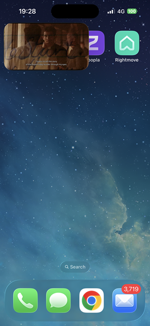

starisme 5 Posted January 13 Author Posted January 13 I created a 20 min test file and forced transcoding by reducing the quality in the player. The video took about 5-10 mins before it would play, I just let my phone continue to load. Unfortunately subtitles did not show, even delayed on the entire 20 min segment but I was able to see a glimpse of subtitles moving back to fullscreen from PIP almost like the overlay is under the video. I watched the entire clip just to be sure and that's the only time I could see any subtitles. Attached are the server log and transcode log. Really appreciate the continued help with this! embyserver.txt ffmpeg-transcode-08079309-8837-4321-b4f4-553463f986fa_1.txt

sa2000 696 Posted January 13 Posted January 13 4 hours ago, starisme said: I created a 20 min test file and forced transcoding by reducing the quality in the player. The video took about 5-10 mins before it would play, I just let my phone continue to load. Unfortunately subtitles did not show, even delayed on the entire 20 min segment but I was able to see a glimpse of subtitles moving back to fullscreen from PIP almost like the overlay is under the video. I watched the entire clip just to be sure and that's the only time I could see any subtitles. Attached are the server log and transcode log. Really appreciate the continued help with this! Just tested your 20 minute file - on iPhone through cellular connection running Emby for iOS 2.2.46 and reducing quality as you did to 1080p 4Mb I selected the English subtitles and played from beginning after selecting the subtitles. Tested both on screen and PIP and subtitles appeared ok for me and there was no delay in starting playback. Tested with 2 servers - 4.9.3.1 (with https) and beta 4.9.4.1 (with http) and both worked fine. I only played the first 1 minute of the 20 minute video as there were no issues with the start of playback or subtitles Attached screenshots shows subtitles showing I did not have hardware acceleration enabled but I do not expect that to be a factor. You could try with it disabled and see Could you try through a cellular connection and reduced quality without going through the reverse proxy to see how that behaves? Is there any traffic monitoring you can add for the reverse proxy to help identify if any packets being dropped or delays ?
sa2000 696 Posted January 13 Posted January 13 5 hours ago, starisme said: watched the entire clip just to be sure and that's the only time I could see any subtitles Sorry - did not mention that the logs you attached do not show any vtt segment (subtitles) requests from the Emby for iOS app reaching the server during the playback test during 10:10 am to 10:15 am
