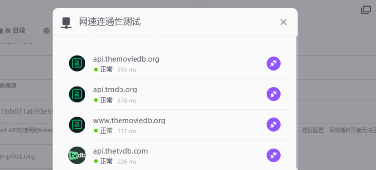

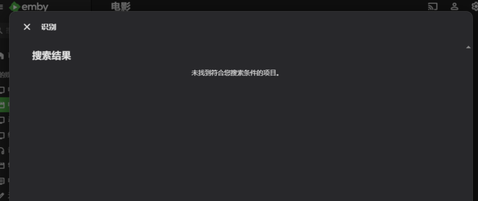

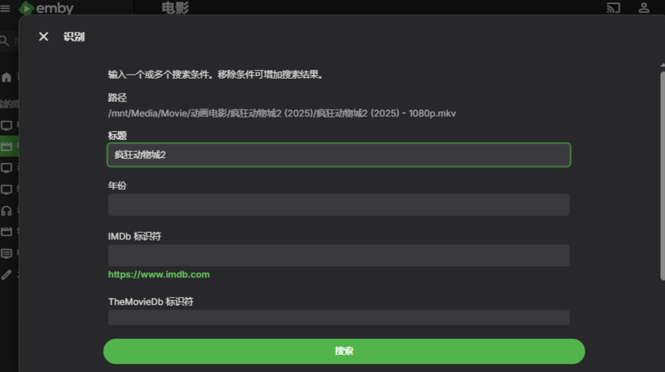

vluobotou 1 Posted December 29, 2025 Posted December 29, 2025 (edited) I am a member from China and need to recognize and catalog content in Chinese. I have tried searching for "疯狂动物城2" multiple times, but it keeps being recognized as "Accountant 2." After checking the logs, I found that the official IMDb API seems to have failed and there are also errors in Chinese recognition. The IMDb recognition service is unavailable (the network connection is normal). I also tried the official Douban plugin, but its API appears to have failed as well. If possible, could users be allowed to fill in their own IMDb API key? embyserver.txt Edited December 29, 2025 by ebr removed sensitive info

vluobotou 1 Posted December 29, 2025 Author Posted December 29, 2025 30 minutes ago, Luke said: HI, your connections to tvdb and moviedb are timing out and failing. Are they blocked in your area? It's not blocked
Luke 42150 Posted December 29, 2025 Posted December 29, 2025 OK then typical causes of this are firewall, security software or VPN. Can you look into those and let us know what you find?
vluobotou 1 Posted December 29, 2025 Author Posted December 29, 2025 2 hours ago, Luke said: 好的,那么造成这种情况的常见原因可能是防火墙、安全软件或VPN。您能检查一下这些方面,并告诉我们您的发现吗? I restarted the Emby service and the soft router, and the recognition is normal now. 1
