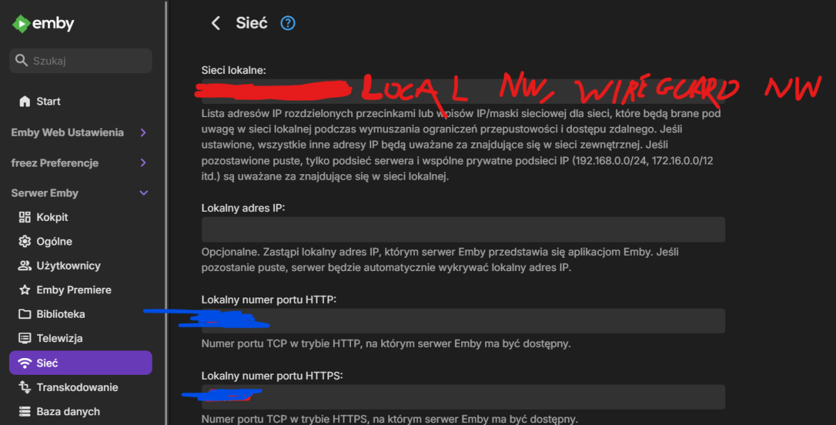

Solution aqualord 2 Posted January 3 Author Solution Posted January 3 OK Guys, I think that I found the resolution, ok, so the certificate is generated locally so I have a warning during attempting to connect to Emby Server but anyway with this certificate You are still able to use https instead of http in local Network (which I would like to use). So the problem with this certificate is maybe still valid if I would like to use Emby to connect from external Network but... if You use it only locally and via OpenVPN / Wireguard tunnel, just add a valid Wireguard Network address with a bitmask in: 1. Server Settings 2. Network 3. Local Network (1st text field) It will resolve the problem if You use Emby only locally and over VPN Tunnel. Hope that someone will find it helpfull 1

aqualord 2 Posted January 14 Author Posted January 14 (edited) OK, so that wasn't all, it started to work but only for a short time, the other thing is that I had a problem also using http without SSL. But I managed it anyway. This should help to You guys too. The full fix below: 1. Wireguard Settings a) if You don't use split tunnel: I just needed to add MTU size in the [Interface] section: MTU=1280 b) If You would like to use SPLIT Tunne: - Change the MTU like in point a) MTU=1280 - In the allowed IPs use not only local Network address but also Wireguard NW: AllowedIPs = 192.x.x.x/24, 198.x.x.x/24 2. Emby Server Settings 2a. Server Settings 2b. Network 2c. Local Network (1st text field) It will resolve the problem if You use Emby only locally and over VPN Tunnel. Hope that someone will find it helpfull Edited January 14 by aqualord 1
