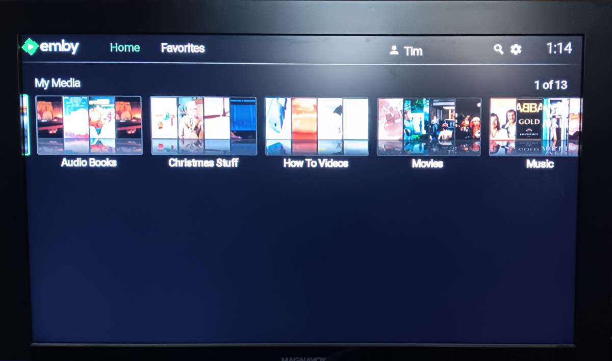

TechowlTim 2 Posted December 27, 2025 Posted December 27, 2025 I have Emby server running on my network, and it is working fantastic. The only issue I have is that when I use the Roku app to select the folder, the green highlight box is off the left side of the screen to the point where I can only see the right most green border of the selection box. This happens on one of Roku units, model number 3920X. The other one displays properly. Any info would be greatly appreciated. Thanks, - Tim -

TechowlTim 2 Posted December 28, 2025 Author Posted December 28, 2025 The TV is running at 1080P. No zoom is enabled, in fact when using HDMI on this set, it is not possible to adjust zoom at all. Everything has gone through several resets. The problem follows the Roku box. I set it up on a known good TV that had a different Roku on it, and it also cropped the the edge of the home screen. - Tim -

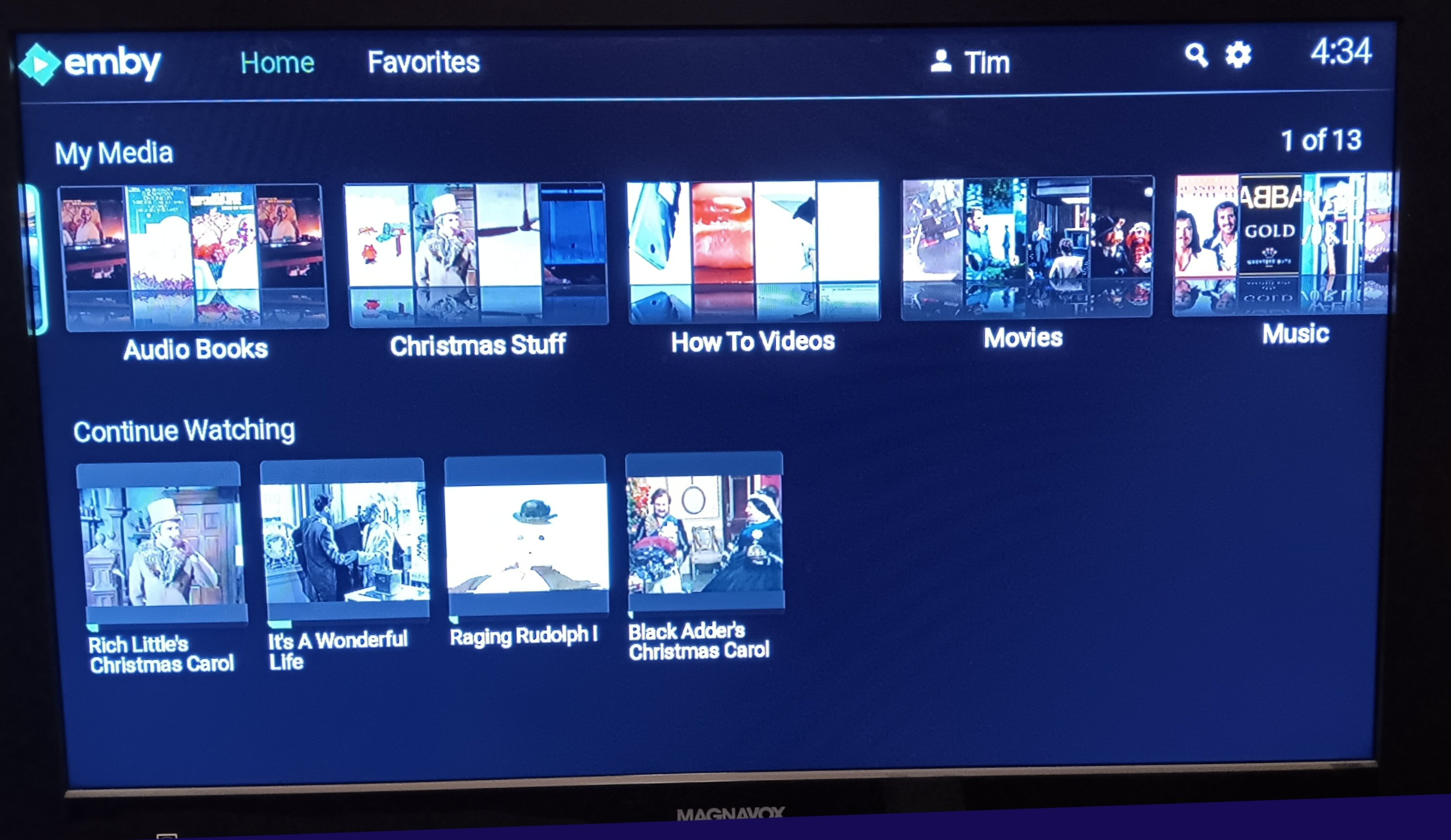

TechowlTim 2 Posted December 28, 2025 Author Posted December 28, 2025 OK, I found the source of the issue. It is the horizontal scroll option. If it is set to fixed, the selection box goes off screen. Set it back to floating and it returns to the first on screen box. This anomaly exists in both my Roku units. - Tim -
ebr 16332 Posted December 29, 2025 Posted December 29, 2025 18 hours ago, TechowlTim said: The TV is running at 1080P. No zoom is enabled, in fact when using HDMI on this set, it is not possible to adjust zoom at all. Are you sure? Because I can see in your picture that the padding around the app display is definitely cut off. However, this isn't the main problem as you've found out. If you add another row to your home screen, does the problem go away with the fixed scrolling?

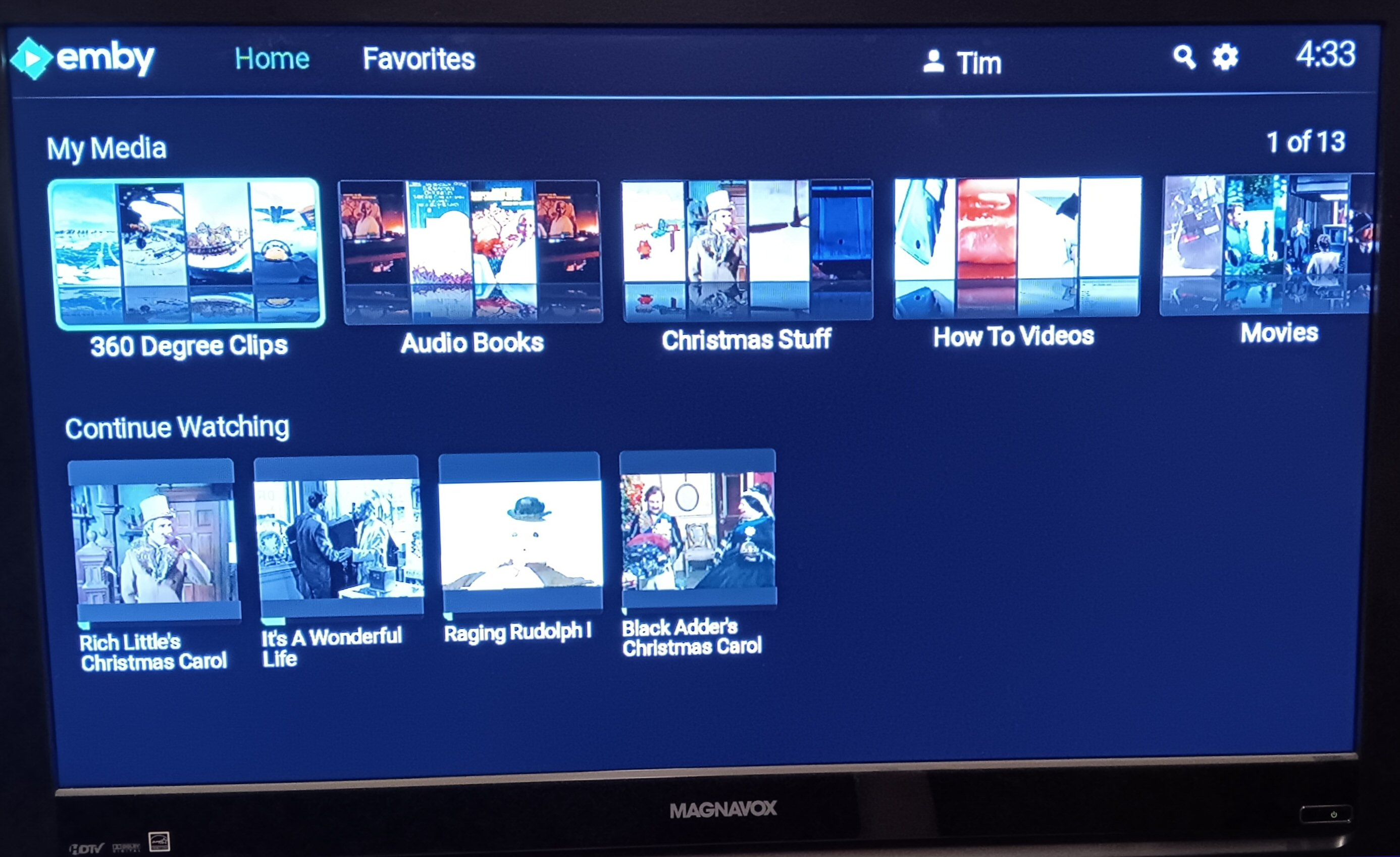

TechowlTim 2 Posted December 29, 2025 Author Posted December 29, 2025 OK, this TV is an older LCD one so the screen is more like a CRT, with overscan areas. The edges are always slightly inward on everything it shows. Secondly, the issue is still there with a second row present, although the second row is not offset to the left. The first pic is with fixed (offscreen), and the second is with floating (fully onscreen). - Tim -
ebr 16332 Posted December 30, 2025 Posted December 30, 2025 If you move to the second row and back, it fixes itself, right?
