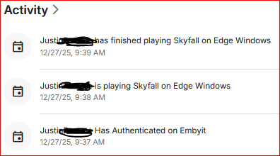

justinrh 266 Posted December 27, 2025 Author Posted December 27, 2025 (edited) I'm not sure I follow, but I don't think it is complicated. I put the remote machine on the home network and tested. Same result: with AC3 selected, the video does not play (no transcoding is happening on the server). Even as I'm typing this all I have is a spinner and yet Emby says the video has stopped playing. Seems like an issue to me. Issue with Windows 11? embyserver.txt At least we know it has nothing to do with a remote connection. (Please update the thread title for me.) Edited December 27, 2025 by justinrh
