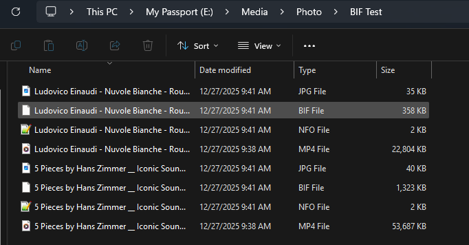

Happy2Play 9814 Posted December 27, 2025 Posted December 27, 2025 (edited) Don't see the process in either log creating the interval images. Example from my log adding your examples 2025-12-27 09:41:10.550 Info QuickImageSeriesExtractor: ProcessRun 'quick-extract-imageseries' Execute: C:\Users\Media\Desktop\TEST\system\ffmpeg.exe -f mp4 -threads 1 -skip_interval 10 -i file:"E:\Media\Photo\BIF Test\5 Pieces by Hans Zimmer __ Iconic Soundtracks __ Relaxing Piano [20min] - Jacob's Piano (720p, h264).mp4" -an -sn -vf "scale=w=320:h=180" -f image2 -b:v 100M "C:\Users\Media\Desktop\TEST\programdata\cache\temp\a0271eb8391440da8ddaca4b0462e129\img_%05d.jpg" 2025-12-27 09:41:10.556 Debug QuickImageSeriesExtractor: ProcessRun 'quick-extract-imageseries' Started. 2025-12-27 09:41:12.030 Info QuickImageSeriesExtractor: ProcessRun 'quick-extract-imageseries' Process exited with code 0 2025-12-27 09:41:13.157 Info QuickImageSeriesExtractor: ProcessRun 'quick-extract-imageseries' Execute: C:\Users\Media\Desktop\TEST\system\ffmpeg.exe -f mp4 -threads 1 -skip_interval 10 -i file:"E:\Media\Photo\BIF Test\Ludovico Einaudi - Nuvole Bianche - Rousseau (720p, h264).mp4" -an -sn -vf "scale=w=320:h=180" -f image2 -b:v 100M "C:\Users\Media\Desktop\TEST\programdata\cache\temp\5d5a00b62b05453caf74901143f54758\img_%05d.jpg" 2025-12-27 09:41:13.166 Debug QuickImageSeriesExtractor: ProcessRun 'quick-extract-imageseries' Started. 2025-12-27 09:41:13.708 Info QuickImageSeriesExtractor: ProcessRun 'quick-extract-imageseries' Process exited with code 0 bif files saved with media May need to see your library setting for Video Preview Thumbnails. Edited December 27, 2025 by Happy2Play

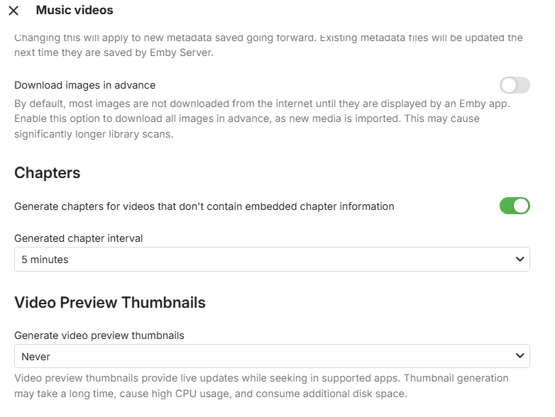

Happy2Play 9814 Posted December 28, 2025 Posted December 28, 2025 You do not have Preview images enabled at least on this library.
Nimasa 11 Posted December 28, 2025 Author Posted December 28, 2025 7 hours ago, Happy2Play said: You do not have Preview images enabled at least on this library. The preview images, while seeking, are not important for me, it's the functionality that is important for me. If you think enabling this option helps with the seeking functionality, I'll enable it.

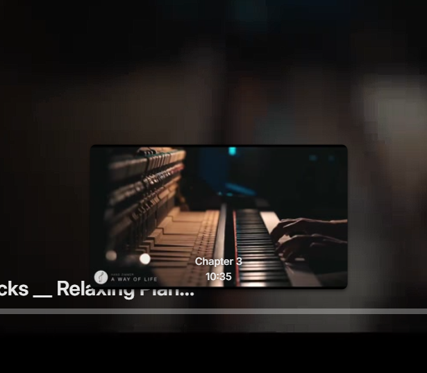

Happy2Play 9814 Posted December 28, 2025 Posted December 28, 2025 2 hours ago, Nimasa said: The preview images, while seeking, are not important for me, it's the functionality that is important for me. If you think enabling this option helps with the seeking functionality, I'll enable it. Unless I am miss understanding the issue you have to enable the preview option for seek preview images. ie shown in this image seek preview Or are you saying you are unable to seek at all in the clients? If so, I can't reproduce an issue in any client.
