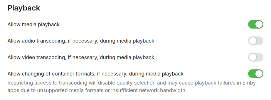

Guest Posted December 25, 2025 Posted December 25, 2025 3 hours ago, KodiaK said: I have an OLED TV (Sony A95K) and i noticed that when playing a movie via Emby i have very bad stuttering in panning shots. I can't read logs and no source of actual useful info but the first thing I would do is disable video and audio transcoding per user setting on the emby server. set your stream quality to 120mbps and not use auto. See if that helps anything.
KodiaK 3 Posted December 25, 2025 Author Posted December 25, 2025 Where are the video and audio transcoding options? I could not find anything relevant under User Settings or under Server>Transcoding. The stream quality (under Web settings>Playback) is set to 4K - 120Mbs

Guest Posted December 26, 2025 Posted December 26, 2025 (edited) 1 hour ago, KodiaK said: Where are the video and audio transcoding options? I could not find anything relevant under User Settings or under Server>Transcoding. The stream quality (under Web settings>Playback) is set to 4K - 120Mbs In the user settings on the server itself disable video and audio transcoding. So go to your user and there is checkbox options. Don't go to transcoding settings on the server. You need to be logged into the server as the admin. Than on the clients you are using to play the media set the max bitrate to 120Mbps. Edited December 26, 2025 by embaaa

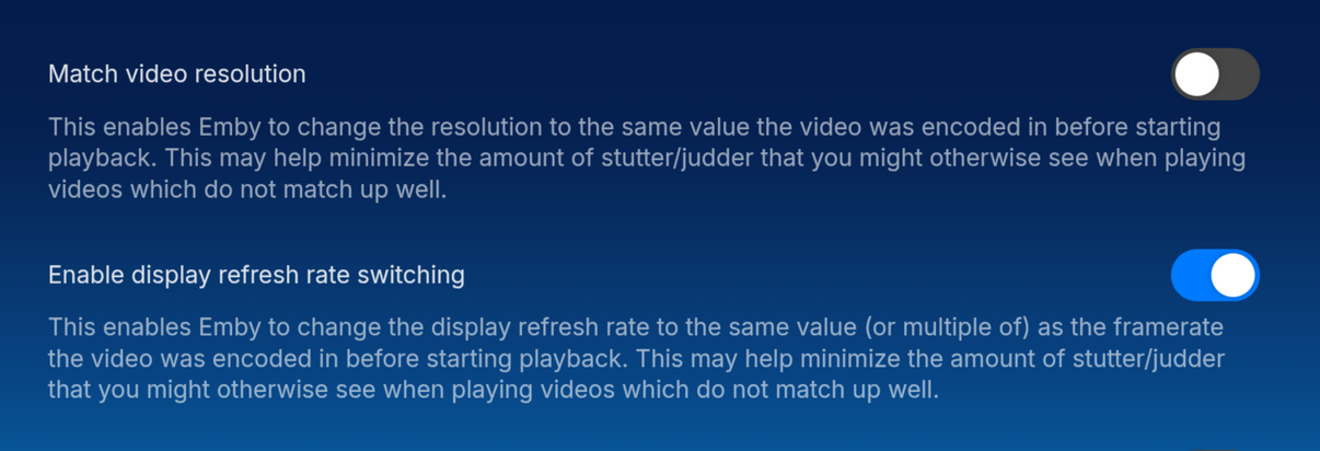

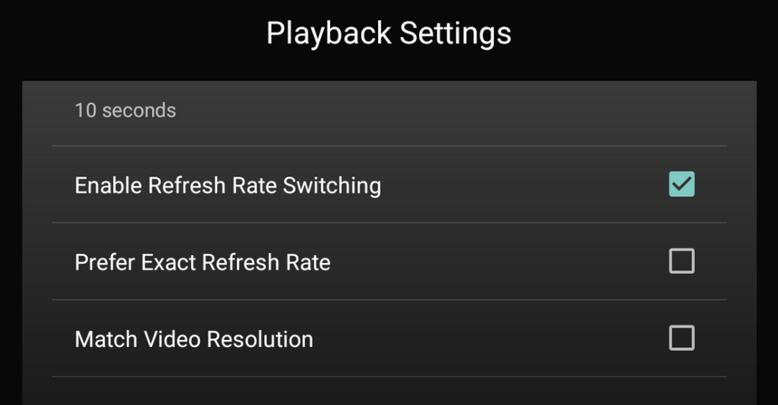

seanbuff 1356 Posted December 26, 2025 Posted December 26, 2025 5 hours ago, KodiaK said: Is there a setting somewhere in Emby which I am missing, that causes this stuttering?? Depending on which client app you're using, have you tried playing with the below options to see if any make a difference? Android TV app Standard Android App
yocker 1414 Posted December 26, 2025 Posted December 26, 2025 1 hour ago, embaaa said: Have you tried comparing the androidTV app vs the standard android app? If its direct playing for sure that would be an interesting test. No change. @seanbuffThose settings never seemed to do much for me unless it was for old cartoons, like from Disney ripped from DVD. I mean, i know what they are supposed to do, but nothing much changes. 1
seanbuff 1356 Posted December 26, 2025 Posted December 26, 2025 9 minutes ago, yocker said: No change. Yeah unfortunately I don't think they have any affect on built-in Android TV devices, but was worth a shot for OP to check anyway. Thanks for reporting back. 1
yocker 1414 Posted December 26, 2025 Posted December 26, 2025 2 hours ago, seanbuff said: Yeah unfortunately I don't think they have any affect on built-in Android TV devices, but was worth a shot for OP to check anyway. Thanks for reporting back. In case by built-in you mean like Smart TVs, the settings doesn't do much on my Nvidia Shield either to remove judder.

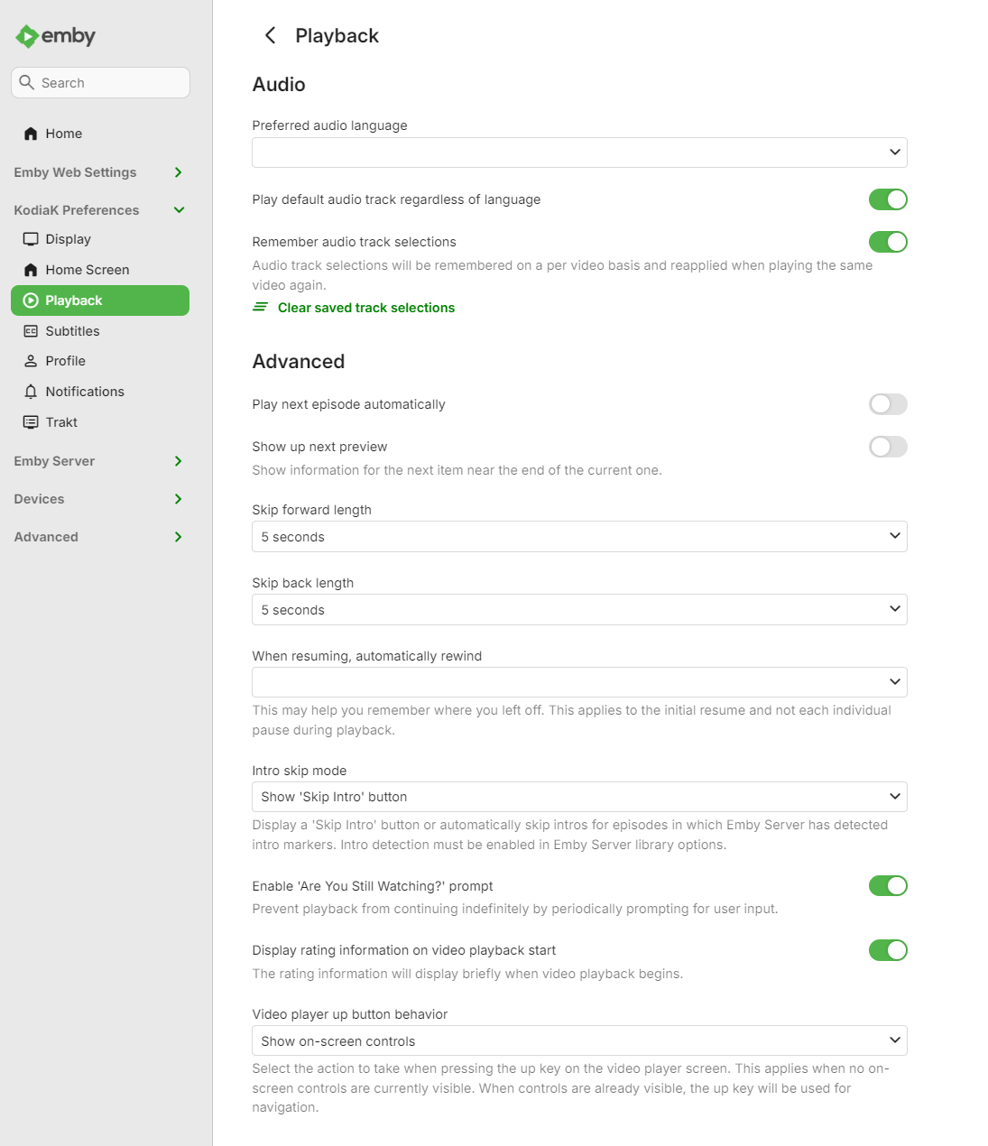

KodiaK 3 Posted December 26, 2025 Author Posted December 26, 2025 (edited) 7 hours ago, embaaa said: In the user settings on the server itself disable video and audio transcoding. So go to your user and there is checkbox options. Don't go to transcoding settings on the server. You need to be logged into the server as the admin. Than on the clients you are using to play the media set the max bitrate to 120Mbps. I am sorry but on my side the playback menu looks different. So, on the PC where the server is installed I go to systray and rclick on emby icon>Configure emby. The server config opens in a browser page and from there I went to the screenshot above. On the TV I have installed the Android TV app, I assume, from the available apps I found on the store there. A lot less apps then i would find on a standard android device (like phone or tablet), so I assume all the apps here are Android TV apps. Is there a way to check exactly what app i have on the TV? Edited December 26, 2025 by KodiaK
Guest Posted December 26, 2025 Posted December 26, 2025 (edited) @KodiaK I said you need to be looking at the server settings. The user section. from this screen shot go select the user that you are using and you will see the option to disable audio and video transcoding. Edited December 26, 2025 by embaaa

KodiaK 3 Posted December 26, 2025 Author Posted December 26, 2025 2 hours ago, embaaa said: @KodiaK I said you need to be looking at the server settings. The user section. from this screen shot go select the user that you are using and you will see the option to disable audio and video transcoding. Found it, thanks. I went here initially, but realize i had to click my user after, to get to the screen you mentioned. I disabled auto transcoding, replayed the section that stuttered before and now it was a lot better. Then i wen beck and enabled auto transcoding and checked the Dashboard and it said direct play at both audio and video. So the option basically does nothing. I checked the same section again, and now it's also smooth... So i don't understand at all. Basically now i have the exact same settings as before, but now playback is smooth. And it was not an isolated issue. I have 2 movies that i watched the past couple of weeks where I had to switch to Plex due to horrible stuttering. I will check some other movies during the holidays and see if it's really fixed. Regarding Motionflow, unfortunately on OLED TVs, due to extremely low pixel refresh rate, panning shots look very chunky On low or medium, the artifacts are almost non-existent, so there's barely any trade-off
Guest Posted December 26, 2025 Posted December 26, 2025 7 hours ago, KodiaK said: Found it, thanks. I went here initially, but realize i had to click my user after, to get to the screen you mentioned. I disabled auto transcoding, replayed the section that stuttered before and now it was a lot better. Then i wen beck and enabled auto transcoding and checked the Dashboard and it said direct play at both audio and video. So the option basically does nothing. I checked the same section again, and now it's also smooth... Your best to just keep trancoding disabled though because you never want to transcode. For all you know it was transcoding when you experienced the issue.
Luke 42243 Posted December 27, 2025 Posted December 27, 2025 On 12/26/2025 at 5:34 AM, KodiaK said: Found it, thanks. I went here initially, but realize i had to click my user after, to get to the screen you mentioned. I disabled auto transcoding, replayed the section that stuttered before and now it was a lot better. Then i wen beck and enabled auto transcoding and checked the Dashboard and it said direct play at both audio and video. So the option basically does nothing. I checked the same section again, and now it's also smooth... So i don't understand at all. Basically now i have the exact same settings as before, but now playback is smooth. And it was not an isolated issue. I have 2 movies that i watched the past couple of weeks where I had to switch to Plex due to horrible stuttering. I will check some other movies during the holidays and see if it's really fixed. Regarding Motionflow, unfortunately on OLED TVs, due to extremely low pixel refresh rate, panning shots look very chunky On low or medium, the artifacts are almost non-existent, so there's barely any trade-off Hi, the option does not do nothing. You are not enabling or disabling transcoding with these options. You are allowing it or disallowing it. The distinction is you are choosing to allow transcoding or not, but whether it actually does or not depends on many other factors.
ebr 16335 Posted December 28, 2025 Posted December 28, 2025 On 12/26/2025 at 1:30 PM, embaaa said: Your best to just keep trancoding disabled though because you never want to transcode. For all you know it was transcoding when you experienced the issue. This is not true. It is much more likely to cause problems for you if you disable those options. What you describe sounds like frame rate judder and your example was a 24fps item.
