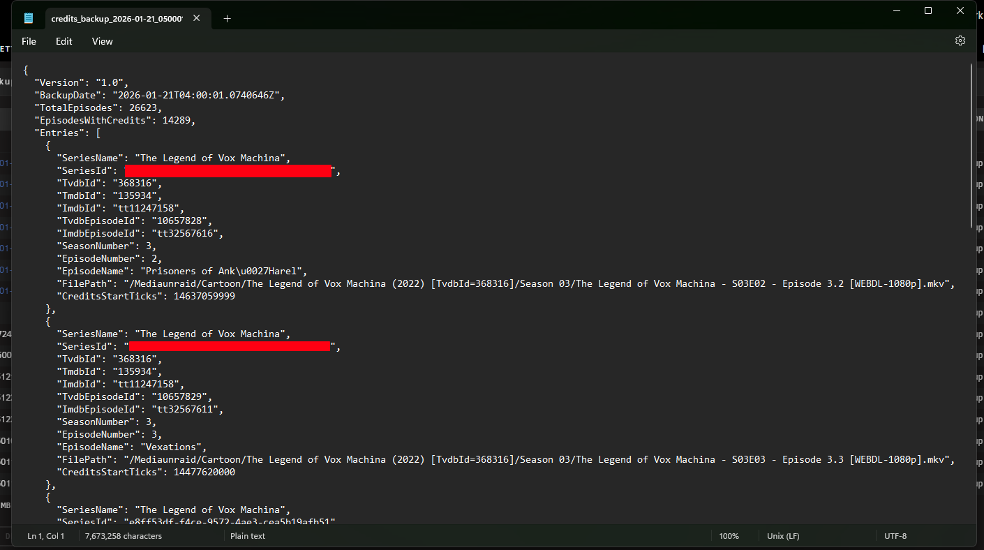

Ferwin29 7 Posted January 21 Posted January 21 Hi @yocker First, Thank you for your job, this plugin is wonderfull. I've got a problem on the backup task. When I launch it, the json's file has no credit, only : { "Version": "1.0", "BackupDate": "2026-01-21T06:30:16.48906Z", "TotalEpisodes": 0, "EpisodesWithCredits": 0, "Entries": [] } If I export in the plugin, all is good.
yocker 1329 Posted January 21 Author Posted January 21 1 minute ago, Ferwin29 said: Hi @yocker First, Thank you for your job, this plugin is wonderfull. I've got a problem on the backup task. When I launch it, the json's file has no credit, only : { "Version": "1.0", "BackupDate": "2026-01-21T06:30:16.48906Z", "TotalEpisodes": 0, "EpisodesWithCredits": 0, "Entries": [] } If I export in the plugin, all is good. @Neminemsame problem?
yocker 1329 Posted January 21 Author Posted January 21 21 minutes ago, Ferwin29 said: Hi @yocker First, Thank you for your job, this plugin is wonderfull. I've got a problem on the backup task. When I launch it, the json's file has no credit, only : { "Version": "1.0", "BackupDate": "2026-01-21T06:30:16.48906Z", "TotalEpisodes": 0, "EpisodesWithCredits": 0, "Entries": [] } If I export in the plugin, all is good. Found the problem, will be fixed in the next version which is nearly ready. 1

Ferwin29 7 Posted January 21 Posted January 21 The backup task's problem is resolved for me . Thanks @yocker 1

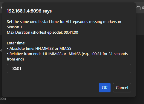

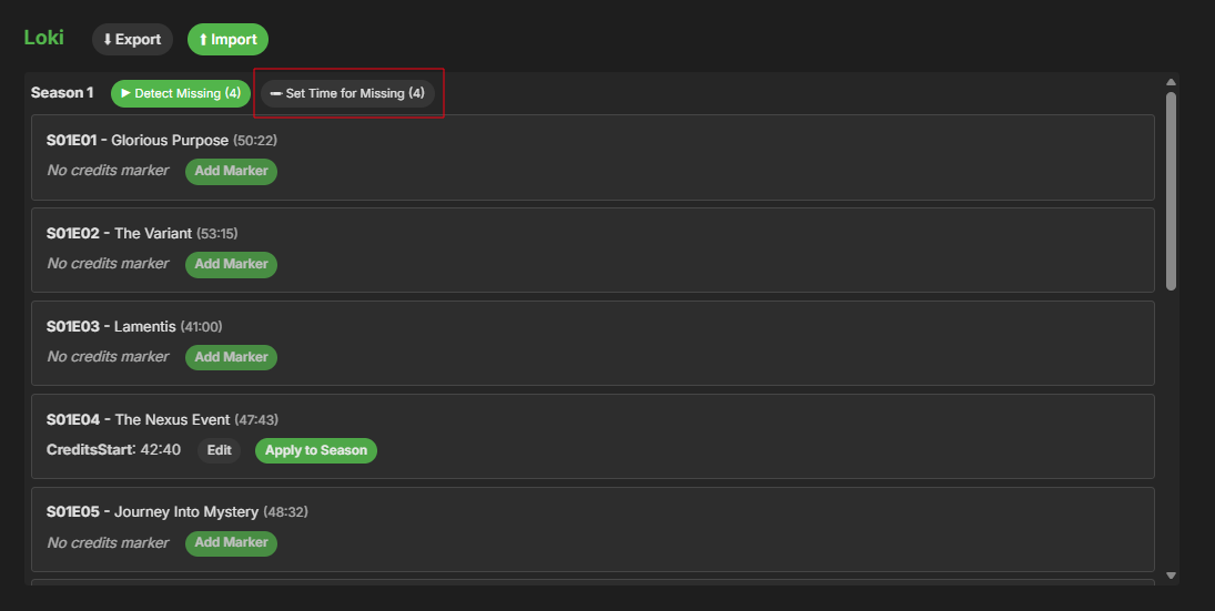

sydlexius 297 Posted January 21 Posted January 21 @yockerAny possibility to add the ability to set a flag to skip episodes/seasons/series? I just checked some of my content that's re-running, and they truly lack end-credits. 1
Neminem 1580 Posted January 21 Posted January 21 @sydlexiuswhen I identify those, I do this. That will put a marker at duration -1 sec on all episodes in that season. 1 1

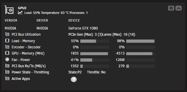

Neminem 1580 Posted January 22 Posted January 22 I run it on this. But I have seen it max out VRAM and stall, but 30sec later it continues. I'm guessing it retries for those 30sec, and then discards the image, and moves on. 1 1
yocker 1329 Posted January 22 Author Posted January 22 (edited) 6 hours ago, sydlexius said: Yikes! What sort of GPU/VRAM is needed to run the models it uses? All GPU enabled tesseract I can find are that big. I think it's a mix of things, the cuda drivers alone are huge. It made a 4090 almost choke, but as said instant detections Edit: I could maybe try and transfer the models from the normal tesseract. Edited January 22 by yocker

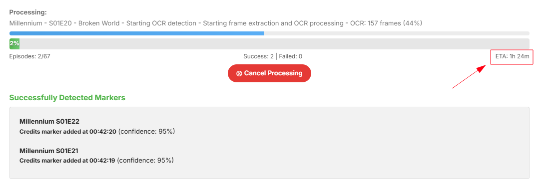

yocker 1329 Posted January 22 Author Posted January 22 1 minute ago, Neminem said: This is detection with GPU Would need something to compare with.
Neminem 1580 Posted January 22 Posted January 22 (edited) Will rerun it with CPU Stay tuned for email screenshot Edited January 22 by Neminem 1
yocker 1329 Posted January 22 Author Posted January 22 Credits Detector — Mozilla Firefox 2026-01-22 12-33-44.mp4 You can set the worker, thread and core count to match your CPUs for the tesseract and you can get very fast speeds out of it. What you see in the video is where it's set to use maximum. Could probably improve EmbyCredit settings a bit as well but just put it at 10 frames at a time. So it's not because the CPU version is slow, it uses a very small and efficient model. By default it's set relatively low so as to not absolutely nuke some systems from orbit. 1
Neminem 1580 Posted January 22 Posted January 22 (edited) For some reason I did not get a email notification, about the CPU test. Guess notifications are not send when doing a dry run Start time 12:48 Finish time 14:17 Total time 1 hour 29 min. 2026-01-22 12:48:55.892 Info CreditsDetectionApiService: Series found: Millennium, InternalId: 128621 2026-01-22 12:48:55.921 Info CreditsDetectionApiService: Found 67 episodes for series InternalId: 128621 (excluded 1 specials) 2026-01-22 12:48:55.923 Info Plugin: Cleared in-memory batch detection cache and processing queue for fresh detection 2026-01-22 12:48:55.924 Info Plugin: Queued 67 episodes for processing (forced reprocess). Queue size: 67 2026-01-22 14:17:05.896 Info Plugin: Processing complete: 67 succeeded, 0 failed Edited January 22 by Neminem
yocker 1329 Posted January 22 Author Posted January 22 11 minutes ago, Neminem said: For some reason I did not get a email notification, about the CPU test. Guess notifications are not send when doing a dry run Start time 12:48 Finish time 14:17 Total time 1 hour 29 min. 2026-01-22 12:48:55.892 Info CreditsDetectionApiService: Series found: Millennium, InternalId: 128621 2026-01-22 12:48:55.921 Info CreditsDetectionApiService: Found 67 episodes for series InternalId: 128621 (excluded 1 specials) 2026-01-22 12:48:55.923 Info Plugin: Cleared in-memory batch detection cache and processing queue for fresh detection 2026-01-22 12:48:55.924 Info Plugin: Queued 67 episodes for processing (forced reprocess). Queue size: 67 2026-01-22 14:17:05.896 Info Plugin: Processing complete: 67 succeeded, 0 failed No, dry runs shouldn't get a notification. I can add it if you want. Heh wow.. From 5 minutes to 90 minutes, quite the change. Maybe i should move to that build instead then if it can help people that much. I does seem somewhat slow though, what CPU are you running?

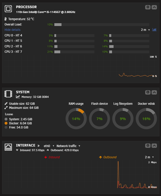

Neminem 1580 Posted January 22 Posted January 22 (edited) Jep its really slow compared to my using GPU. Even though paddelocr is hosted on my main server with the GPU. Here is my system info. I would guess its an average server, small foot print. Edited January 22 by Neminem
yocker 1329 Posted January 22 Author Posted January 22 (edited) That CPU shouldn't be that slow.. POOL_DEFAULT_MIN=2 POOL_DEFAULT_MAX=6 POOL_DEFAULT_IDLETIMEOUTMILLIS=10000 POOL_DEFAULT_EVICTIONRUNINTERVALMILLIS=5000 Try with that in the env for the container. The defaults threads and cores should fit the CPU every well. But yeah, with your setup the GPU will always beat the CPU. Would you want me to make this EmbyCredit with support for PaddleOCR the default? Any other people have anything to say on this matter? Edited January 22 by yocker
