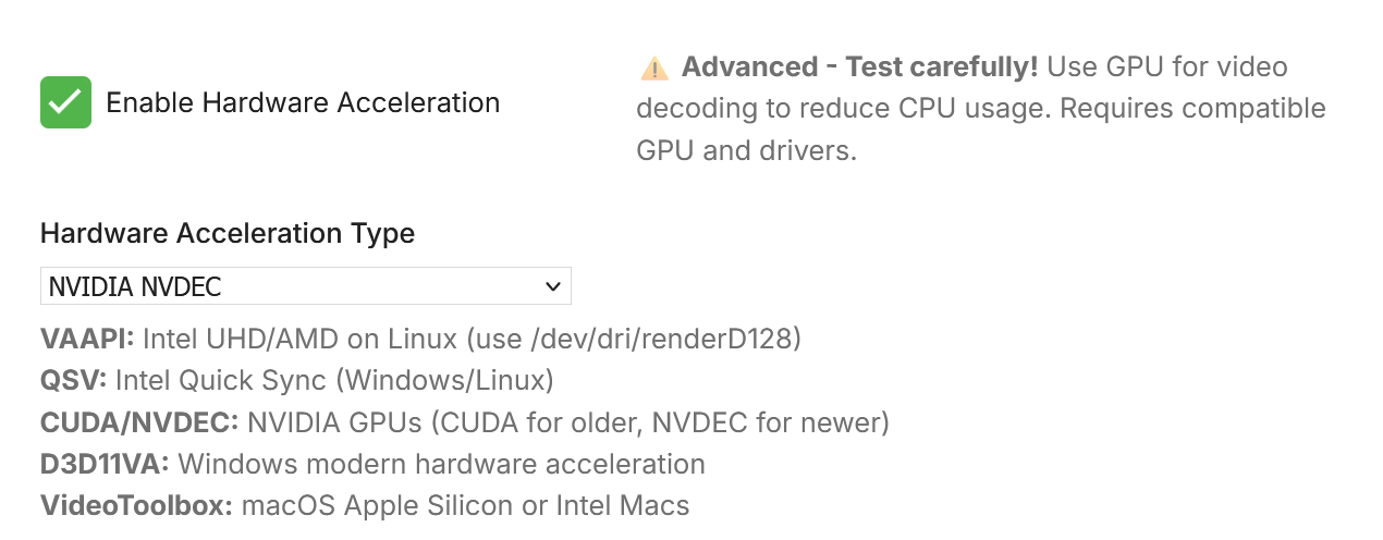

yocker 1329 Posted January 20 Author Posted January 20 (edited) Next on the todo list: Add some hardware acceleration for the image extraction. I sadly can't do anything about the tesseract as that is beyond me. Edit: Might as well reveal that i actually have been working on that for some time. Nothing worth keeping that a secret. I'm in the middle of adding settings for FFmpeg thread limits and custom commands. Should be done soon.. Ish... Edited January 20 by yocker
rechigo 367 Posted January 20 Posted January 20 33 minutes ago, yocker said: Next on the todo list: Add some hardware acceleration for the image extraction. I sadly can't do anything about the tesseract as that is beyond me. Edit: Might as well reveal that i actually have been working on that for some time. Nothing worth keeping that a secret. I'm in the middle of adding settings for FFmpeg thread limits and custom commands. Should be done soon.. Ish... Thanks for getting this out so quick! How much of the processing is actually image extraction and how much is tesseract? Like what's the split, like 60/40? I notice embyserver always uses more cpu than tesseract when processing
yocker 1329 Posted January 20 Author Posted January 20 (edited) 31 minutes ago, rechigo said: Thanks for getting this out so quick! How much of the processing is actually image extraction and how much is tesseract? Like what's the split, like 60/40? I notice embyserver always uses more cpu than tesseract when processing I haven't measured it, but the extraction takes what ever you can give it if a limit is not set. Hwaccel should help a great deal. I actually maxed out a 4090 with it Edited January 20 by yocker 1
