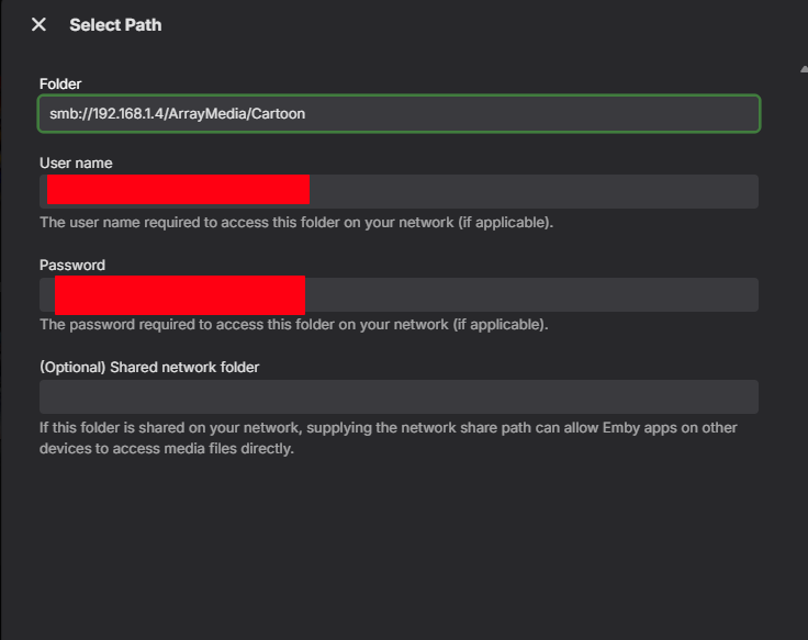

Unfortunately, not for me at least.
I test each new release and until now, I always get the same error message when the path is a Samba share..
credits-detection-debug-2026-01-05T13-04-02.log
Neminem
It seams to work for me now, just setup a test with SMB share.
  • Thanks 1
Lets try again.
As @Neminemfound out the version i gave you had a bug.
It was all reverse and smb now worked but direct didn't.
The API i used didn't work as i though.
Anyway.. Here is a version that (hopefully, this time for sure, i bet it does, it HAS to) work! ;)
EmbyCredits.dll
frankythedog
28 minutes ago, yocker said:
Lets try again.
Yes!
I can confirm that this version works with Samba shares now.
Anyway, thank you for your availability and for responding so quickly to feedback.
Now I can play around with these markers and home automation.
  • Thanks 1

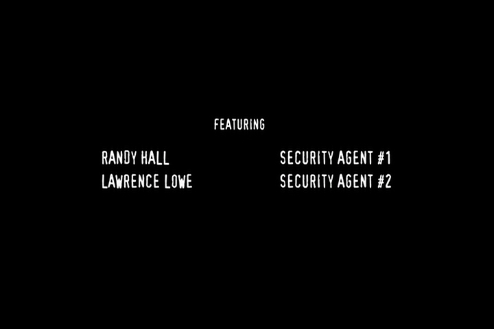

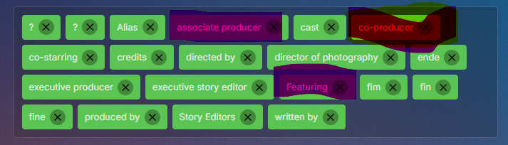

DarWun
I don't know if this is an issue with v1.3.4.0 of the plugin or just a limitation of Tesseract. But I have an  number of episode scans that are failing credit detection even though there are clearly displayed key words in the credit title cards.
Example 1 - Alias S01E12 - Frame 45:
Keyword "Featuring" is clearly displayed. What Tesseract is seeing according to the log:
Example 2 - Alias S01E12- Frame 46:
Keywords Co-Producer and Associate Producer are clearly displayed. What Tesseract is seeing according to the log:
Credit detection was successful for most of the 104 episodes in the series. There were only a handful where the OCR detection failed based on keywords not being recognized even though they are clearly visible in the frame.

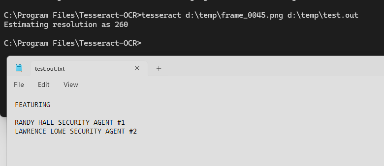

Edited to add: I used OCR extraction in the Windows snipping tool on Frame 45. This is what it detected:
FEATURING
RANDY HALL
LAWRENCE LOWE
SECURITY AGENT #1
SECURITY AGENT #2
How Tesseract is coming up with "L LU LI R T LU N3 BT IE 7 \f" for that same frame, I have no idea.
Edited by DarWun
  • Like 1
yocker

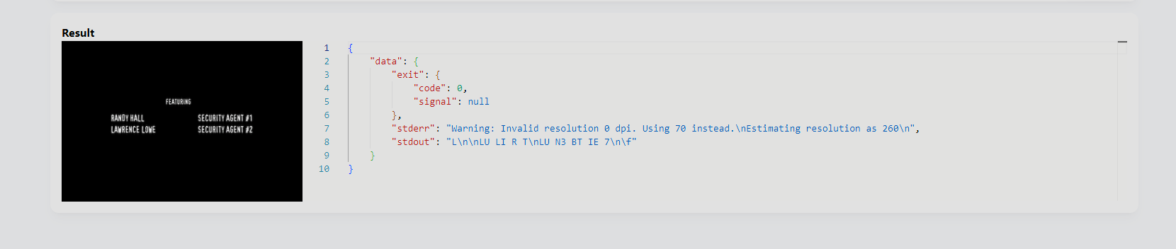

@DarWun It seems the tesseract doesn't like the fonts used in that show.
I threw the pictures you posted directly into it and it just gave a bunch of gibberish.
You can test it your self by going to http://ip-of-tesseract:8884 or what ever you configured the port to.
There you can give it single images to work with.
  • Like 1

I've done a bit of googling, and found a number of posts about Tesseract having issues with fonts with "jagged edges". The Alias end credit font may be one of those problem fonts. I found reference to python scripts for edge smoothing that are supposed to fix that issue so that Tesseract scans the text properly. I haven't found those scripts yet. I'll post back if I find anything that might be useful for improving the accuracy of the OCR for this plugin.
yocker
New version up (v1.4.0.0) on yocksers/EmbyCredits github.
Added:
  1. Notifications via Emby Webhooks. Email, PushOver, Discord and so on.
Changed:
  1. Added a few more keywords as default.
Fixed:
  1. Small bug with windows pathing for automatic detection.
  2. Bug where in rare cases extra items were put into the queue.
  • Like 2
DarWun
This is strange. As you identified, when feeding the image into Tesseract at http://ip-of-tesseract:8884 installed on my Synology NAS where Emby resides Tesseract does indeed spit out a bunch of gibberish.
But when I fed that same image into Tesseract that is installed on my PC, it was able to recognize the text without an issue.
