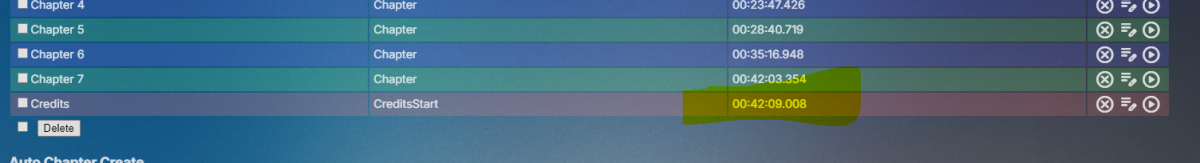

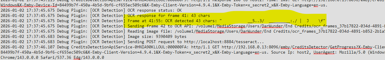

I'm still testing the density detection option that was added. But I'm seeing something in the output file that leads me to believe it may not be a good option on account of Tesseract detecting characters where there are none. Frame 41 from a scan I just completed is a scene from just before the credits start. There is zero text. But Tesseract is reporting there are 43characters in that image: "OCR detected 43 chars: "           __5..3/  _________:./ |  J    \f". I'm not entirely sure how it is coming up with that...maybe from the computer screens in the background?
Settings were set to use density detection to supplement OCR (i.e. Enable Character Density Detection "ON", Use as Primary Detection Method "OFF"). No key words were detected, so no end credits were found even though the Character density detection criteria were met. I'll rerun it with Use as Primary Detection Method set to "ON". But the fact that Tesseract is seeing characters in images without text close to the credit start point is likely going to lead to poor results.
I'm also noticing in the logs that " \f" is being appended to character strings. I think that is why every image with no text is still identified as having 4 characters.
You can try the extra options in this version and see if it helps.

yocker
Also looks like it's taking some JSON and using that to detect with.
I need to filter that.

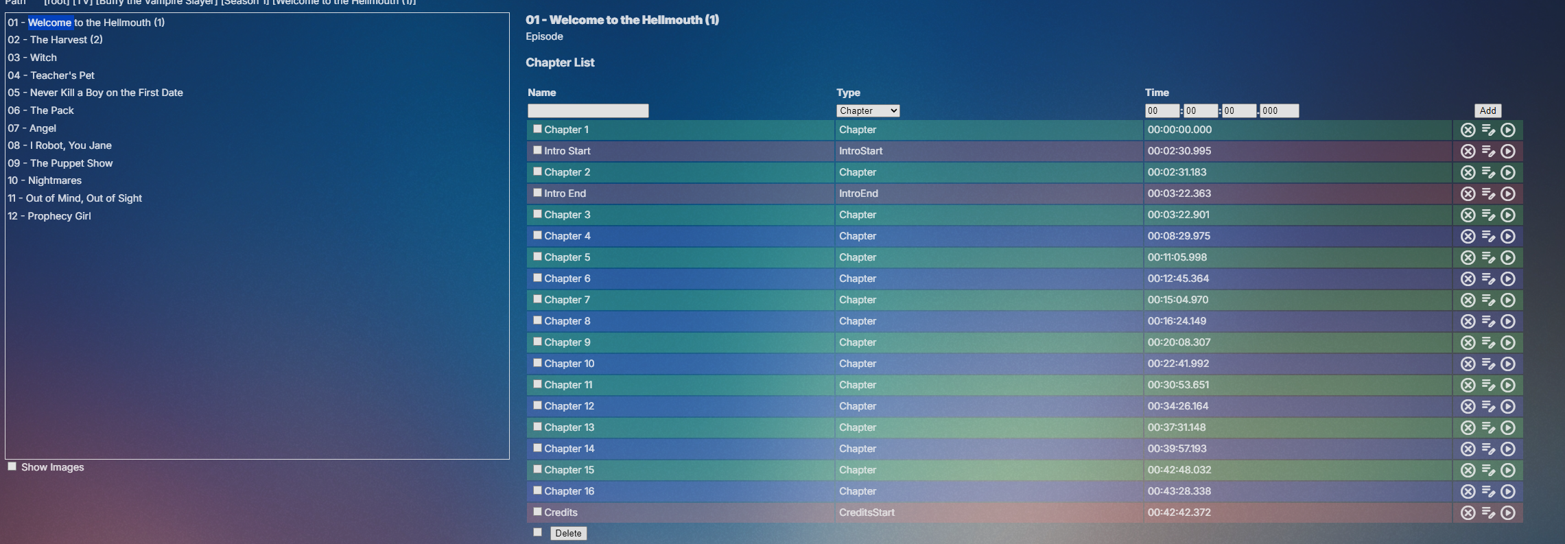

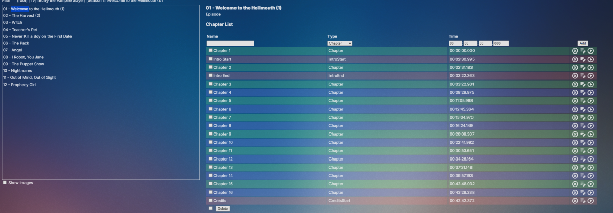

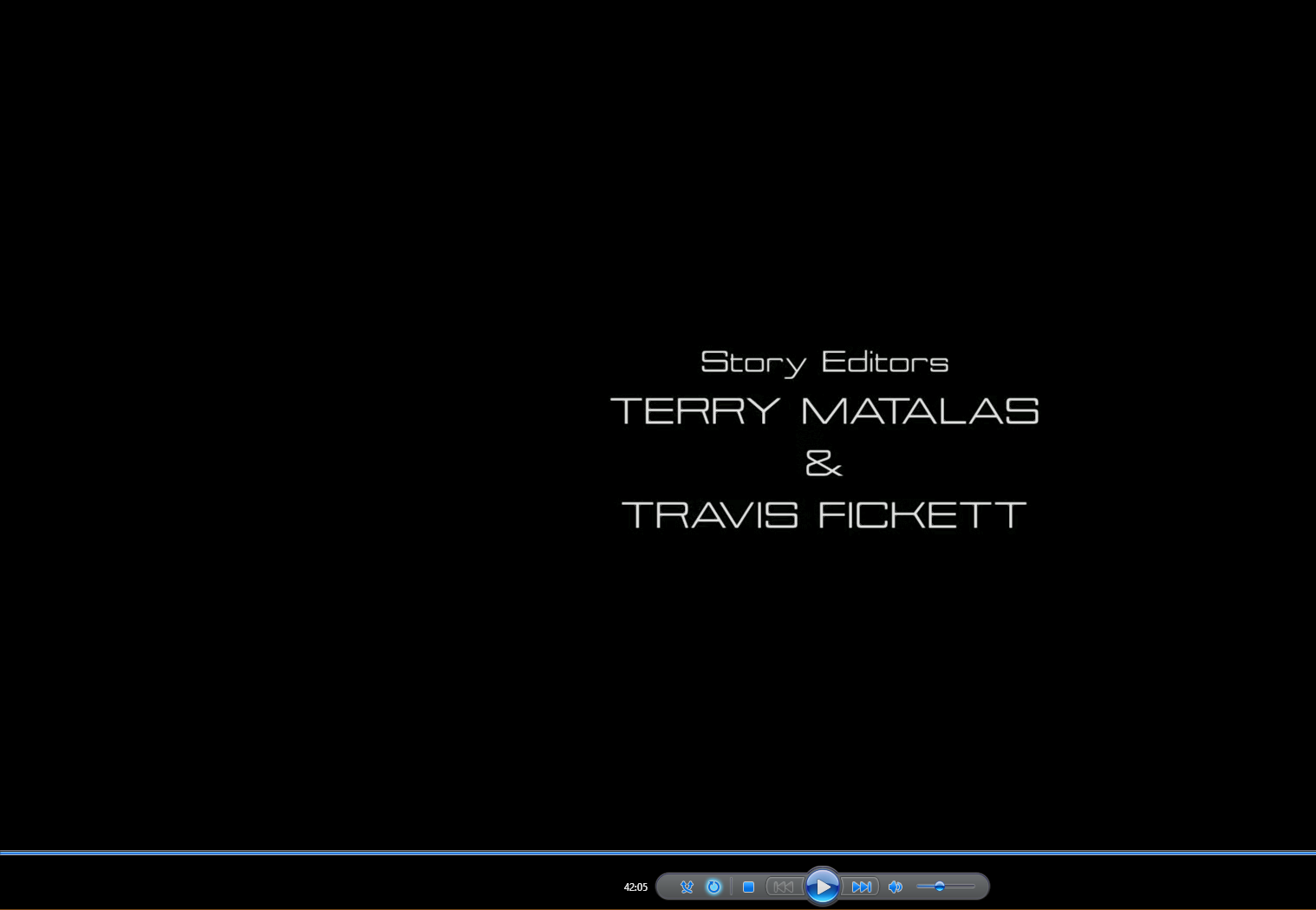

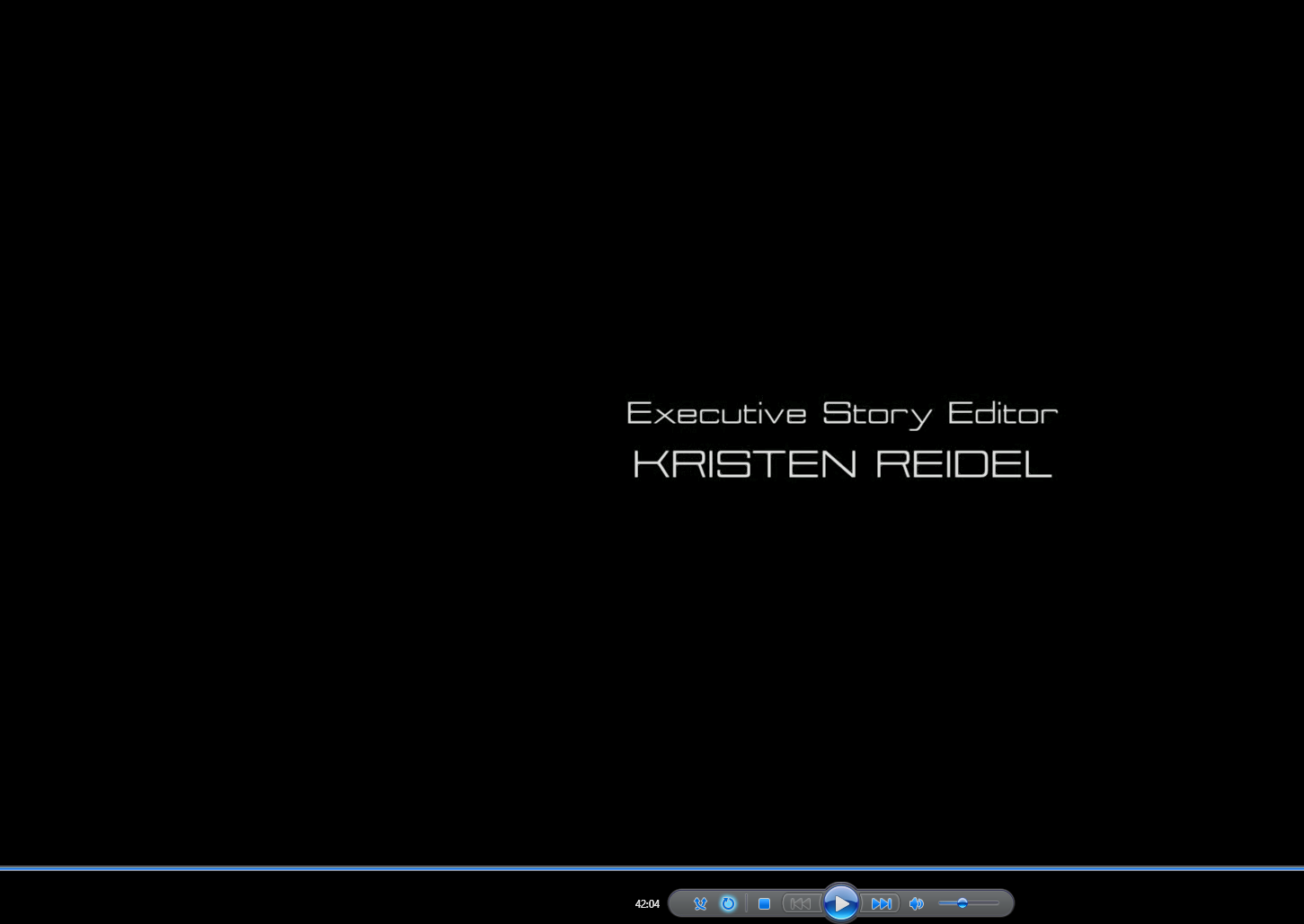

I just reran the end credit scan for this episode with "Use as Primary Detection Method" set to "ON" for character density detection. Success! End credits detected. But they are set at the time based on the final image that triggered the detection instead of the first.
End credits start at 42:04 with the following title card:
That image is not actually extracted by the plugin so tesseract does not scan it. That explains why OCR recognition of the specific words "Executive Story Editor" I manually added to the list did not work.

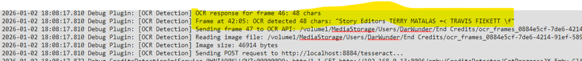

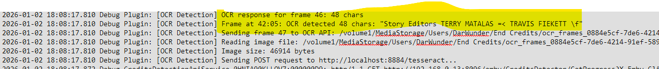

The first credit image extracted and scanned is at 42:05:Screenshot2026-01-02181935.thumb.png.4337937b006577f71aba1a93c1d58b7e.png

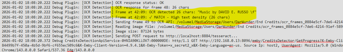

The plugin determines there are 48 characters in that image and starts the "Density Detection Countdown" clock:image.thumb.png.06eb5b8c260c7238b52206150ab56cfa.png
There are three "high density" images detected past that point, with the final being at 42:09. So the plugin concludes that credits have been detected:
The end credit marker is set at 42:09 based on the last image detected.
Shouldn't it actually be set at 42:05 which was the first image detected in the credit sequence?
Full log attached.

yocker
Depends on the confidence.
I will add the filter though so it doesn't try and detect some of the info i send it plus what looks like "white spaces"
Edited by yocker

yocker
@DarWunThis version should filter that text and white spaces.
EmbyCredits.dll
