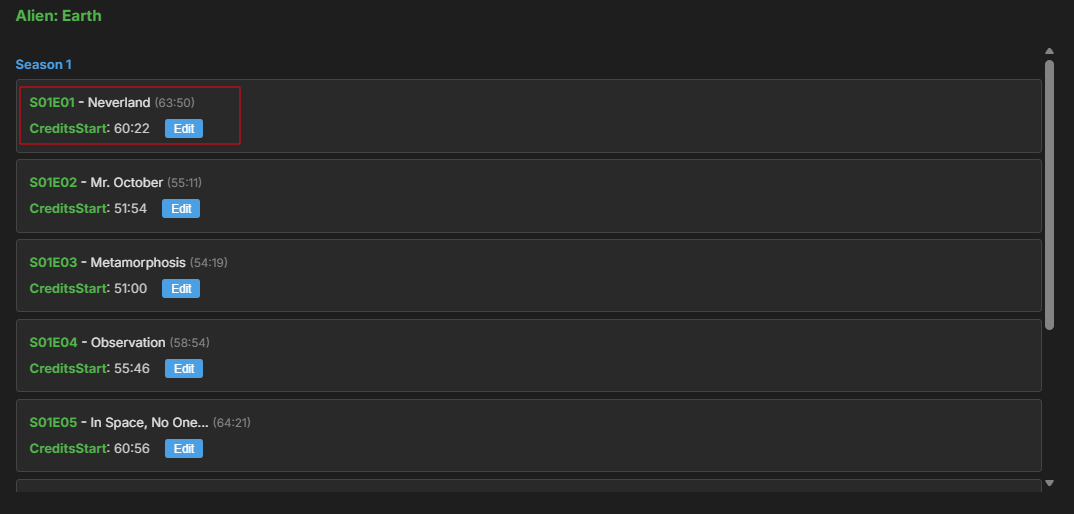

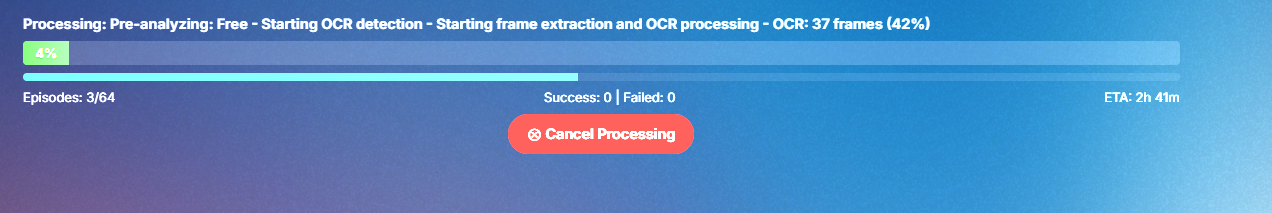

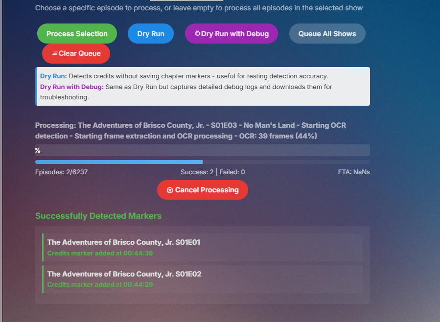

Thanks for the latest update @yocker. I stopped the previous scan to install the new version. It had been running for about 18hours and was only about 6% complete, so I didn't lose much. One thing I noticed with v1.1.9.0 is that it no longer provides a live update of failed/successful credit detection like the previous version did.
Three out of 64 episodes have been scanned. But there is no indication as to whether or not end credits have been detected. In the previous version the plugin was providing realtime updates.
Was the live update of success/failure removed in v1.1.9.0?
Edited by DarWun

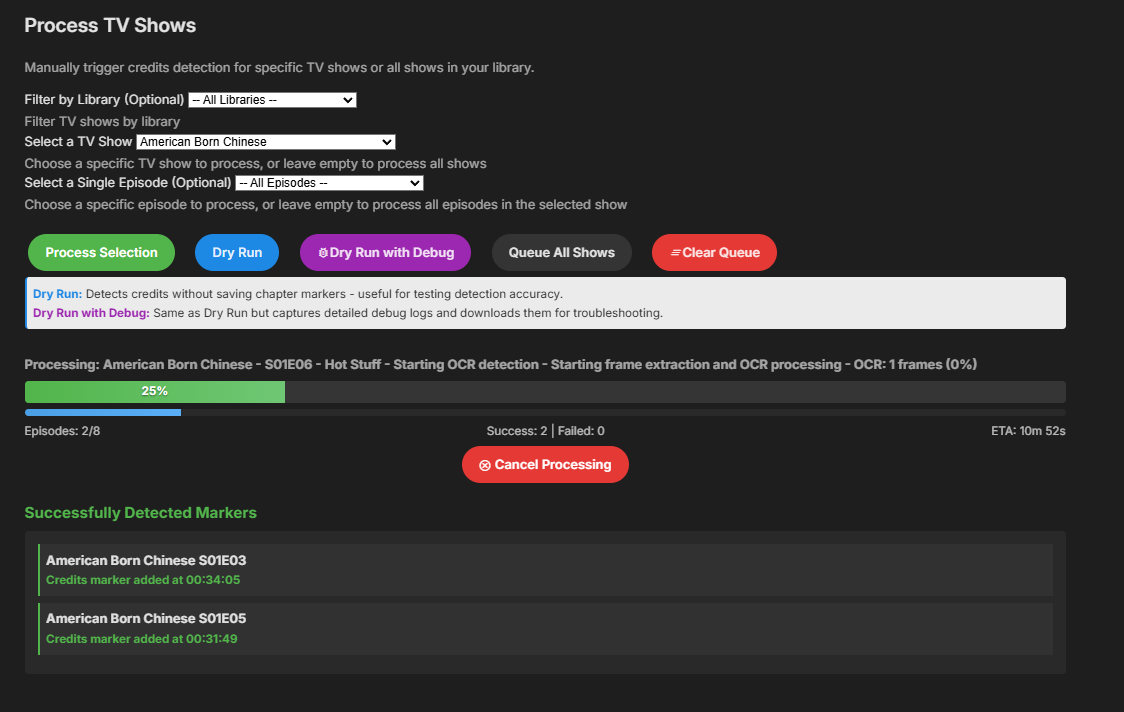

I figured it out. The live update of success failure still occurs for a full scan started as a scheduled task. It does not occur if a manual scan is started for a single series.
Are there plans to provide live updates for manual scans of individual series?
It should work.
Try and clear the browser cache.
If that doesn't work please start a dry run with debug on a small series and send me the log.
I will see if i have time to look into it before all the festivities start. :)
Edited by yocker

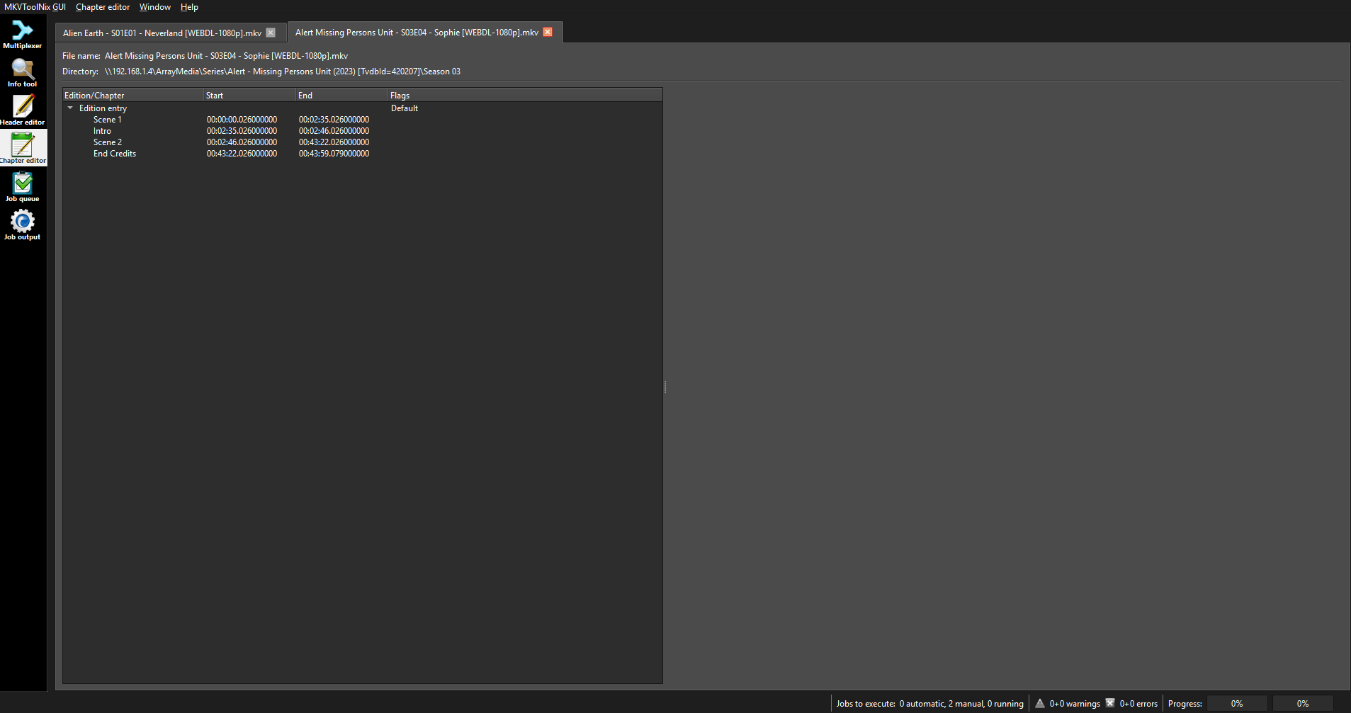

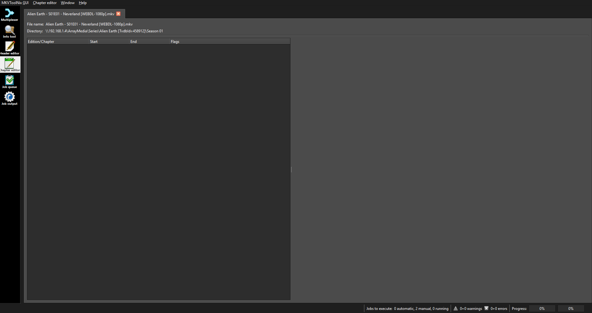

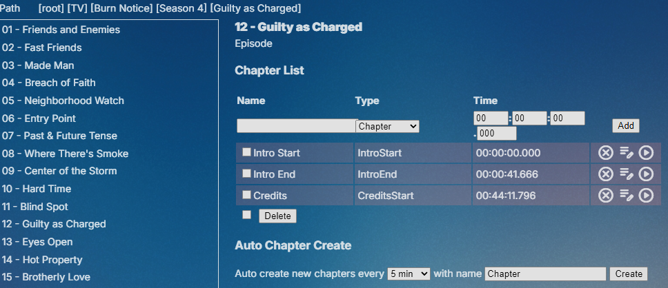

Your plugin does it indeed create a chapter named "Credits" as I can verify in MKVToolNix GUI tool.
But none of my Emby clients seem to care about this.
I then installed the chapter API plugin and loaded one of the culprit episodes.
What I found out was that the episode "fixed" by the EmbyCredits plugin did not have the correct Type set (see image nr 2).
The name does not seem to matter though. But the type needs to be "CreditsStart".
I think this is written to the internal DB of Emby and not written to the MKV file itself.

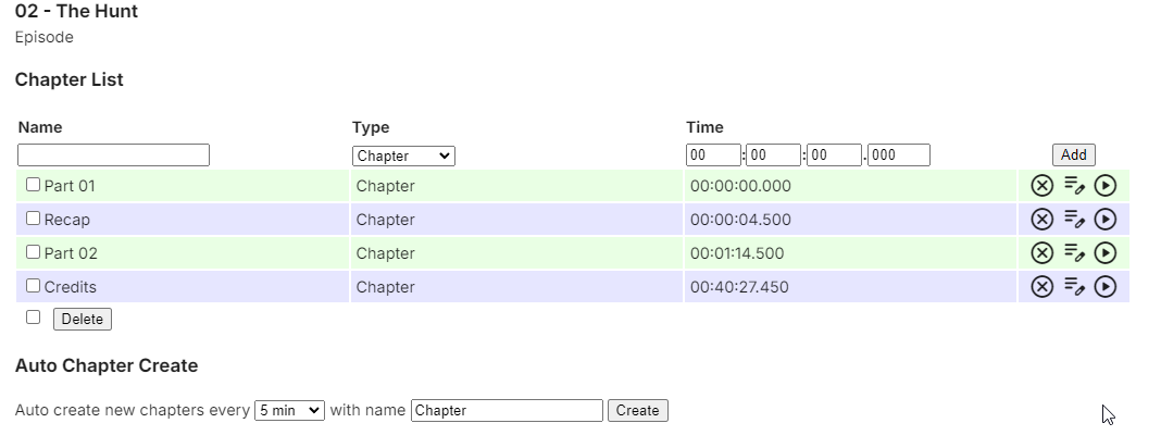

This working example here renders the "next episode" button in the OSD correctly.
I manually deleted the chapter created by your tool.
Then manually created a new one called AnyName with type "CreditsStart" (rendered in red). Presto it worked.
This example here does not render the "next episode" button in the OSD. This is from an episode fixed by your EmbyCredits plugin.
As you can see the Type is merely set as "Chapter" (green).
So. Am I missing something here or does your tool need to take this into account also ?
As far as I know the plugin does not write to your media files, only to Library.db.
So what ever you see in the file using MKVToolNix was already there, before using the plugin.
Example.
Here is a episode I have not processed with this plugin.
Those are in the MKV file with out involvement by this Plugin.
  • Thanks 1

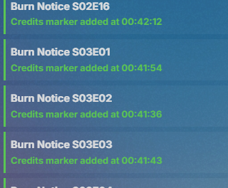

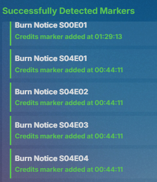

I have found an issue with the series averaging methodology for setting the end credit start marker. Episodes of Burn Notice in my library are around 43 to 44minutes long. For the first three seasons, end credit marker start times varied and appeared reasonable.
Then starting with Season 4, no end credits were detected in the OCR scans. This is not surprising, as the end credits were missing from most of the Season 4 episodes in my library. Based on the average time where the end credit marker was set for the prior three seasons, the plugin set the end credit marker at 44:11.
The problem is 44:11 is past the end of the episode as most episodes in Season 4 are only 42minutes long. The average time where end credits started for the prior three seasons based on 23-26 episodes where the end credit scan was successful is actually around 42minutes. But there was one, 1.5hour long movie where the end credits started at 1:29:13. Factoring that in, the average end credit start is around 44minutes. So I understand why the plugin used that time to set the end credit marker. However, the plugin should probably check the length of the episode before doing so. If the episode length is less than the average the plugin has determined, then the end credit marker should not be set.
embyserver.txt
Edited by DarWun
