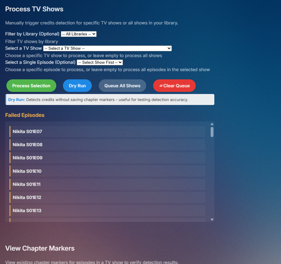

gibman 4 Posted December 29, 2025 Posted December 29, 2025 been running 1.1.4.0 + "yock1/embycreditocr" It seems to run for several days on my series collection. around 60 episodes. mins from end: 4 FPS: 0.75 It would be nice if it kept track of those episodes that did not yield a successful marker detection. No reason to try and re-process them again and again. Only if the user would change any of the plugin settings then it should reconsider all old failed episodes again. Other than that it seems to be pretty solid here Great work.

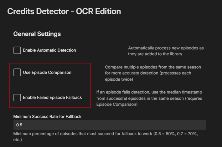

Neminem 1580 Posted December 29, 2025 Posted December 29, 2025 @gibmancan you try a dry run with debug enabled. And disable these, remember to push save. After that supply debugging logs. 1
Neminem 1580 Posted December 29, 2025 Posted December 29, 2025 After that do the same thing with these enabled. And supply debugging logs. 1
yocker 1329 Posted December 29, 2025 Author Posted December 29, 2025 2 hours ago, gibman said: been running 1.1.4.0 + "yock1/embycreditocr" It seems to run for several days on my series collection. around 60 episodes. mins from end: 4 FPS: 0.75 It would be nice if it kept track of those episodes that did not yield a successful marker detection. No reason to try and re-process them again and again. Only if the user would change any of the plugin settings then it should reconsider all old failed episodes again. Other than that it seems to be pretty solid here Great work. It shows a little log window of failed episodes just like with the successful once.
yocker 1329 Posted December 29, 2025 Author Posted December 29, 2025 (edited) 1 hour ago, gibman said: Btw. Is the OCR word(s) defined in the plugin settings a contains or an exact comparison? I guess it's case insensitive though. This could be more clear in the description of the plugin settings. Maybe you could improve the algorithm it by looking at any available .srt subtitle files. Then maybe start scanning after the last subtitle rendered? I guess this can easily fail as well for those subtitles that contains some dummy message at the very end. But this could be remedied by some setting that prevents considering last minute subtitles. Another approach to maybe make the algorithm more fool proof or faster could be to look at the OCR images in reverse order. The words are case insensitive. I will add that to the description in the next version. Using srt files as you suggested sadly won't work, in many srt files the writer of the subtitles and other stuff often shows up later as you mentioned your self. The lastest version (version 1.1.5.0) of the plugin streams the images right as they are extracted instead of extracting all images and send sending them. This makes it a lot faster. Tested the whole season of Cyberpunk in under 20 seconds for me. Making it look at reverse order could work but it would most likely end up with the same result as instead of the first 2 matches (by default) it would just have to look for the last one. That could actually make it slower in some cases. As the OCR is rather precise in the detection of words, if you want it to be faster i suggest you try setting it to only look for one word, disable episode comparison and episode fallback. I use that my self and it is very fast with the detection that way. You can also press the "reset to default" button and then save, those are my recommended settings that work best for me. Best advice i can give if it fails some detections is to add some more keyboard to look for. I have added the once i could think off but i bet more could be added. Many thanks for the suggestions, i appreciate all suggestions a lot!! Edit: I forgot. If you have any problems please do as Neminem suggested and do a dry run with debugging and send the log. Edited December 29, 2025 by yocker 1
gibman 4 Posted December 29, 2025 Posted December 29, 2025 1 hour ago, yocker said: It shows a little log window of failed episodes just like with the successful once. Yeah I saw that. Quite useful. But what do you think of my suggestion in my previous post ? Keeping track of failed episodes and avoid re-processing those in the future unless the user forces it by clicking on some button in the plugin. Or if a setting in the plugin has changed then one could seem it would be a good thing to try and re process old failed episodes. 1
yocker 1329 Posted December 29, 2025 Author Posted December 29, 2025 1 minute ago, gibman said: Yeah I saw that. Quite useful. But what do you think of my suggestion in my previous post ? Keeping track of failed episodes and avoid re-processing those in the future unless the user forces it by clicking on some button in the plugin. Or if a setting in the plugin has changed then one could seem it would be a good thing to try and re process old failed episodes. Sorry i misunderstood you. Not a bad idea, i have to think of some user friendly way of implementing it. I will look into it as soon as i come up with a good way of having it work for people. Many thanks for the suggestion, for sure one i will look into! 1 1
