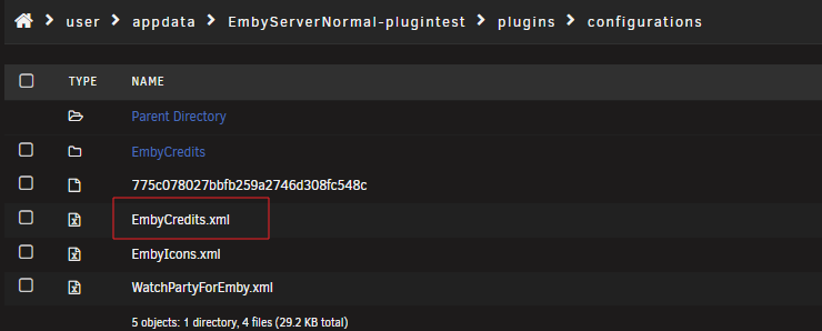

Neminem 1994 Posted April 28 Posted April 28 (edited) In you experience this can happen. 1) you have manually installed the plugin. 2) or went back a version. What is usually fixing it for me is. 1) delete the dll in the plugin folder. 2) install again from plugin catalog. Until now I have not lost my settings, since they are all in this EmbyCredits.xml file. But I also play around with a lot of different version of this plugin to test Edited April 28 by Neminem 1

popy 77 Posted April 28 Posted April 28 45 minutes ago, Neminem said: In you experience this can happen. 1) you have manually installed the plugin. 2) or went back a version. What is usually fixing it for me is. 1) delete the dll in the plugin folder. 2) install again from plugin catalog. Until now I have not lost my settings, since they are all in this EmbyCredits.xml file. But I also play around with a lot of different version of this plugin to test thx for the hint. Have now followed your instructions and deleted the dll, restarted emby and instaled it again from the catalog. We will see on next published update if it will work 35 minutes ago, Neminem said: Also the Catalog implementation is like 2 weeks old. Some bugs might happen Yeah, i can live with that
